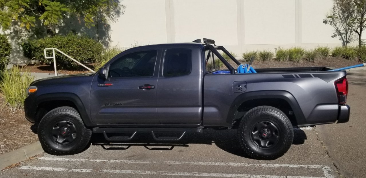

    Exactly it is cosmetic and functional. It holds light bar as intended. It was something I had in my head to build and I just had to do it. I get many compliments and happy with the results. It was fun to make it.

    Can we get some more pictures and angles? I was going to build a headache rack out of 1.25 steel pipe and never got around to it.. the pipe bender I have access to is terrible.
    PVC is kind of hilarious and awesome. More pics!

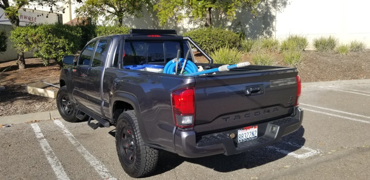

    Sure here ya go. All you need is 6 45 degree elbows and 2 inch PVC. And it locks in place using bed rail system.20210114_140504.jpg 20210114_140504.jpg 20210114_140510.jpg

    It is very strong locked in place no vibration or movement

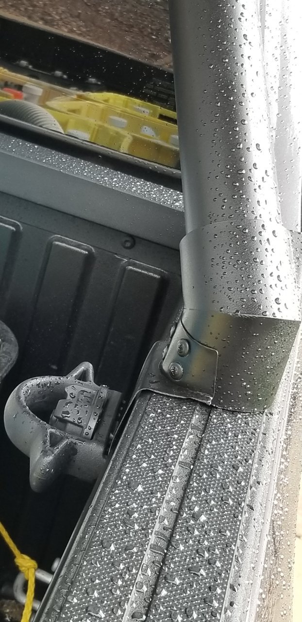

    So what is the bracket you are using to attach it to the bed rail? Custom made or store bought? Pictures please. TIA

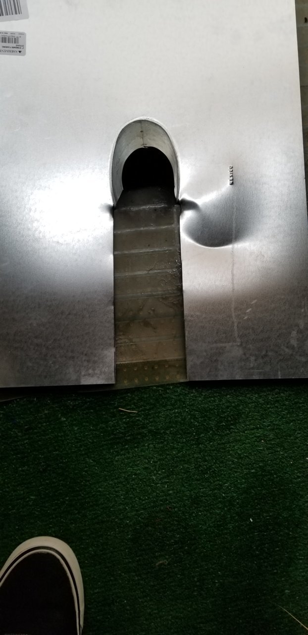

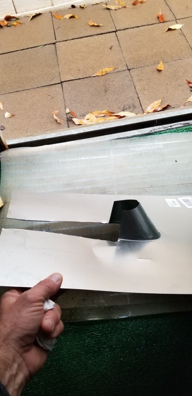

    So as you can see I made 2 brackets out of flashing that is screwed into PVC. Than I have the bracket I made to be mounted with the bed rail bracket. To remove just remove both bedrail brackets and my light bar wiring I soldered 2 male to female connections so it can just be unplugged if I want to remove it. The PVC that is up against the rubber window molding mounted with 2 layers of 10lb double sided mounting foam. No vibrations no movement. 20210123_130946.jpg 20210123_131018.jpg 20210123_131120.jpg 20210123_131129.jpg

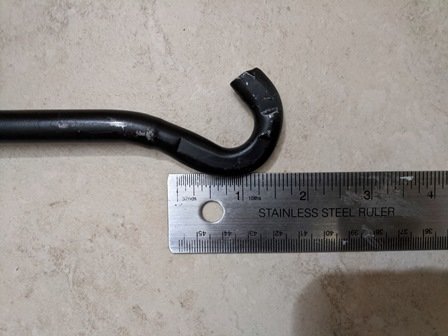

    @Mandy3206 Hope you are still out there! Does the end of the stock rod that engages the elevator/winch fit through the 1 1/2" pipe (If that is what you use to engage the elevator/winch.).
