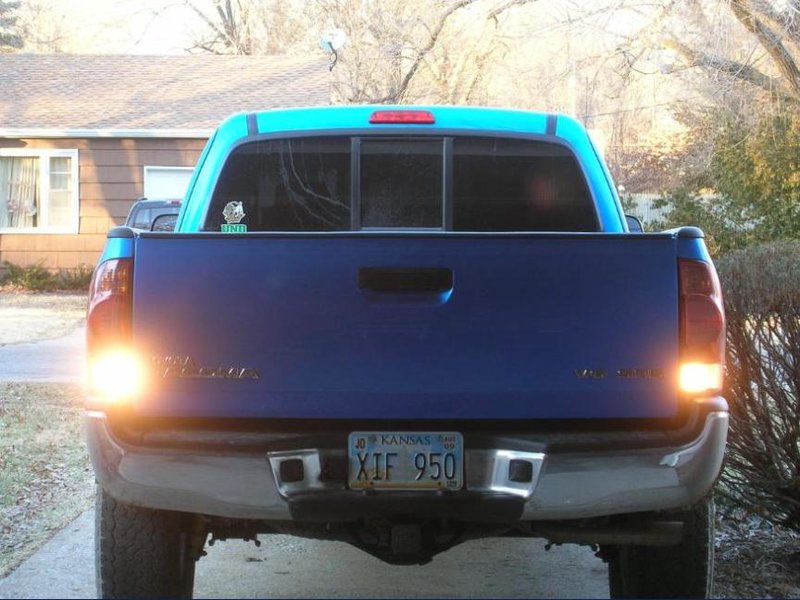

    I keep meaning to try this - NICE PICS! :thumbsup:
    Does anyone have a problem with these falling out of the socket?

    007Tacoma, sorry I missed the question.
    It isn't plug-n-play (As if anything really is!) as the original post laid out, but it's easy enough.
    I was not able to get them to hold to my satisfaction by just cutting them out of the socket. I actually did each one a wee bit different. The first, I bent the flat portion left 180° over it's self to mimic the original 921/192 bulb. The second one broke the flat metal from the round wire portion and I had to bend the round wire around. I hope that makes sense. If you didn't mind deforming the original socket, you could narrow the holding contacts to match the flat blade portion. Don't worry about touching the bulb. You're going to properly clean them off with isopropyl alcohol anyway, right!
    And FWIW...I saw the same bulb in the light bulb section at Home Depot without the plastic base. This would avoid cutting. They were $3.99; available in 50w and 75w.

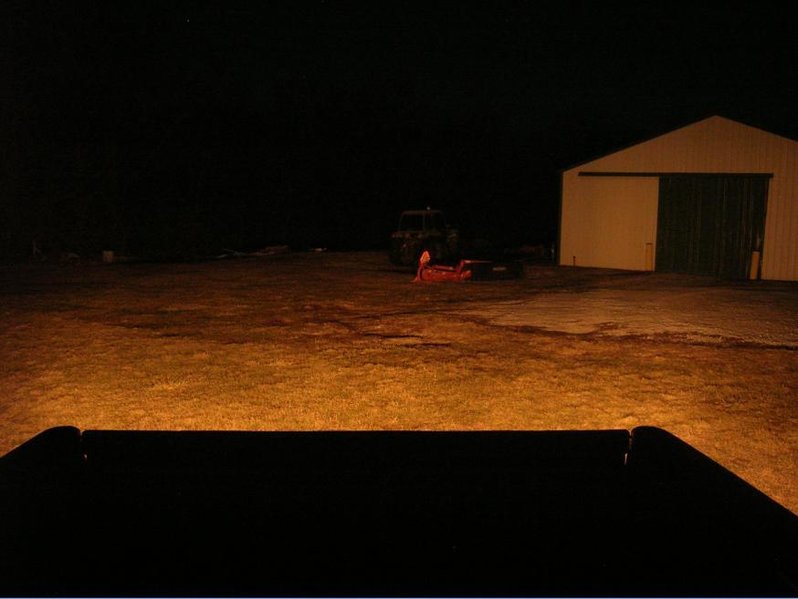

    Fog light mod
    I wired the mod this weekend. I don't know if it looks bad ass, but I do know that it will work as it should in snowy, foggy conditions like it should have in the first place. good and easy.
