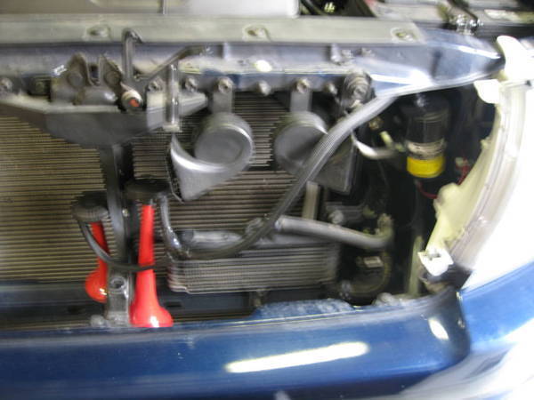

    Here are a couple photos of my installation of $9.99 Harbor Freight Dual Air Horns. I did not need to drill any additional holes because I used existing holes.
    Here's blurry a picture of the horn and compressor. My camera was accidentaly set on manual mode...

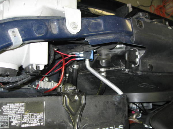

    Here's a picture of the relay. It's mounted just behind the drivers headlight.

    but how do they sound?

    The sound is definitely loud. The dogs were in a panic when I was testing them out. The pitch is a little high for my taste though. But for the price, I am happy enough to keep it this way until I find something better.

    i want to hear the panic not read of the panic!!!!!!!!!!!!!!
    let there be sound!!!!!!!!!!!!!!!!!!!
    sound
    sound
    sound
    sound
    sound,...ok im done can you post a video of the horns in action and did you sub the horns for the stock? or did you run a different button for them.

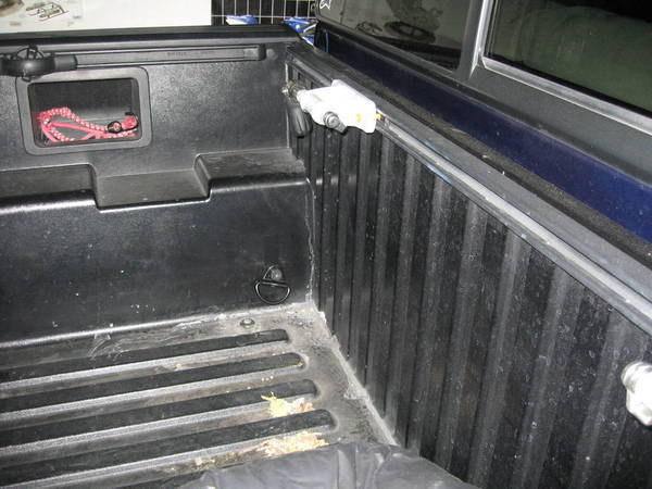

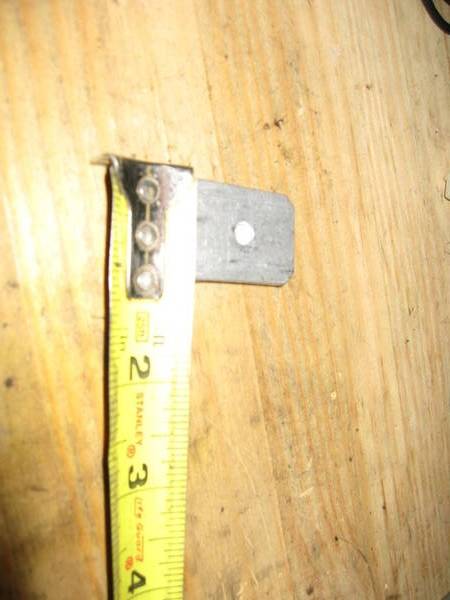

    These rectangular nuts fit in the upper left, right or forward tracks. They can be used to mount anything. They are 1.5" X 1" X .25" in size. Threaded with 1/4-20 in the center. The material in the pictures are aluminum (prototypes). I ended up making the final ones from steel bar stock picked up at Orchard supply. I scribed the length on the bar and simply cut it with a hack saw to 1.5" long pieces. Before I cut them to length I put the holes and tapped them. I also spray painted them black to prevent rust. I used them to mount my bike fork mounts. There are two used on each bike fork mount. You can also see I installed the Toyota D-Rings in the forward corner of the bed. I followed the the Toyota instructions in this case; they are mounted on the wheelwells not the floor.
