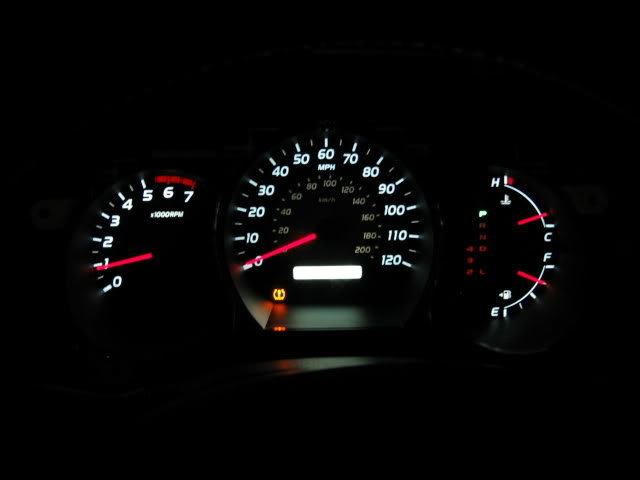

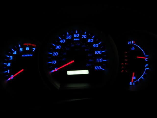

    Does anyone know how or seen how to do a dash board color change, orange(oem) to blue or white or a combination of the two? It basically is the cost of the LEDs if you do the work yourself so it would be a cheap mod.
    Blue Dash
    White Dash
