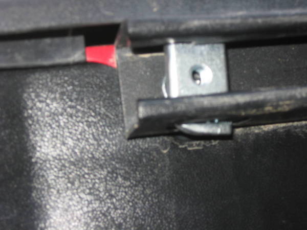

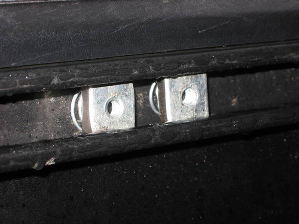

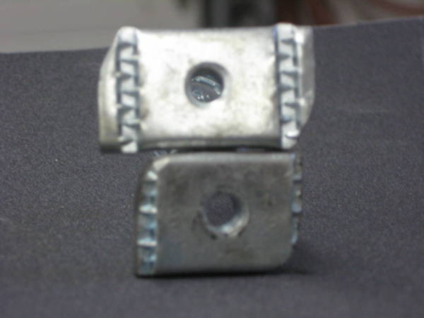

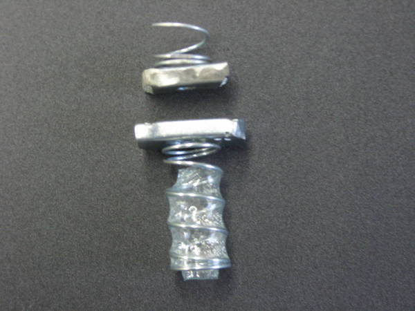

    This Is a springnut:
    It is designed to be installed into unistrut (an 1 5/8" rail similar to the one on the back of our trucks)
    Because the springnut is slightly larger than the rail on our trucks, It does not fit, except where the rail is bolted to the box. (as shown in photo)
    The springnut can be modified to fit anywhere with some minor grinding, you need to be careful to keep close to the same shape, as the rounded corner allows you to simply insert the springnut where you want it, then turn it in place, if the nut was square, it would have to be inserted in one end and slid to where you want it.
    The spring should also be shortened, to make it easier to insert into the rail.
    It took me about 15 min with a bench grinder to make 2, so it is a fairly quick process to make them. Springnuts sell for anywhere from 75cents to a two bucks, you can also get stainless ones. The holes on them come in a range of sizes from 1/4" to 3/4" and they can be purchased at most electrical suppliers, or parts warehouses. they are made by T&B, Unistrut, and Hilti. Here is a link to buy them, and to give an idea of price
