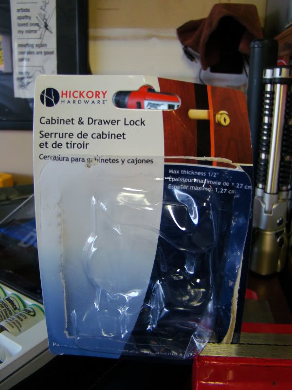

    First was to install a lock on my center storage compartment. The lock cost me $4.00 at Lowes. The lock works very well for what it's needed for. I go to a casino and they offer free Valet Parking. This will prevent these punks from peaking into my storage compartment to see what they can grab. It's happened before and I lost a few CD's!
    On with the pics...
    Lock - There was 2 options. 1/2" or 1/4" max thickness. The 1/2" was the perfect size.

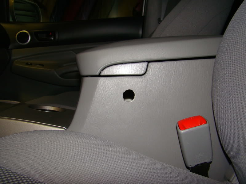

    The locks requires a 3/4" hole. I first started with a pilot hole all the way up to a 1/2" hole using a drill then did the remainder with a Dremel. Not perfect but the lock fit fine and will be eventually covered with the lock.

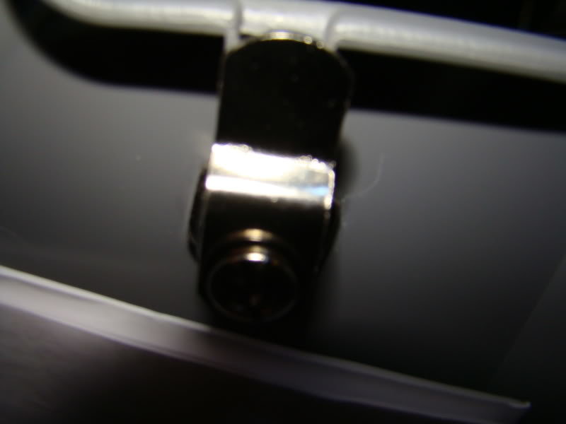

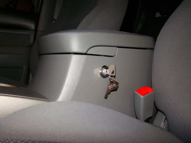

    Installed the lock using the "bent" latch. Works perfect.
    Blurry pic but best I could do...The "bent" latch worked the best.

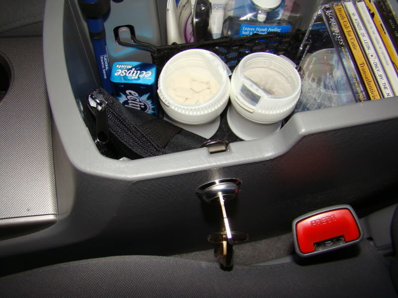

    The latch needs to fit flush against the lip of the storage compartment. Protect your hand sanitizer and lube!
    So I did this back in April and have actually used the lock several times. It is holding up very well and still works perfect.

    Great idea! Do you have a dimension down from the lip for the center of the hole?
