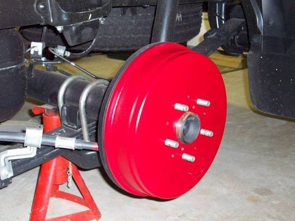

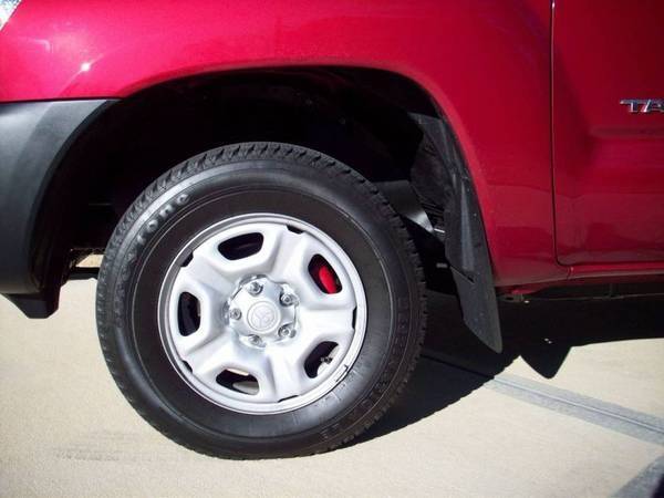

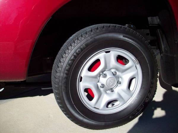

    The rear drums come factory black and the rotors up front silver. Both noticable through the rims. Removing the rear tires also shows signs of rust on the outside of the drums due to the factory not coating the complete drum black - leaving rust stains on my garage floor.
    I pulled both rear drums off and cleaned/sanded them and painted them with a top quality heat resistant paint. I masked/papered off the front rotors and cleaned/lightly scuffed them and painted them as well.
    My truck is impulse pearl red so I chose a red that closely matches my paint and now with the wheels on looks sportier. Total cost $8 and 1 hr. (30 minutes if you leave the beer breaks till completion :drunk:)
    I'm on a trip away from home and will post some pics when I return.
    My opinion, but think it looks better than silver calipers and black rear brake hub. Now I cann't wait to get my new rims and tires!

    Let us know how that holds up! I did it to my Corolla and the paint seemed to bond the wheels to the rotors and drums so they were a PITA to get back off. I could see imprints in the paint where the wheels hit. May have been the rust, may have been the paint. I'm not sure, but it took a sledge hammer to break them loose. Luckily they were steelies. Maybe I didn't let the paint dry enough.
