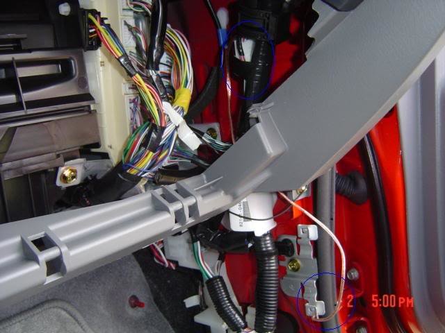

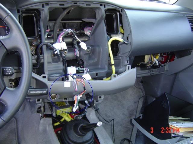

    from It involves a little more tear down than i think is necessary but if anyone wants to do it and make a proper how to thread that can be stickied feel free and I'll delete this post.
    This is from the stand point of a 6 speed. Of Course-----DO THIS AT YOUR OWN RISK
    1) First you have to open the center console. Remove the bottom, it prys right up. There will be 2 10mm bolts to remove in the bottom.
    2) Remove the cup holder (pry it up with a small screwdriver.
    3) Unscrew the 4 black philips head screws that were hidden under the cupholder. Now you can slide the center console back. It should unattach from the front half of the center console.
    4) Remove the shift knob.
    5) Slide the front half of the center console back it will slide straight back and out of the way.
    6) Remove the cover under the E-Brake handle.
    7) Remove the glovebox.
    8) Remove the two plastic screws above the gauge cluster. Pull the gauge cluster out on the right side (by the stereo).
    9) Take a small flat head and remove the A/C Heater contols. Disconnect the cables from the back.
    10) Remove the 4 10mm bolts under the stereo and pull the stereo out. (remove the cables.
    11) Pull the piece surrounding the stereo out. You will have to finagle it out from under the gauge cluster piece.
    12) Under the right side cigarette lighter there is a 10mm bolt. Remove it. Now you can pull the lower facia of the dash (the piece that holds the cigarette lighers out enough to get you had back behind it and remove the cable from the TPMS ECU.
    This pic shows everything to this point. Sorry, I didn't take pics along the way.
    This pic is the small hole that is behind the heater controls. You can look down through it and see the TPMS ECU. The plug plugs into the bottom of it.
    Now that the cable is unplugged, You can put it all back together except the glove box.

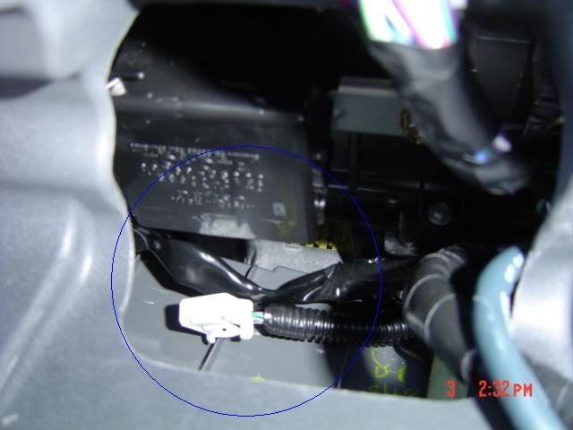

    13) In the top upper right corner of the glovebox area is a white connector on the outside of a wire lomb. The blue wire (pin4) is the Indicator wire for the TPMS LED.
    14) I took speaker wire and striped it and wound it really tight. I shoved the wire into the back of the connector (blue wire pin4), and taped it in place.
    15) Find a ground point and ground the other side of the wire to ground. This biases the LED so that is will not turn on.
    Here is a pic. I grounded it to the bolt that holds the bracket for the passanger kick panel.
    Thanks

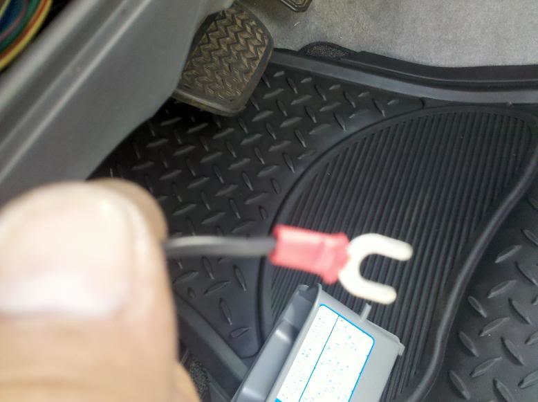

    If you install a converter in the cab (or in a sealed box in the bed) and run wire to an outlet yes. Maybe if you find/order the factory outlet you could do that, or install your own outlet/box somewhere. The factory route is too much of a pain. I don't know if you can order the factory inverter, and it's tied into too many other systems to deal with (and that limit it's usefulness anyway).

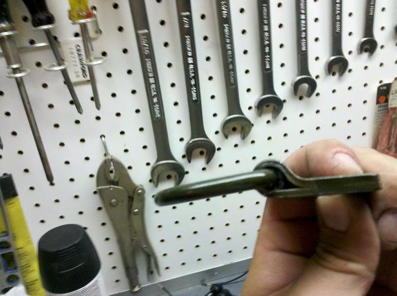

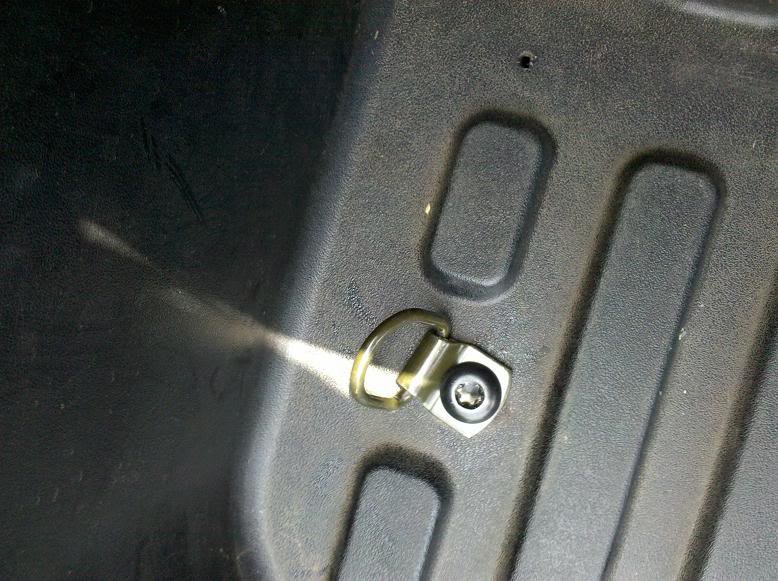

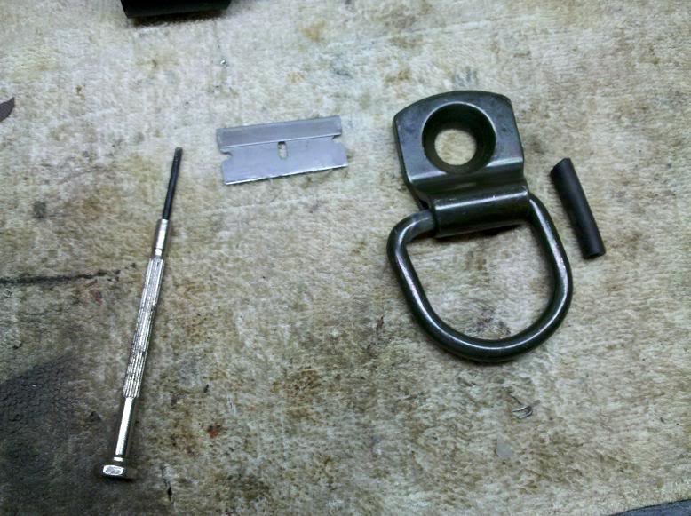

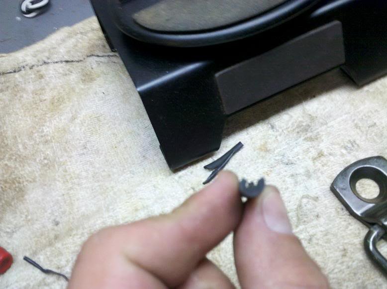

    Very easy way to make the military d-rings quiet. Super simple. Cut a piece of vacuum line (cut half way through) and put it through the d-ring and the mount. Keep cutting pieces and putting them through till you get the ring as tight as you'd like it.
    installed

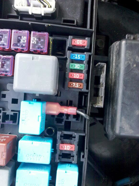

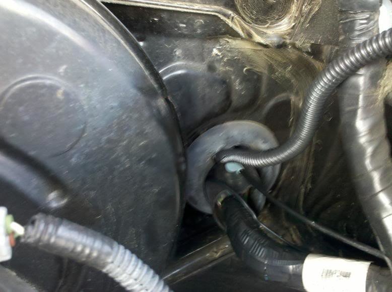

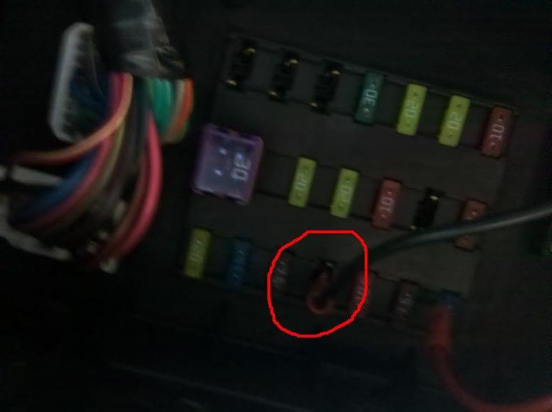

    I've seen lots of people doing the anytime fogs. I like the idea but didn't want the fogs on with just the ignition. So here is a way to wire them so they come on with your parking lights.
    First (just like the other way) bend the tab and connet a wire to the relay.
    Run the wire through the firewall main harness gromet.
    it will connect to a empty spot on the fusebox and here is the connector to use
    here is where it connects too that is only "hot" with the parking light on
    sorry, pic is upside downIMG_20100722_155306_9700bde7bd5a3d520fa2d55ef1dc49c12e821d56.jpg
