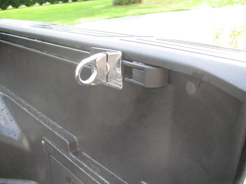

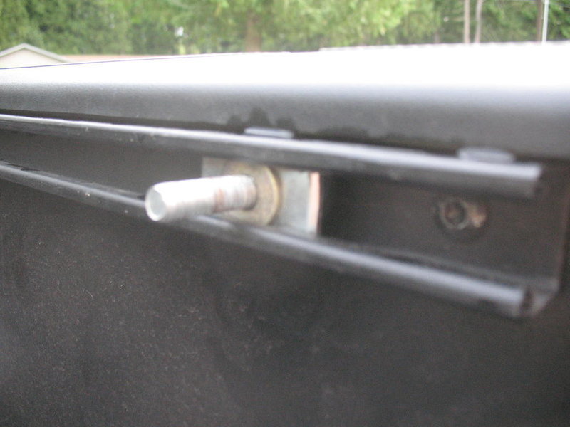

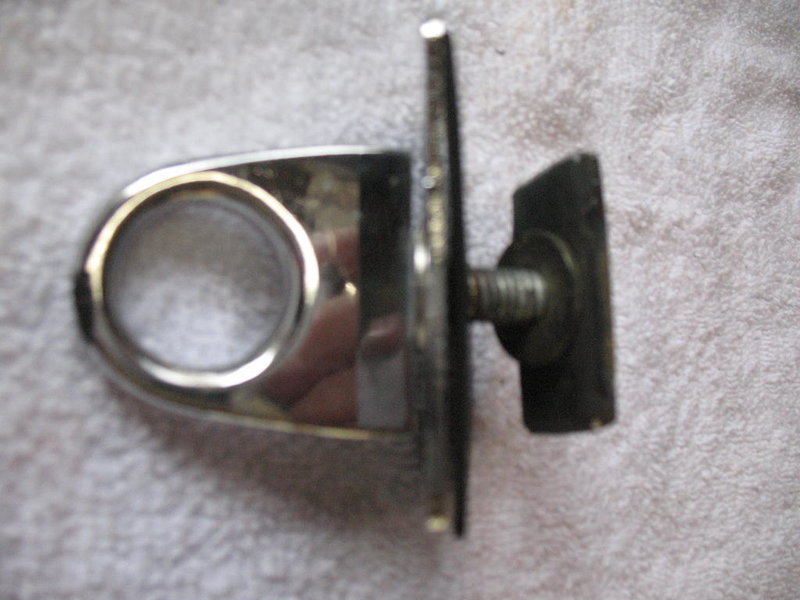

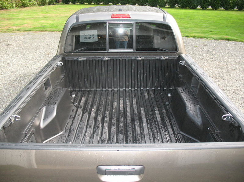

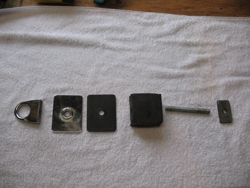

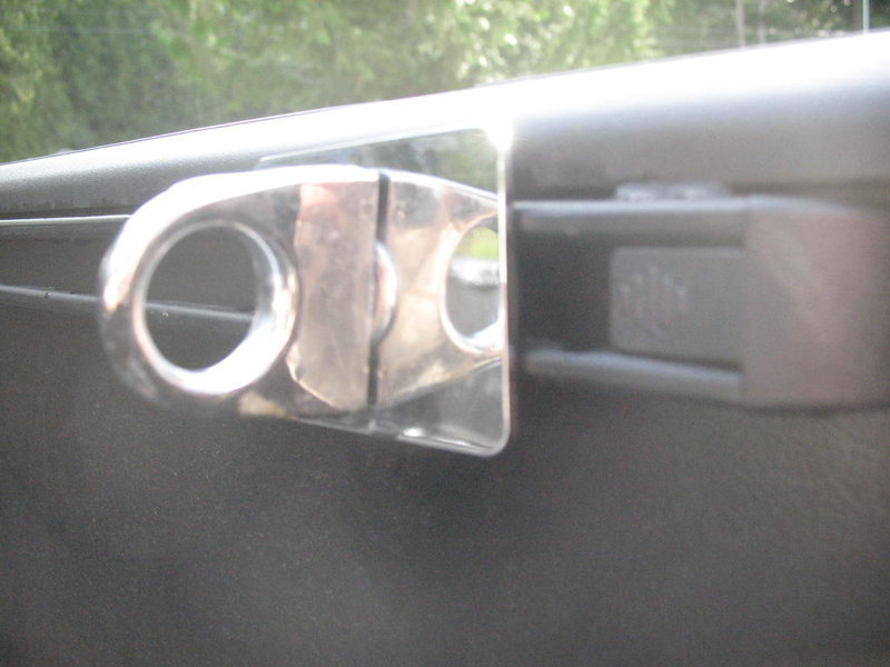

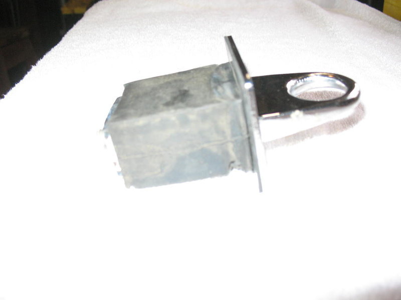

    Thought I would share my Tie Down Mod. The end result is a tie down that adjusts or removes without any tools. Here is the final install pic.
    I used some old stake pocket compression tie downs from my last truck.
    The tie downs consisted of a female threaded ring, a compression plate, rubber gasket, rubber compression block, threaded backing plate, all connected with a peice of threaded rod. These can be found at most auto parts stores fairly cheap.
    I cut down the backing plate to 1 inch width to fit insiide the bed rails. I cut the threaded rod down to 1 1/2 inch. reassembled with out the rubber block and added a 7/8 inch diameter washer between the backing plate and the compression plate. The washer goes inside the rail with the backing plate and holds it into the notches when adjusting position.
    put the compression plate on and thread on the hook. Tighten the hook and snug down. whenever you want a different location, you can loosen and slide them. here is a closeup of the final set up.

    Nice! They would come in quite handy
