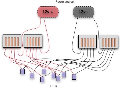

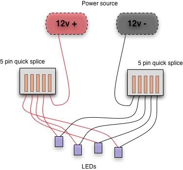

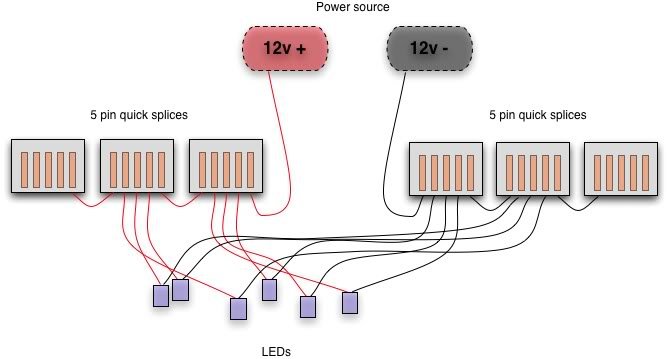

    might be a stupid question, but when it comes to wiring and such i am stupid. what are the WAGO clamps for?

    Those things saved me a ton of time when wiring my leds in my cupholders, glove box etc.
    I ran a positive and a negative from my toggle - put the positive from toggle switch into 1 WAGO and the negative in the other WAGO
    Then I ran all the positive wires from each LED into the positive WAGO and all the negative LED wires into the negative WAGO.
    Like the wires coming from the 3 LED's in my front cupholders here.....
    go under the center into the WAGO's.......
    Varak likes this.

    Thanks for asking the question and thanks to RAPR for the answer.

    That is one of the best diagrams/explanations ever....
