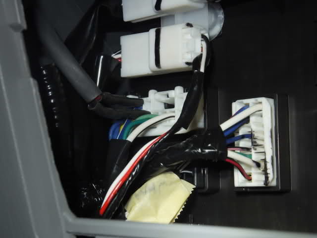

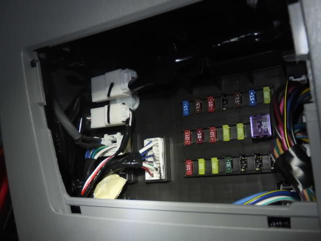

    This is for those who have factory DRL, and who want to have turn signals without having them on all the time (like will happen if you tee into the front turn signals).
    Put my ARB bumper on yesterday, did the wiring for the turn signals today. Didn't want to have them on all the time with the DRLs, but I did want them wired up. I figured the way to do it was to hook into the rear turn signals. After some hunting around, I got it wired up perfectly, without duplicating my DRLs.
    I'll get some pics of the actual lights illuminated, so you can see what it looks like. In the meantime, here's how to do it.
    Access the fuse panel (driver's knee coin drawer). Looking to the left of the fuses, you'll note that there are two horizontally-mounted connectors at the top, then a white recessed horizontal connector, then a black recessed horizontal connector, and to the right of both of those is a white recessed vertical connector. The one you want is the first white horizontal recessed connector.
    You'll want to tee off the blue & white wire at the #2 position on the top (for right turn), and the solid yellow wire at the #3 position on the bottom (for left turn). Negative is grounded to your choice of grounding locations.
    It's really pretty simple.
    You'll note in my pics that my preferred way of teeing into wires when there is a connector nearby is to insert long, skinny spades (some GM terminals I came across) into the connector itself. I'm not a fan of Quick Taps, or breaking the insulation if I don't have to.
    The connector in question is the one that has my black shrink-wrapped wires piggy-backed onto the white connector, routed upward.
