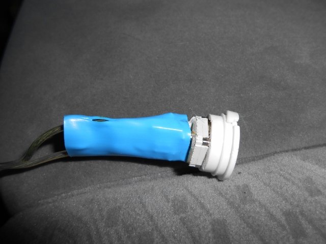

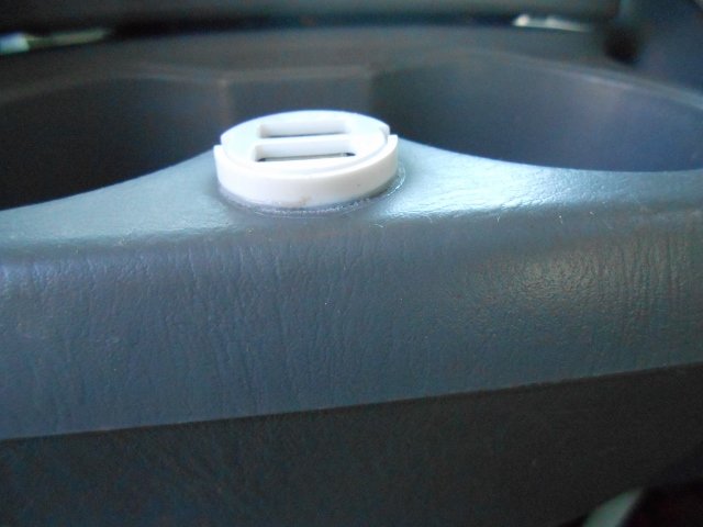

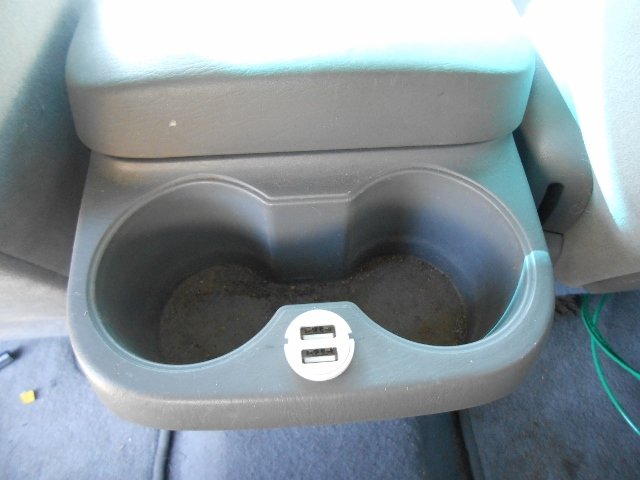

    Simple to do!:thumbsup:
    Took unit! Made by ( BYTECH) good for Tablets,GPS,Gaming Devices,mp3 players, mobile phones - 2.1 amp output! Found @ "5 Below" store.
    Cut just above metal grounding tabs, split unit soldered wire (18AWG speaker wire )to pos and neg.
    Shrink rapped it.
    Drilled hole in the back end of console @ this location. I know DIRTY!!!
    Glued unit in place!
    Ran wires to fuse box found power only when on,tapped into, installed a 1 amp inline fuse, the ground wire, I grounded!
    Good to go!!:eek:hyeah:

    :thumbsup: but I would use a 3amp fuse instead of the 1amp fuse you used because your adapter is a 2.1 amp adapter.

    placement is great and all but my only concern would be stuff falling inside of it :anonymous: and with me its prone to happen...wonder if they sell one with a cover or something

    Find one with a cover or you could just mount it vertical, on the back of the console.

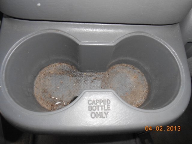

    But now no one knows to only use capped bottles only in those cup holders. :p
    Great idea and nice mod! :thumbsup:
