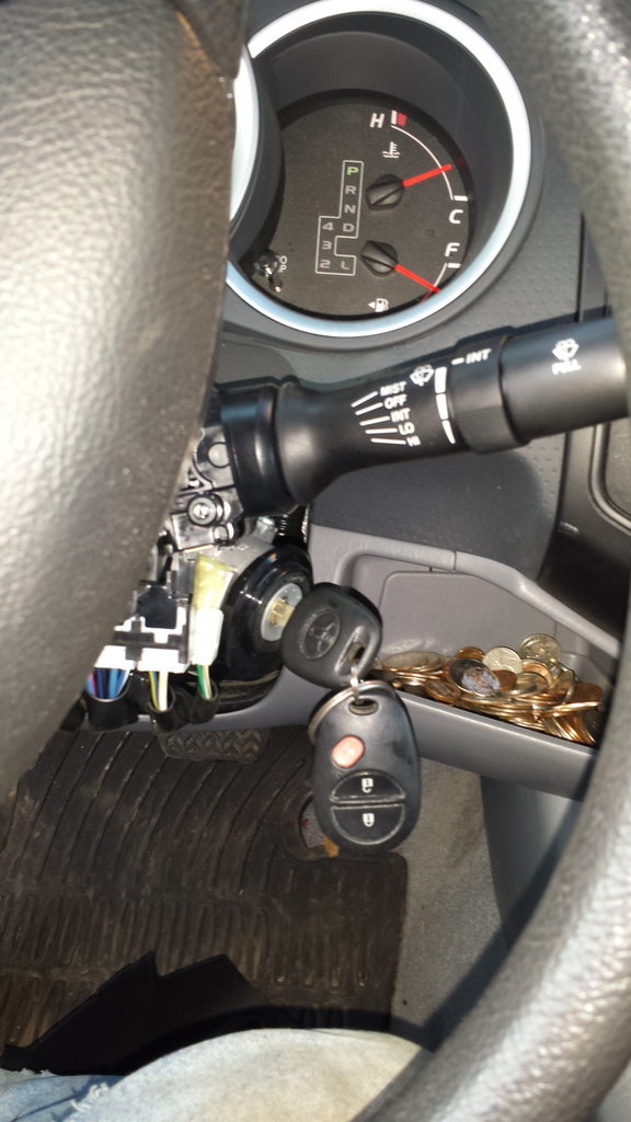

    anybody have this mod for a 2011 im going crazy with using this damn 2 speed fast and faster wipers

    Same mod will work, just order the wiper stalk from a 2011 DC SR5.
    The stalk from the '08 will actually work. The only difference between the 3 available stalks is words vs graphics, and the direction you turn the knob to increase the delay/speed. On some, the wider bar is increased delay, while on others it is faster speed (less delay).
    BTW: While you're in there, unplug the 2-wire connector just under the ignition switch next to the stalk connector and you can leave your key in the ignition with the door open for tunes or while getting gas without the annoying warning tone.

    forgot to ask... for this will i need a relay or anything beside the stick?

    Nope.
    All of the "brains" of the delay is in the stalk.
    It literally is a plug and play.
    I installed the stalk and cruise control in my '08 in the parking lot after work with my multi-tool in about 15 minutes.
