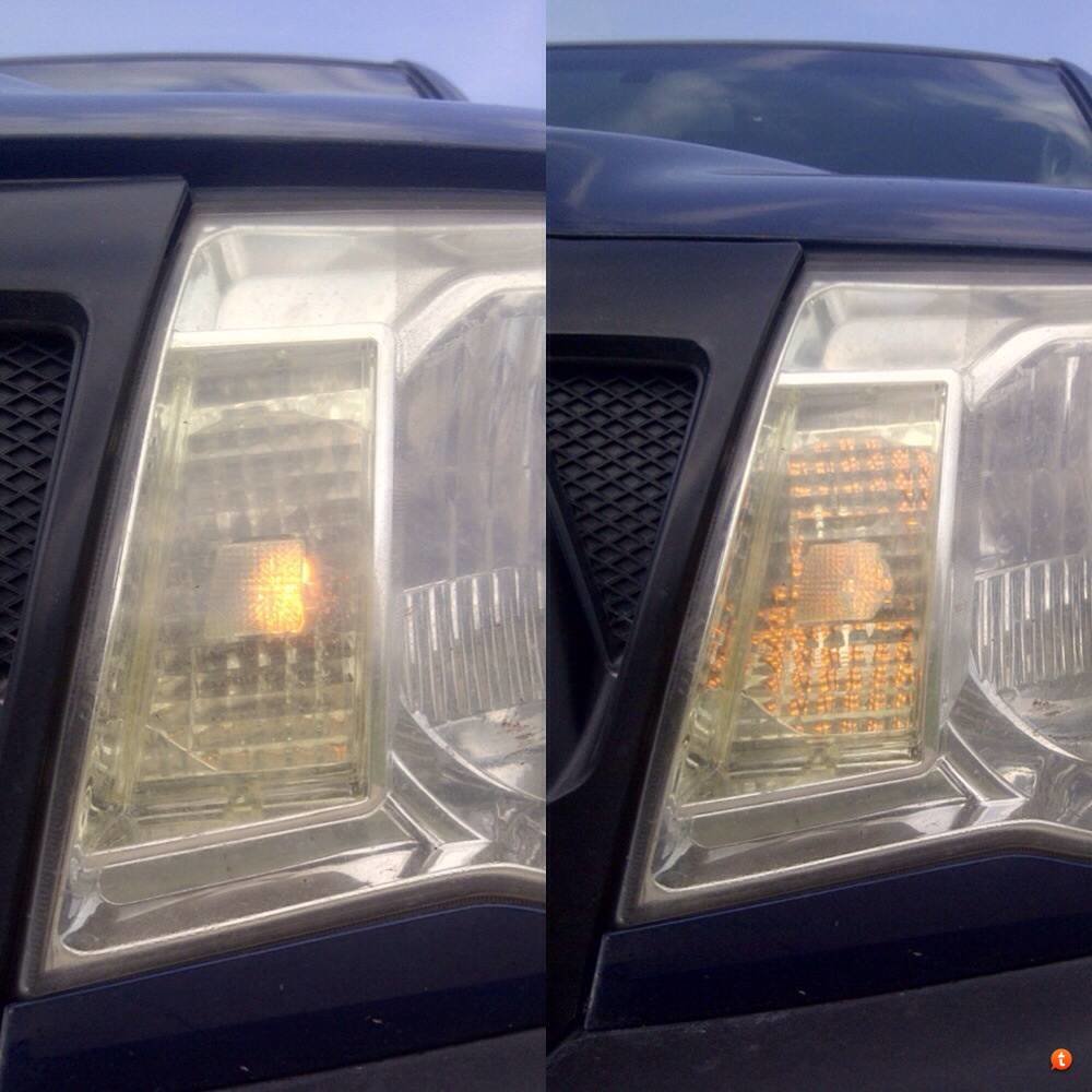

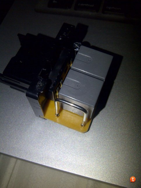

    Yes it will keep it from melting. But I'd advise not to go the autozone route for longs term use of the bulbs. They plain suck. They don't give you a 360* so it's directional. (Left autozone/right superbrightleds.com 360* bulb)
    If you switch to leds you'll also have to do the resistor mod for it or change all your blinkers to leds (front and rear) and do the blinker flasher relay mod.
    Before with just the jumper

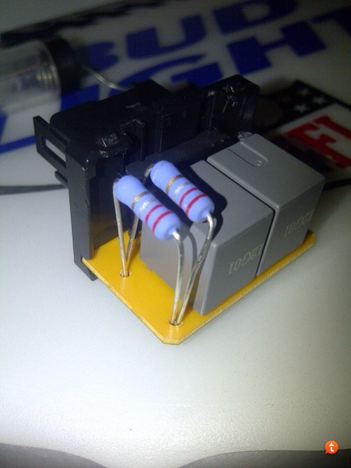

    After with 2 resistors

    are those 1 ohm resistors?

    Those are 2 .22 ohm resistors.

    I work at Radio Shack and the lowest resistor that we have at my store is a 1 ohm
