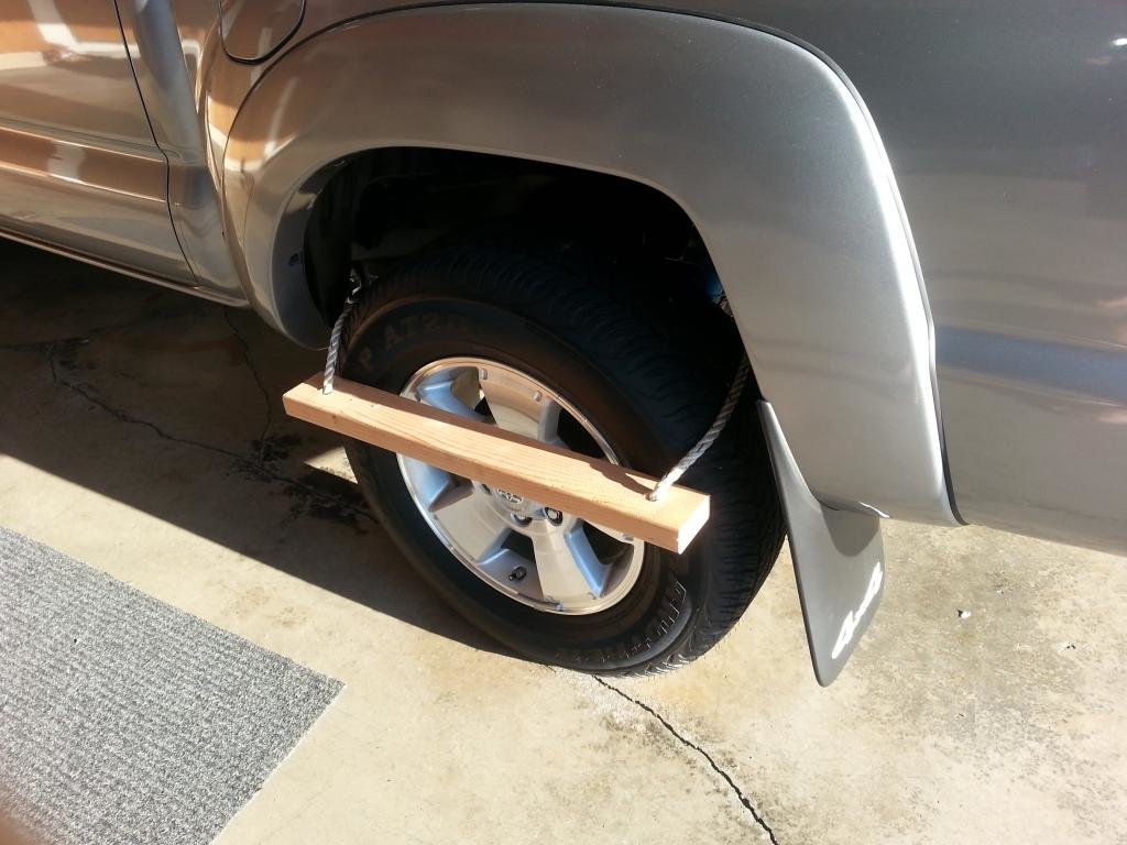

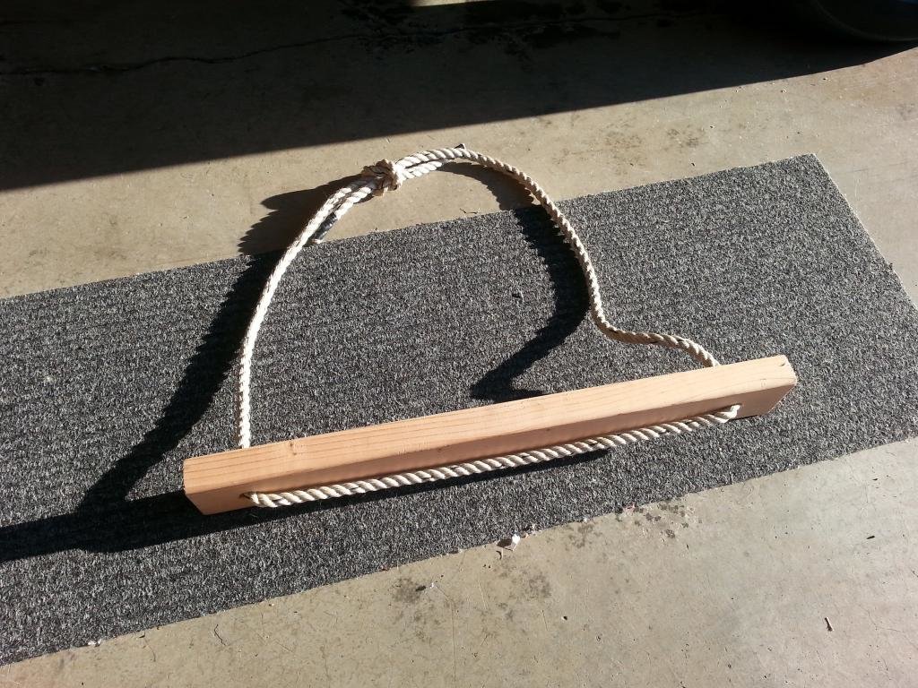

    Thule sells one...Thule is Swedish for "expensive"...I know, I have a Thule rack system.
    I put my kayaks on top of my rig and can use an extra step.
    Note: I have 17" wheels...adjust as necessary.
    Ingredients:
    26" of 2x4
    just shy of 8' good rope. should not have much stretch.
    Drill two holes approximatly 3" in from each end, thread rope and tie a knot.
    Put over wheel and feel tall...

    Nice Idea, I just step on top of the tire, but for those that can't reach so high due to disability or age, that is a great cheap idea that works just right !!

    Same - I climb all over my tires, bed, tailgate and bumper setting up our RTT.
