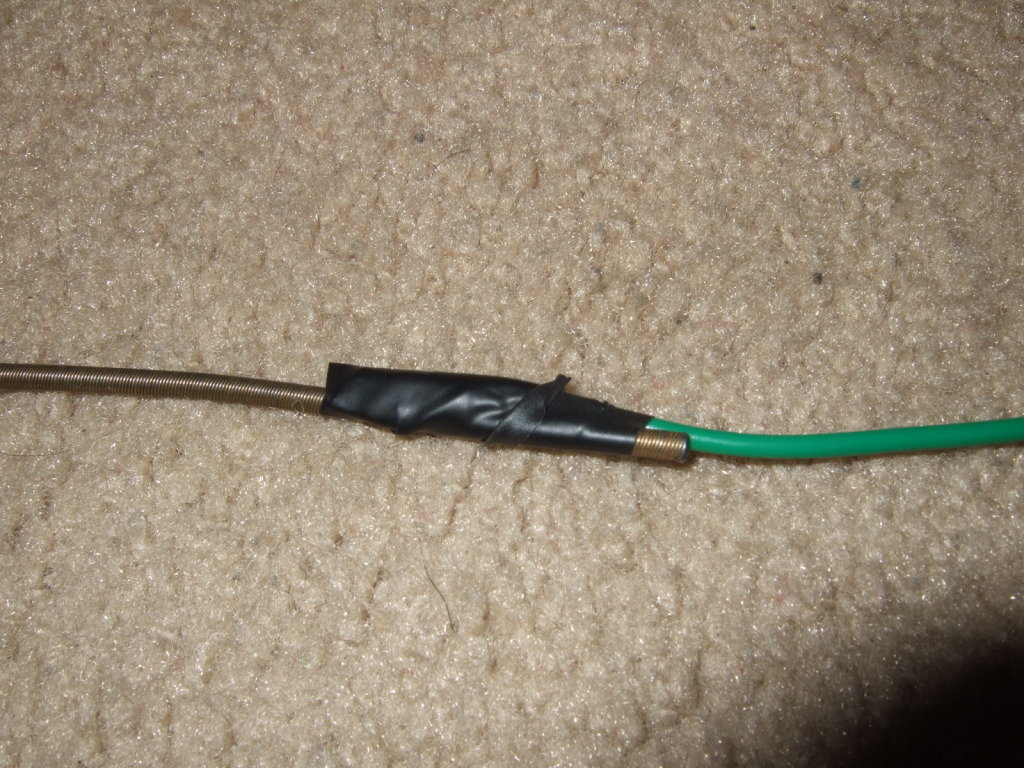

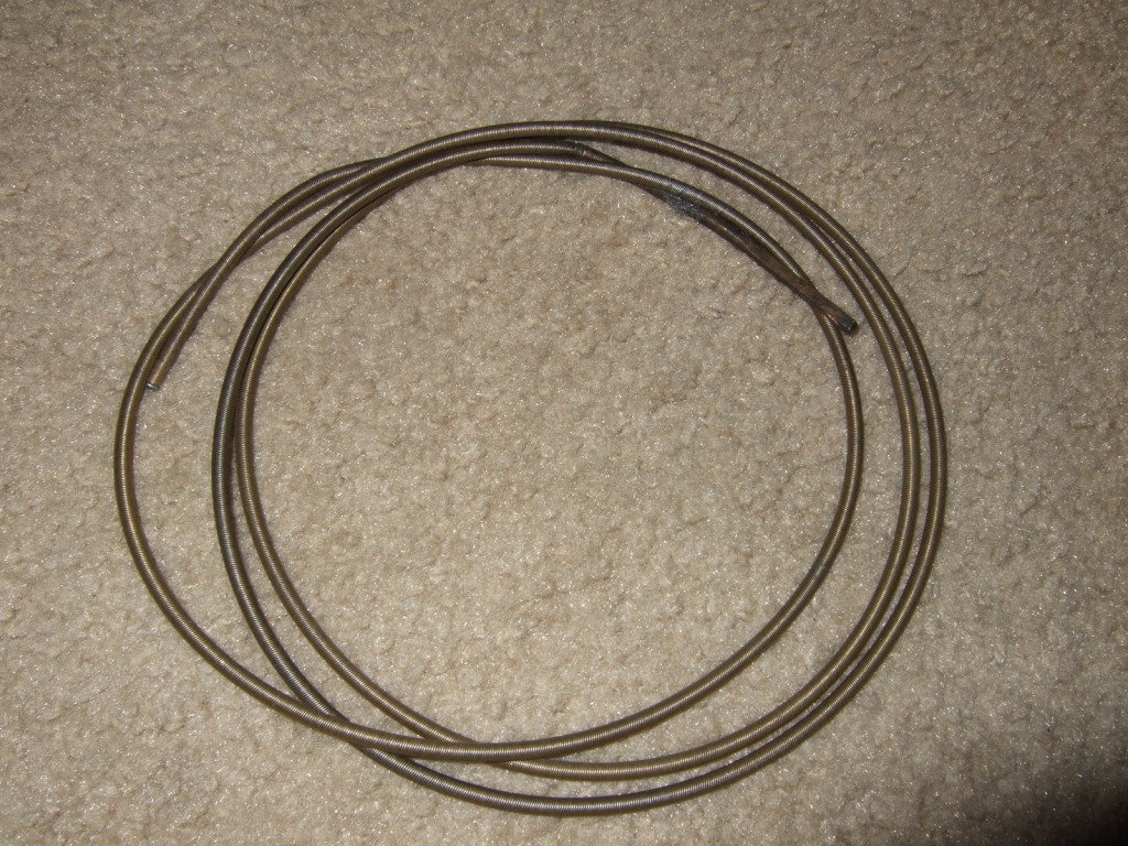

    First is an old speedo cable inner cable piece. I've used this since I worked dealerships in the 80's. Works a treat for running wires into doors (especially through those crappy accordian rubber boots), behind blind panels or under carpeting etc. The speedo cable is squashed hardened at one end to go in the old speedo head gear. Makes it nice to use to push through tight spots as it keeps its shape. Once you have it run then you just tape your wire to the other end tightly making sure to cover the tip of the wire so it does not hang and then with even pressure you pull the speedo cable through dragging the wire through as you go. Has helped in too many areas to count. Just make sure to disconnect the battery if running in areas it might come in contact with power. Can pick one up at your local bone yard.

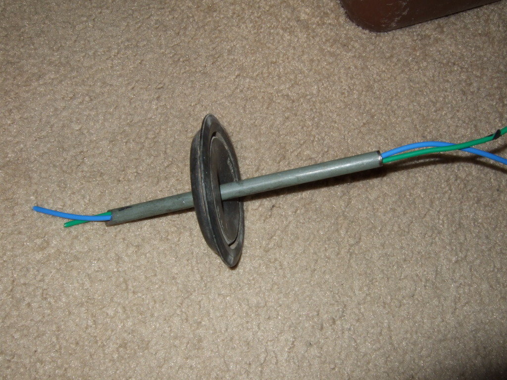

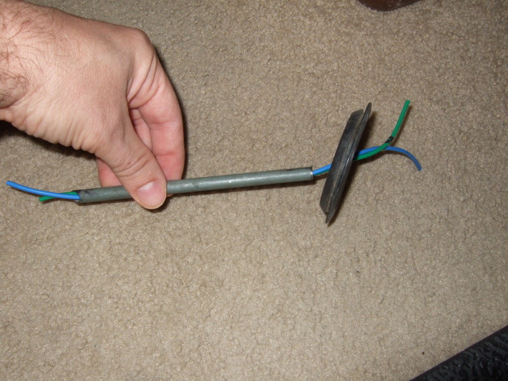

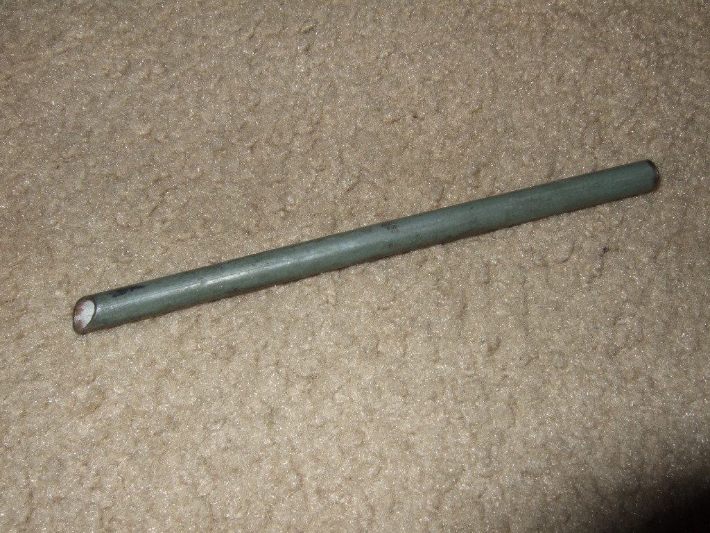

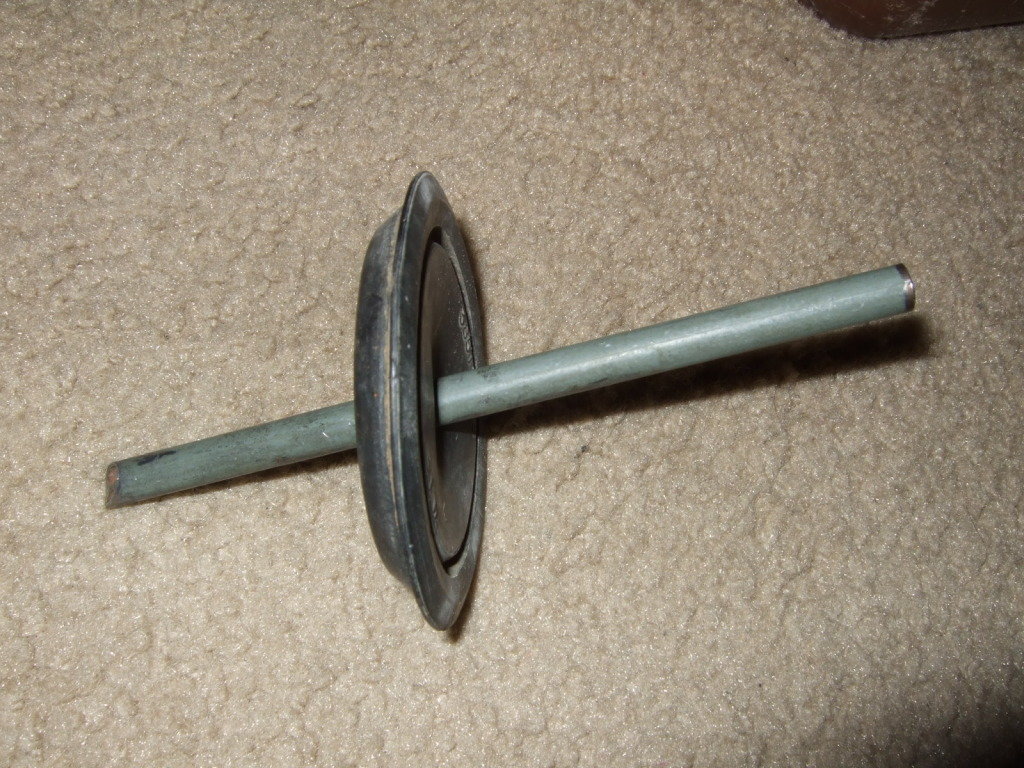

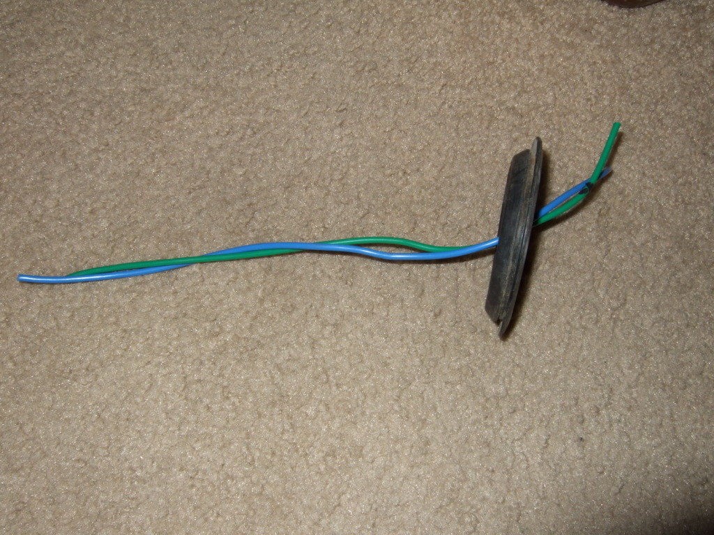

    Other tool I use all the time to run wires through firewall rubber grommets etc. It is a piece of tube about 1/4" inside diameter with one end cut at a slight angle. Not too much of an angle and you need to be sure to sand the edges perfectly smooth so as not to gouge/nick your existing wires.
    This tool works very well when trying to get wires run through a firewall grommet as you can typically push it through (angle end first) where the existing wires are so you don't have to cut an additional hole in the grommet. Even if you do have to make a hole in the grommet you can make a smaller hole than usual and then push the tube through which will expand the rubber around the tube. Once the tube is in place you run your wires through it into the interior. Once you have the wires through the grommet you simply pull the tube on through the grommet from the inside to remove it off the wires. The grommet now closes up tight around the wires so less chance of a leak. Makes running wires simple.

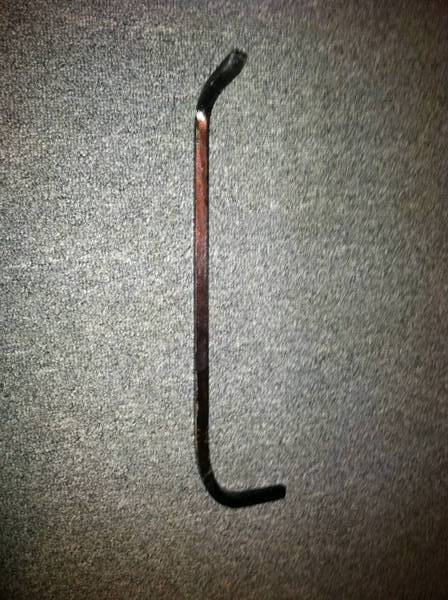

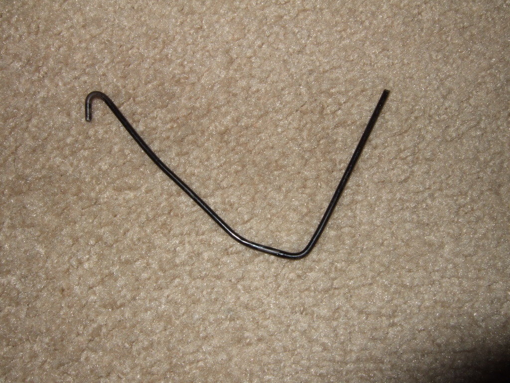

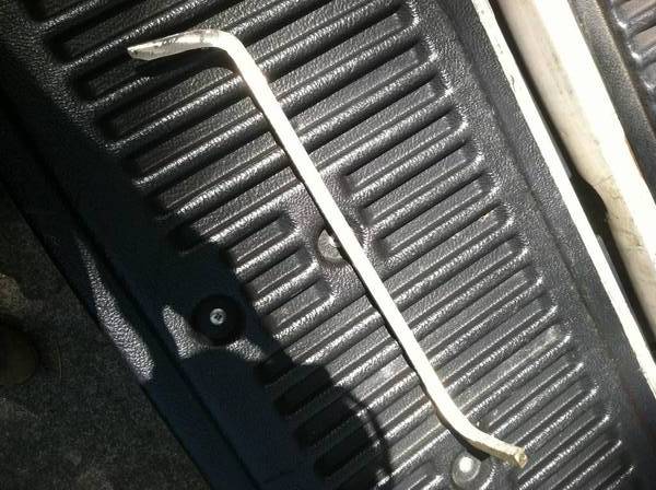

    As they say, a pic is worth a thousand words so here is another for you.
    Used this tool originally on old Fords to get the dash knobs off as they have a little spring clip inside them. Rather than damage the dash or the controller you hook the small end of the tool onto the lip of the spring clip and pull with the tool and your hand. Pops them off a treat without damaging anything. I've since used it on quite a number of other vehicles with the same sort of attachment.
    Just made out of a bent piece of heavy wire coat hanger.

    Are you saying that this works better than a regular fish tape?
    I really like the tube-through-grommet idea.

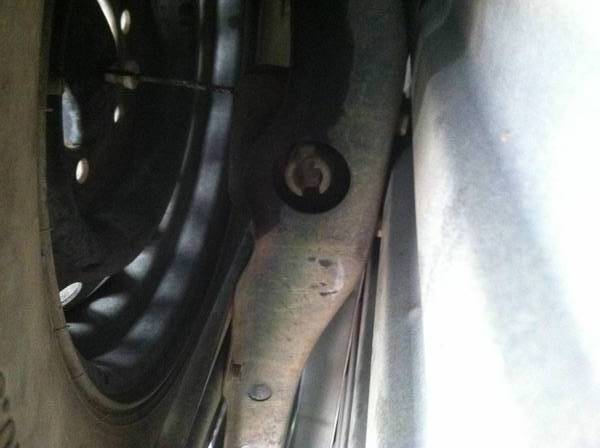

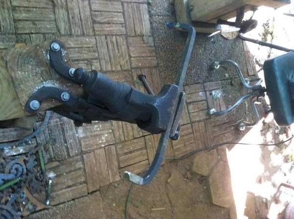

    Made this little guy when I realized my rig didnt come with the jack tool to lower the spare tire one day.
    [​IMG][​IMG]
    the finished product gridded smooth and pained black

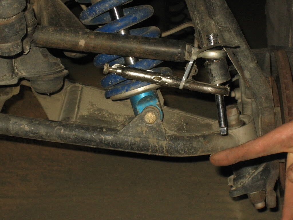

    Lost fan shroud bolts tool:
    Go-pro clamp safety tool:
    Broken tie rod tool(s):
    Wife's been naughty tools:
