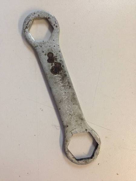

    This one is over 25 years old. I took a 22mm Yamaha motorcycle wrench and hand filed 1mm off each flat. It's now a 24mm tool that along with a hammer will get any drain plug loose. I don't even get the socket out any more. Make one you won't be sorry.
