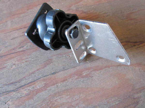

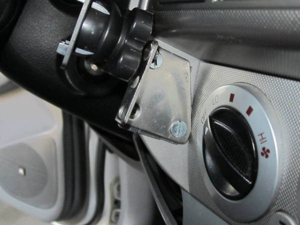

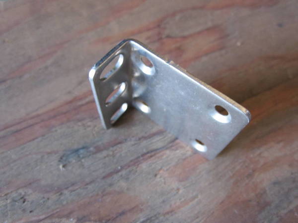

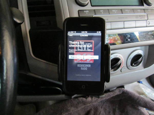

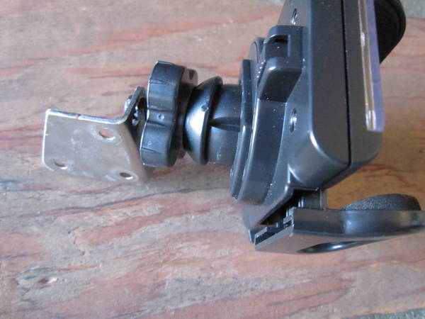

    Cheap bicycle iPhone holder $5.00 from Ebay.
    L-bracket, a couple of screws and nylon nuts.
    I didn't take all the pictures but will try to explain. Breaking the plastic off the part that would mount to the handle bars exposes the bolt that attaches to the L-bracket. The rest should be self explanatory. If you have questions, I'll try to answer.

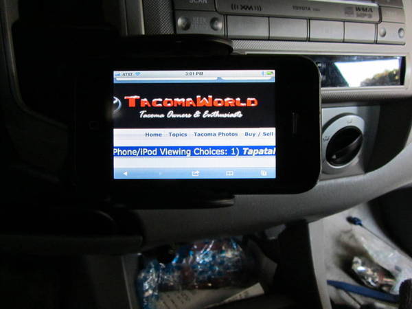

    Cheap and I like it because I can swivel the phone for a better view.

    Thanks, I hope someone would like my cheap mod.
    I didn't really like the one's that suction to the windshield or attach to the vent.
    TurboGT,
    Yes, same Idea. I like the location much better.
    I saw the one's that attached to the passenger side and thought it was to far of a reach..
