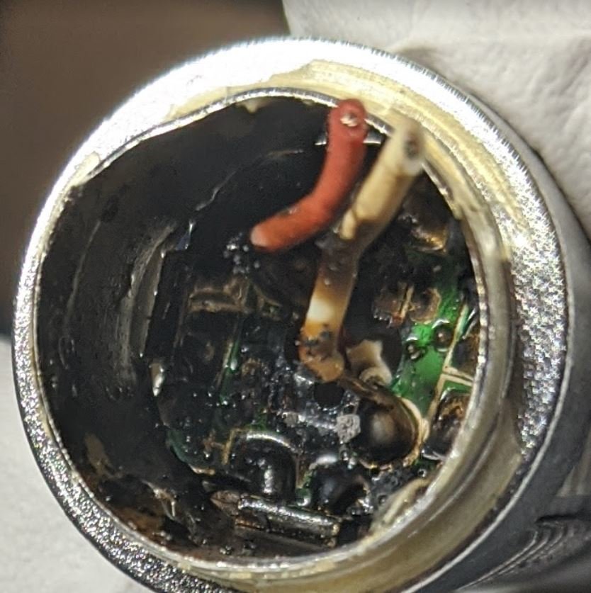

    So last night I'm on my way back from a neighbor's house. Coming down the street, dash lights started blinking on and off. Ok, that's a bit weird I thought. Turned off via the healdlight stalk and back on, same thing. Pulled into my garage and dash lights go completely out.
    Proceeded to check fuses. All fuses in cab side are fine. Checked the engine bay fuse box and the tail light 10A is blown. Replaced and dash lights are working as are side markers but no tail lights or brake lights. Pulled the tail light lens cover and immediately could smell an ever so slight electrical (ozone?) odor. Pulled the bulb and the bulb itself wreaked of it.

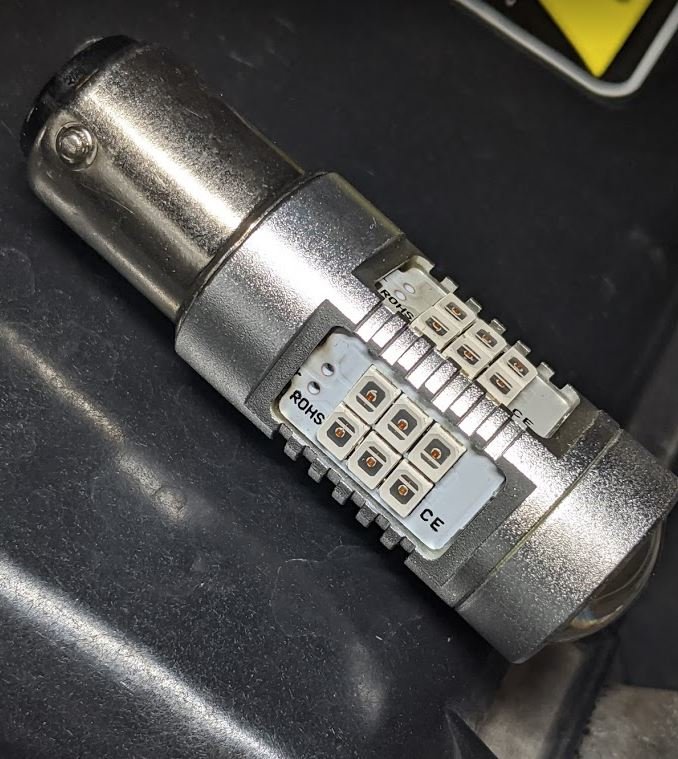

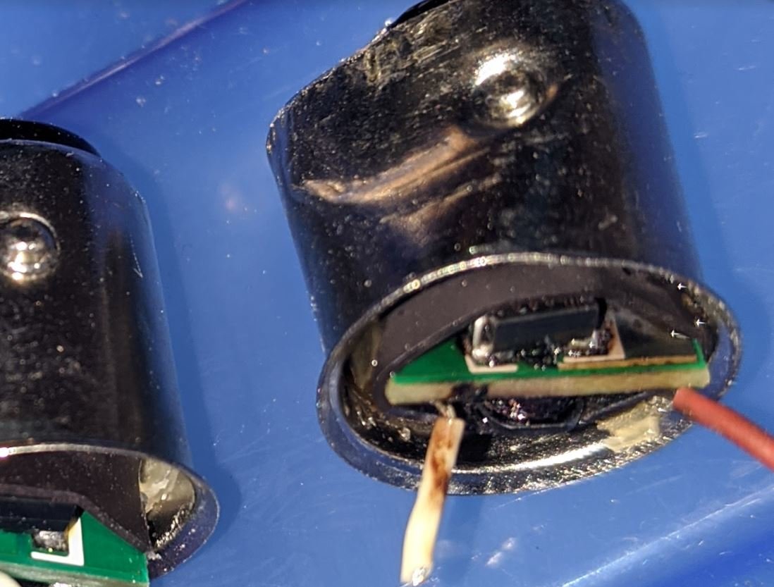

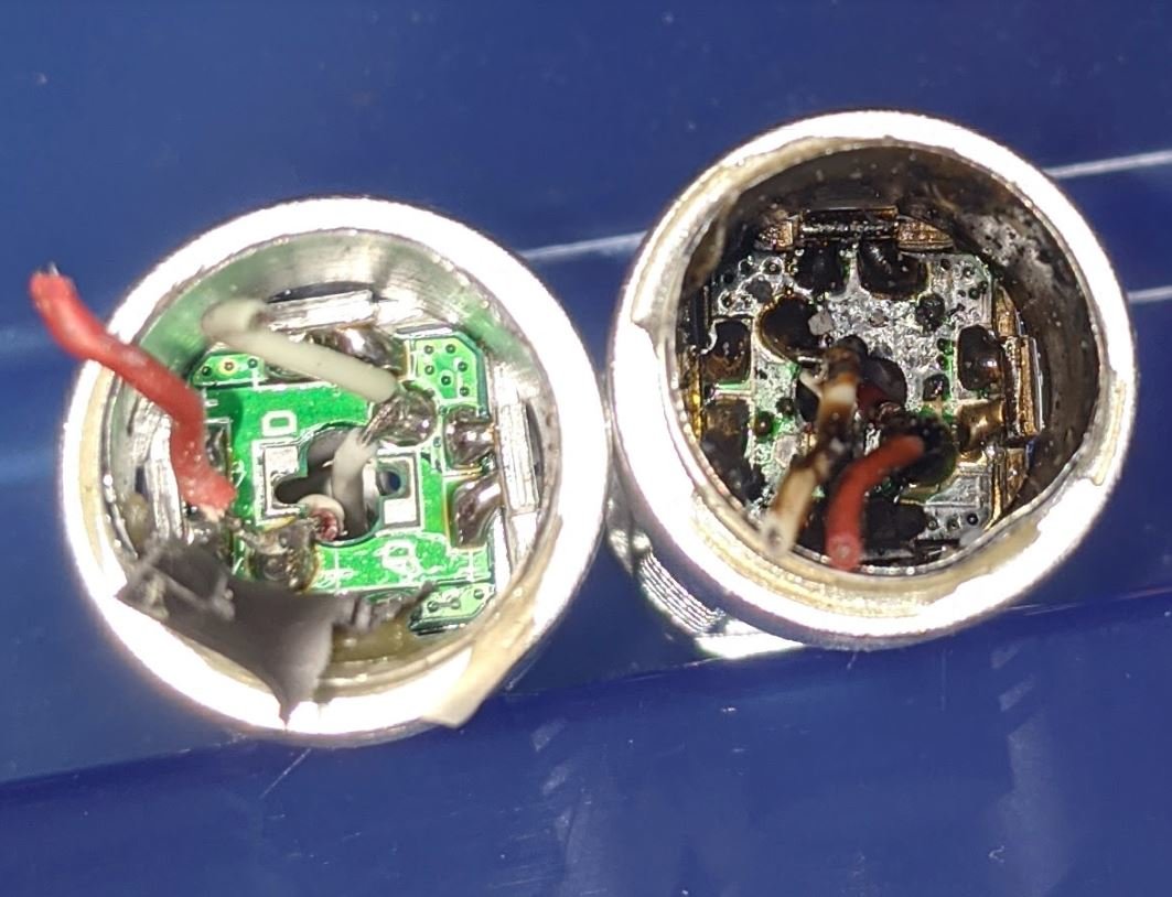

    Decided to break open the housing to that bulb since I saw a very slight discoloration kind of looked burned. This is what I found - keep in mind these bulbs were ordered from Amazon and installed in 2016. 3 years old but still... don't really think they should've burned up like this internally. Out of the 17 years I've owned this Tacoma, not once have had any electrical issue like this.
    Alla Lighting 1157

    Left bulb is the passenger side (nothing sizzled)
    What is really odd and I'm still turning gears on this one - This little board at the base of the bulb, nearly positive it was still energized even after being out of the vehicle. When I snapped open the housing, I started examining the bulb internal side and noticed a very small amount of smoke coming from the bulb base. Thought its nothing (yeah right), probably residual in that small housing. Twisting the base a bit it continued to smoke - something was smoldering inside. I snipped the wires and the smoke stopped. For good measure, a little water and it was done.

    Most likely there is a capacitor on the board to smooth out the voltage and yes, this acts like a little battery.
    Capacitors will dump ALL the energy at once and explode/smoke if you cross the contacts and short circuit them.
