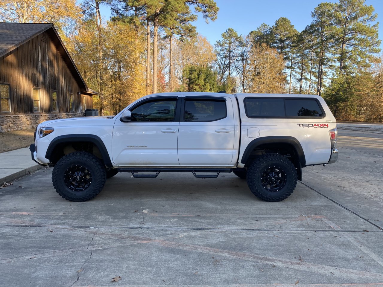

    I found that it’s really important to build your lift according to your weight. I put 700lb springs on bilstein 6112’s on top perch, with an expedition leaf pack swap out in the rear. This leveled it out perfect with a shell on it, but I’m going to shell my ARE shell so I took it off to go get a new shell and it road totally rough without it on for the 100 miles. Put the new shel on and it’s back to riding smooth again. Hard to believe that a couple hundred pounds would make a difference, but it does. Now I have 2 shells for the moment. Gotta move one to make room for some other mods I’m wanting. So really, high dollar lifts can ride rough just like cheap lifts can. So think about what you’re wanting long term and buy once.

    I love the 6112’s with 700lb springs. It rides like a truck now with no pitch and roll like the factory off road suspension does.
