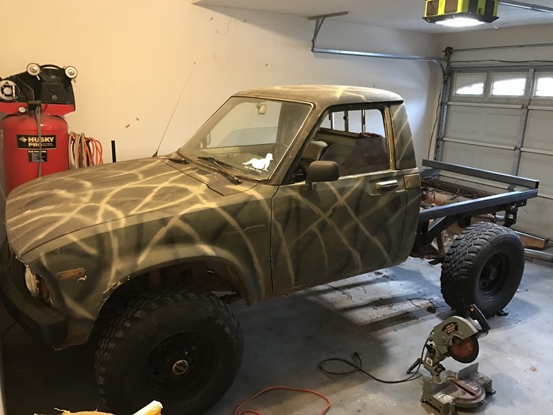

    hey guys I'm new here .. so I bought this low mile super ragged out 81 hilux locally with no bed and it had a lot of little issues one of which was no bed.. Bought a little steel from a supplier that was 2"x3" with a good thick wall from there scrap bin to the tune of 68$.. I do own a welder and made due with a Bosch chop saw and bought a new blade from home deeps . What do I have to lose.

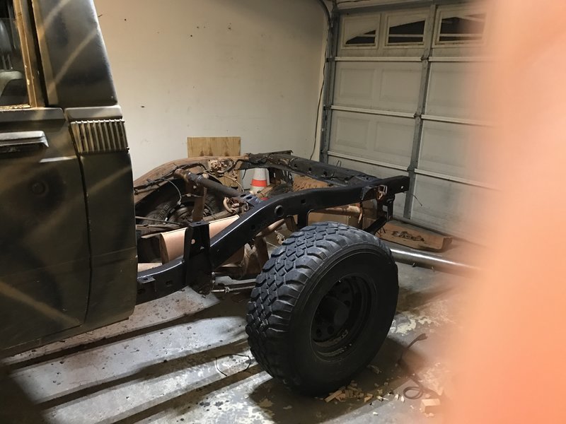

    I did treat the frame and get the are prepared. I ditched the spare winch and the old leaking tank

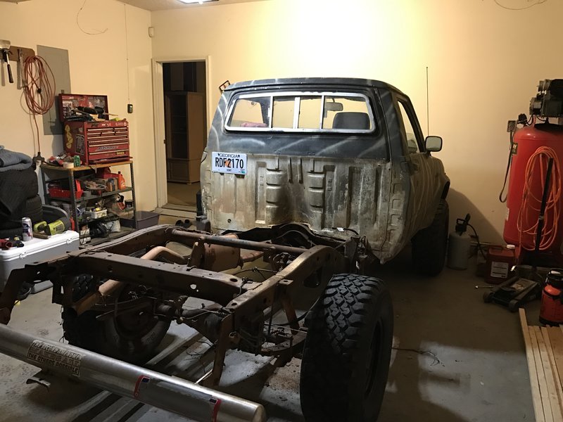

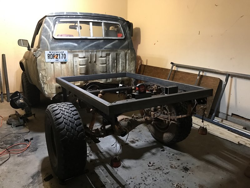

    I needed to make mounts to make it so the rear tires clear the bed during articulation

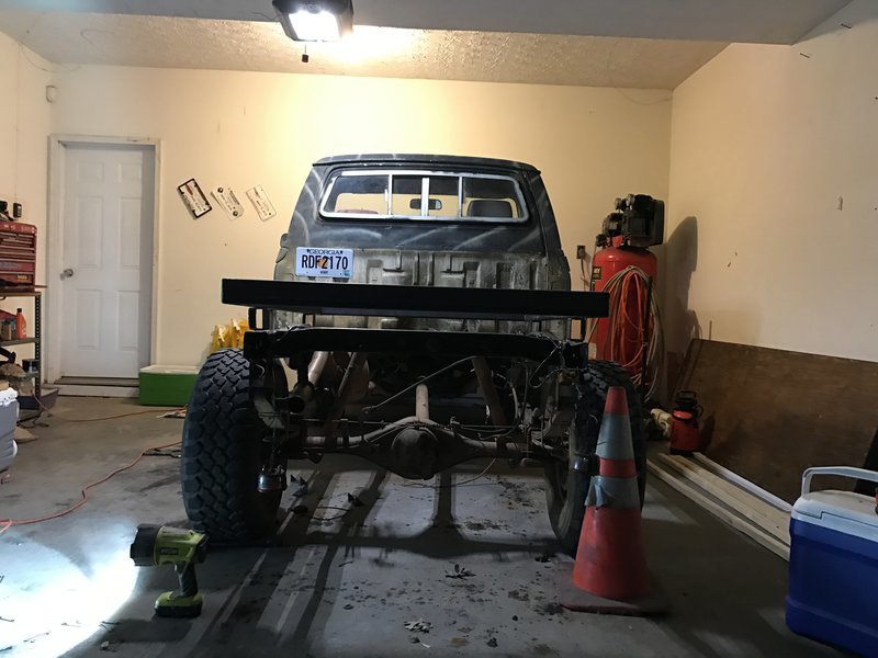

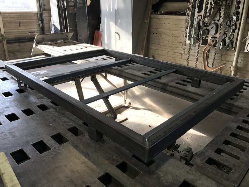

    I used my frame rack at work for a welding table... I also used old college
    Bed frames courtesy of a maintenance friend from a local college...that I used for the cross beams

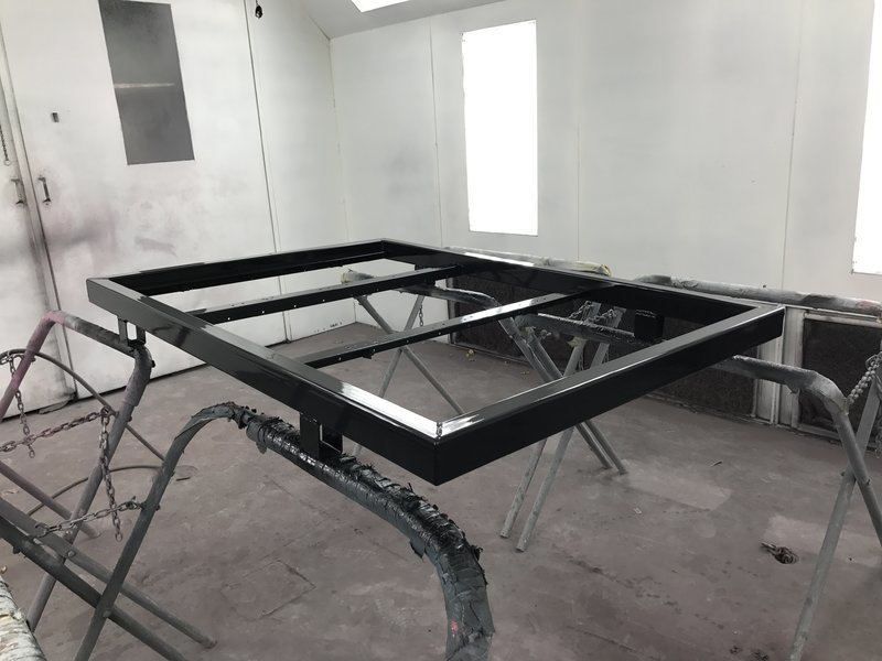

    Next was the painting I used ppg epoxy primer black paint and ppg clear

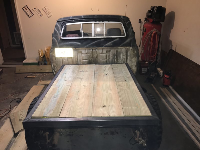

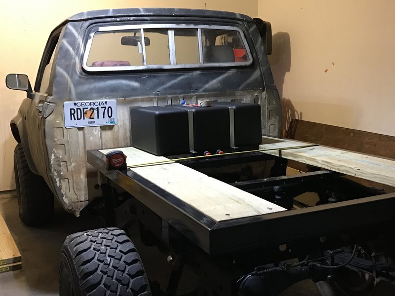

    A little wood from home deeps 2 12" board and 2 10" pressure treated boards worked perfectly with no table saw

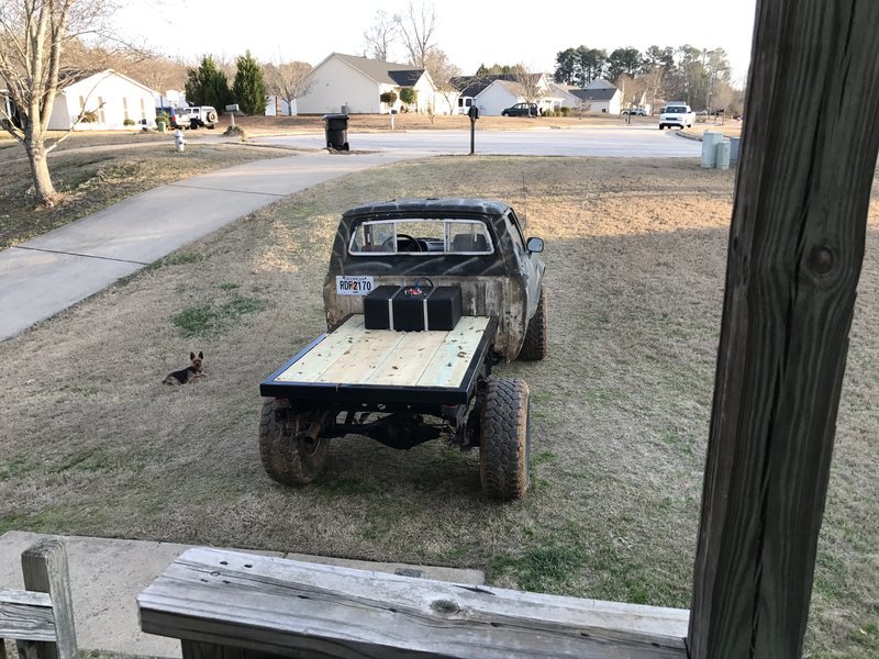

    My next project for the truck is the rear bumper ... It's a Jeep Wrangler front bumper with winch mount .. I just got some more steel to make a bracket (more like a trailer hitch).. my buddy Robert is just holding it up for the picture.. I still have to finish up on this part .. after the bumper I see a dual battery setup and winch in the near future . Then it's time to beef these axles up.
