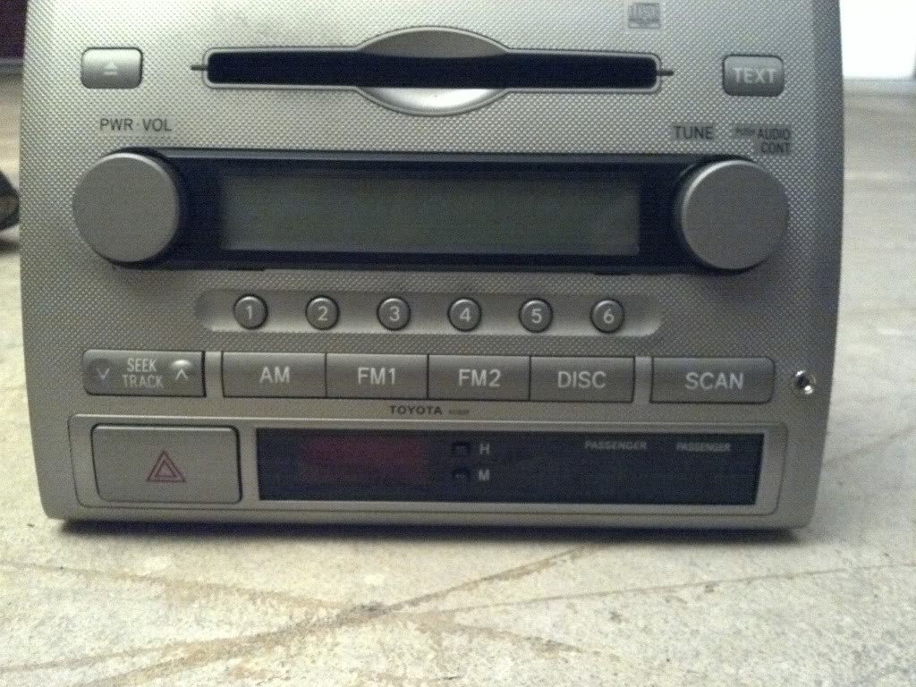

    Here's where I put mine. Works great. Can plug my phone in or connect my ham radio to run through the stereo.

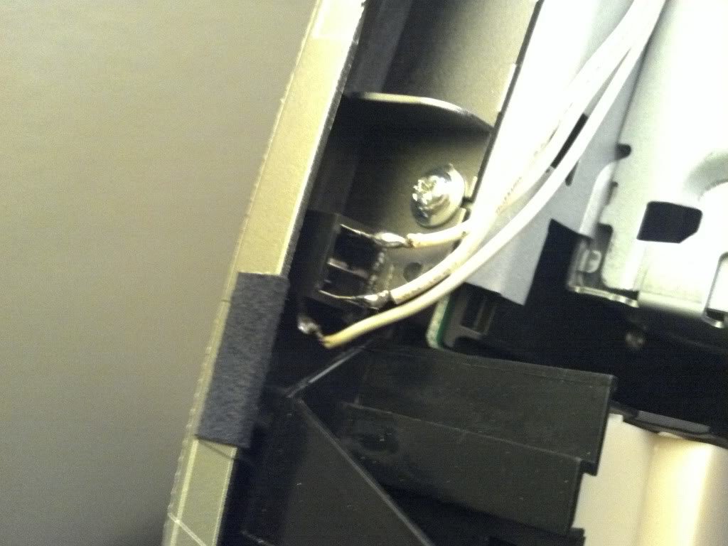

    I did this mod using CAT 5E cable and kept the sleeve. I'd like to use 3M electrical tape to secure the cable and the only place tape the cable down is the top of the circuit board for the unit.
    Can anyone tell me if the glue from the electrical tape will harm the circuitry in any way? I mean, are there acids in the glue that can cause the 'lead' to oxidize, or can it eat away at the film?
    Sorry if this is a stupid question, I just don't want to end doing more harm than good. Thanks!!!

    I wouldnt think it would harm anything??? I also used CAT 5 cable haha, all we had lying around in the shop small enough. I also heat shrunk the joints that were soldered. It was a fun little project, got a little sketched out during the radio tear apart but it went together a lot easier than i thought it would. I mounted the jack just left of the "seek track" button. Great mod and works awesome. beats the hell out of a new deck and the money involved with that.

    Electrical tape is fine for wires/circuits, that's why it's electrical tape:)
    Sweet write up!
    Just picked up the jacks tonight at the shack! OTD for under $4! I've got plenty of wires sitting around the toolbox. Gonna try and hit it up this weekend!

    This is an awesome mod. Had an old stranded antenna wire laying around, maybe 22-24 gauge, not sure. Did the rough work last night, checked it and it was a go. Cleaned it up tonight. I superglued the jack to the back of the face plate and on the side where it fits against the CD player. Fits great, snug and clean. Then attached the nut for extra security. Works great, no static, volume is consistent with the CD volume. Total cost <$4!

    It took everything slow and was careful on my soldering, however when I put it all back together and tested it in the truck, only the left side cut out and play the AUX. The right side continued to play the CD that I had in.
    Is this a problem deep in the unit where the wires were initially soldered on, or is it something else. Any suggestions. Please help me resolve this.

    That sounds like the signal from the device you're plugging into your new "AUX" input isn't getting to the head unit (on the right side, anyway.)
    Here's what it could be:
    - bad solders where the wires join the head unit
    - bad wire, with only the left channel intact all the way through
    - bad jack (either in the device you're plugging in, or the jack you ran the new wires from the head unit to)
    - bad solders at the new jack you installed
    I'd check the solders at the jack (if you even installed one.) Next I'd replace the jack. Then I'd shoot for replacing and re-soldering the wires, which would take care of the top two options.

    My bet is a bad solder on the right channel. Dude should know if his device only played in the Left Headphone.
    Obviously check from the easiest to access, checking to see if you fixed it in between each progression.

    Hi I have the same stereo as u do and I did everything except I soldered the aux wires in the front of the circuitboard instead of the back is that fixable?

    Solder isn't permanent. Unsolder and move the wires if your not happy with it.
