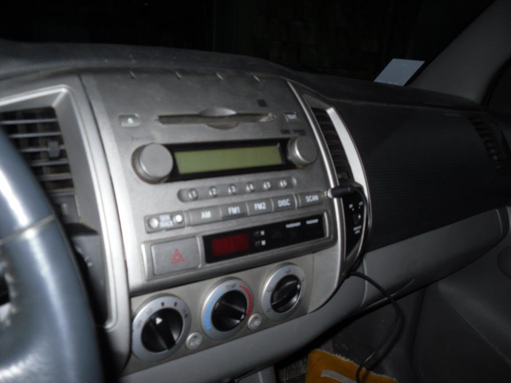

    I picked up this adapter at Fry's for $4.99, my Galaxy S3 now works with my stereo. I didn't have to open up the stereo again and add/delete any wires, same two pin mod as the OP. Total cost of mod still under $10:cool:

    Yeah I have seen those before and you can actually get something similar on ebay for less than $50. Not a bad way to go. But when I did this mod I didn't want to wait for shipping or spend a lot because I was just going to replace my head unit anyway. I suspect the majority of the people who do this mod are already on the fence with replacing their head unit and they figure this is a cheap way to squeeze a little more life out of their old one. That way if they fail there is really no lose.

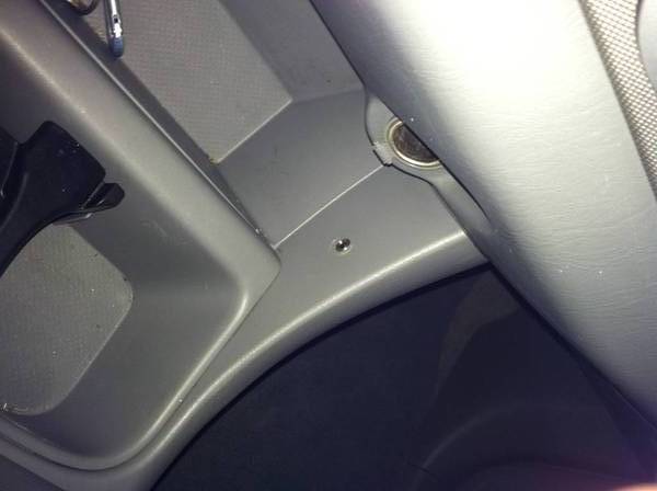

    Just did the mod today. It was scary delving that deep into tiny fragile electronics, but it worked like a charm. I did the mod as per the O.P. directions and it sounds and works great. Right now I have a long male 3.5mm jack coming out near the cigarette lighter. Tomorrow when I am back home (with access to my own tools) I'm going to put a female jack where 1mrwatermaker put it.
