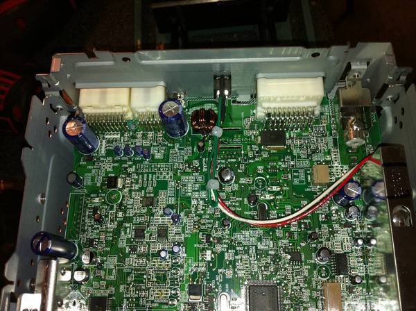

    ok so i removed my head unit again disassembled it re soldered both connecting put it back together double checked all the connections (when i took it apart they were all connected) and installed it and it works perfectly no static or bleed thru even when the trucks on and off and when charging my phone so im not sure it unpluging it or just re soldering the connections fixed it but i no longer get the error 3

    Its possible but probably not like you are thinking. You could cut the ends off the coaxials and individually solder them directly to the head unit like this mod shows. You would need to locate a power source to solder the USB part too if you wanted to be able to charge your device. Even then, you would not get any data transfer from the USB connection it would only be good for charging devices. Also note that you would probably want to use a PTC fuse of some kind on that power source to protect any device you plug into it.
    If you are wanting a USB connection I would suggest looking at a isimple or grom unit that is designed to work with the stock head unit.

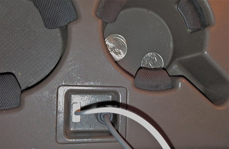

    Ok, so this is my first post here. I wired up the aux input and it is as easy and satisfying a project as I thought it would be. Took apart a cig lighter USB charger and wired it up also. Both are installed in the little coin dish on my console.
    It made for a nice little project on my new truck. It's stealth and reversible and cost next to nothing.
    I also installed a $25 Homelink unit from eBay in the headliner. It looks and works like it was a factory option.
    And now that this aux input is done in the truck, I really appreciate the simplicity and ease of Bluetooth, streaming, and handsfree phone action I have in my car.
    Bad cell phone pic:

    I installed a home link unit in my sun visor as well. The visor was busted so I had nothing to lose taking it apart. It ended up working out pretty well. To run the wires I hollowed out the plastic L shape rod that mounts the sun visor to the roof. I like the USB charging port, looks like a clean install.

    Very clean, I like your jack location.

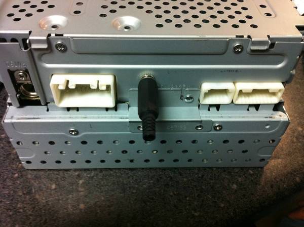

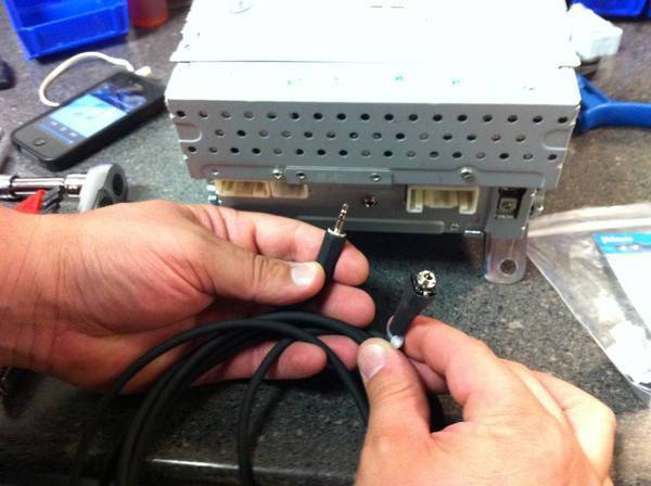

    My friend helped me to this mod but he did it a way cleaner way with no cables sticking out. this is a inside view of the wiring
    This is an outside view. I can just plug in the the calble
