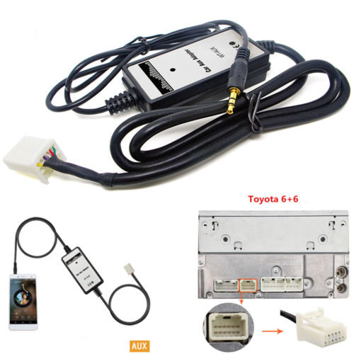

    I have the non-Bose, 6 disc radio and when I wanted to listen music from a mp3 player or my phone, meant earbuds. I consider getting a double din radio with all the latest gizmos, but that just wasn’t for me. Then I found this thread and thought this mod could be what I’m looking for. Some of the posts made the mod less appealing. While other posts gave me ideas about some of the gadgets out on the market that could basically do the same thing. So, I took a $20 gamble (free shipping) and purchased this
    https://www.ebay.com/itm/Car-MP3-Pl...e=STRK:MEBIDX:IT&_trksid=p2060353.m2749.l2649
    This thing works great. Was able to keep the steering wheel controls and I can switch between a CD and the aux input by pressing the “disc” button. The volume is a tad lower on the aux, but I can live with that.
    I know most of y’all already have either a double din, or some other fancy schmancy entertainment system in you trucks. I posted this in case there’s some other old fogy looking to do the same with their antiquated radio.

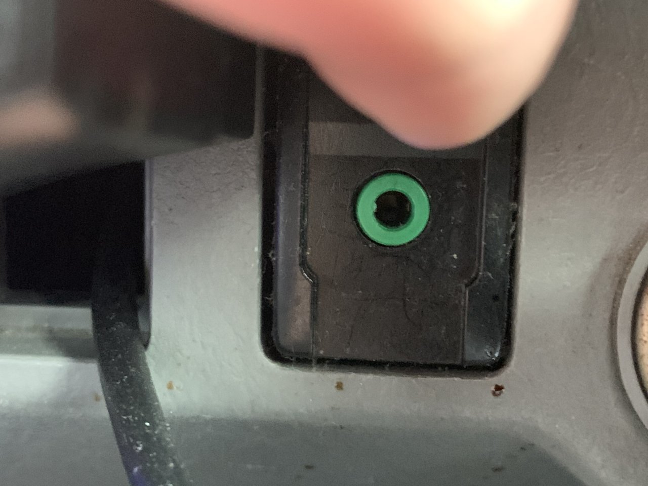

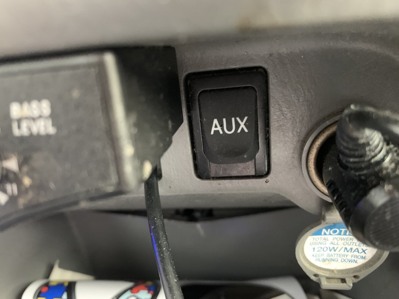

    My 2010 has factory AUX jack that hasn't been used since I installed a new HU in 2013; I was happy with the factory radio, but I really wanted a backup camera and Bluetooth, so that's why I replaced mine, and also I didn't have JBL so my factory speakers sucked...
