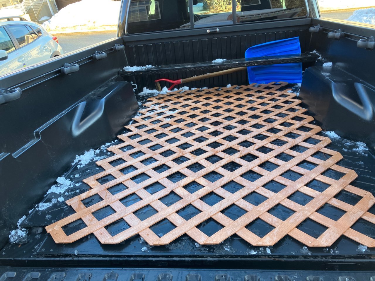

    Cheap plastic "lattice-style" fencing in the truck box in the fall and winter. You park on a slight uphill, and then you can pull a foot of snow or a pile of brush and it just slides out in one big mass. Used it this morning to get ~6" of snow out of the bed before going out on various grocery errands...

    With this cheap hack, you just put deck’d and all the other bed slider shelf manufacturers out of business! :thumbsup:

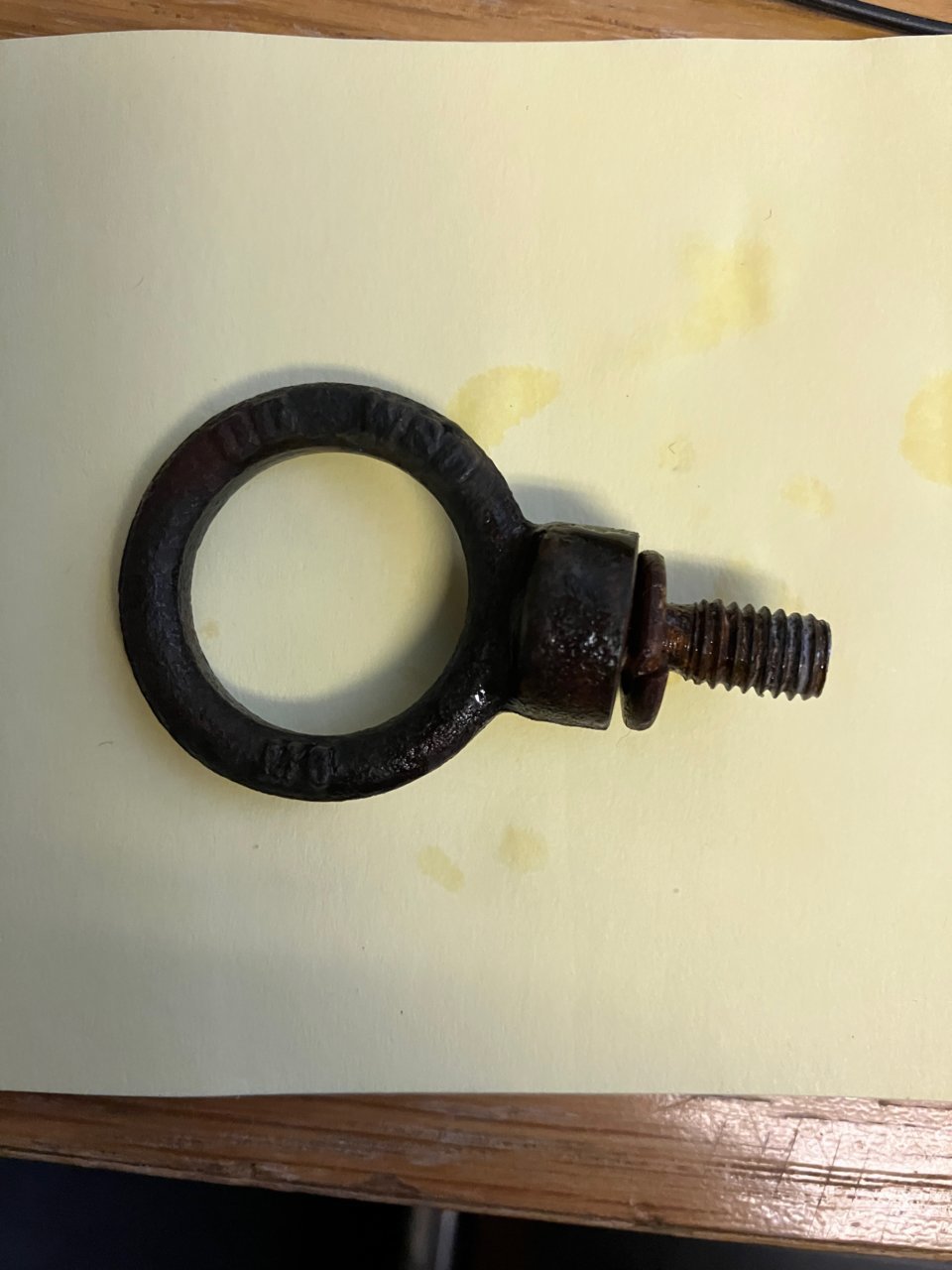

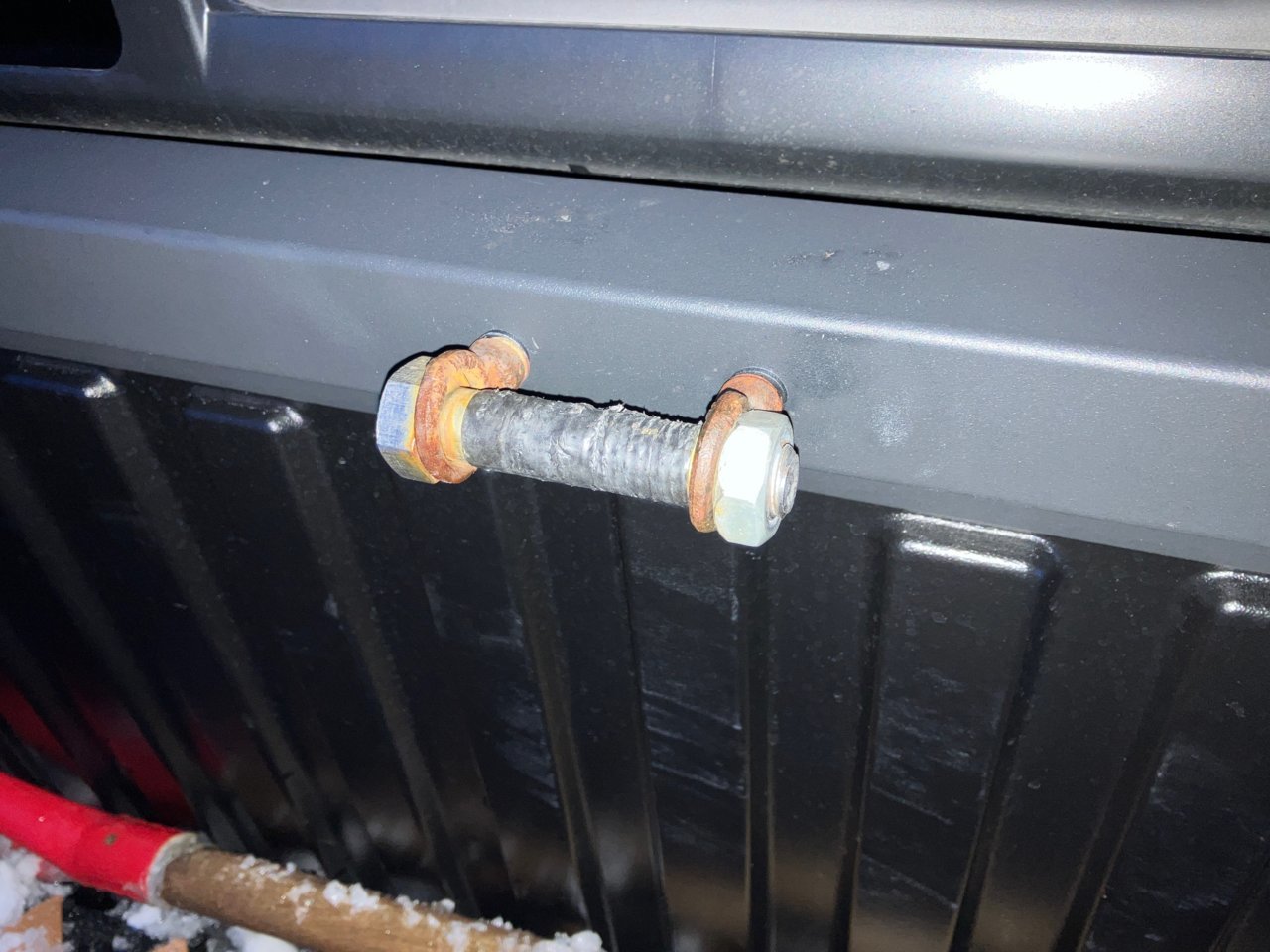

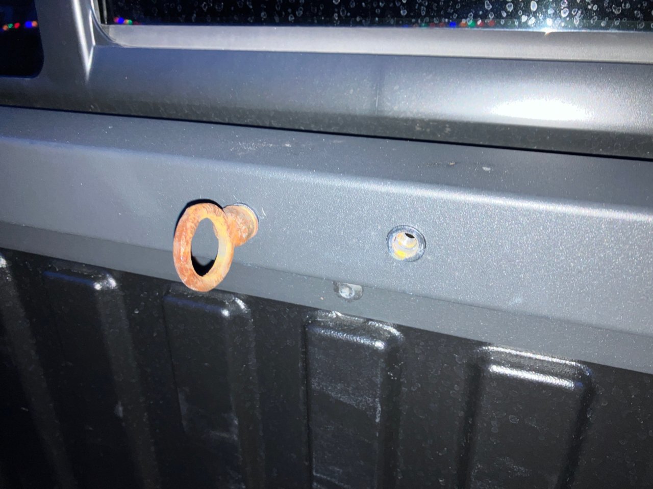

    If you don't have a tonneau cover, you can use the two threaded inserts in the front of the box to make a little tie-down/hoist point. I used two Crosby M6 shoulder-nut eye bolts (with washers to get them to align properly) and a 5/8" stainless bolt, nut, and a bit of duct tape to get a reasonably strong attachment point in the center top of the front of the bed. I wouldn't use it to winch in a boat or an elk, but maybe a bicycle or a Xmas tree. You could just use the eye bolts alone if you wanted; they have a 19 mm (3/4") opening which works for most bungie cord hooks.
    Yes, I see that they need cleaning (edit: washing them was fine, that "rust" was on top of the paint). See last photograph.
    Link to the Crosby catalog:
    https://www.thecrosbygroup.com/prod...ric-forged-shoulder-type-machinery-eye-bolts/
    Updated: I see McMaster Carr sells a similar product in the M6 thread. Too bad the 316 stainless version only comes as small as M8.

    Now imagine if he took out the bed mat haha. it'd work even better

    Yup. I have a home-made platform with a 3-ft wide sliding box shelf underneath- it may work well with his idea too.
