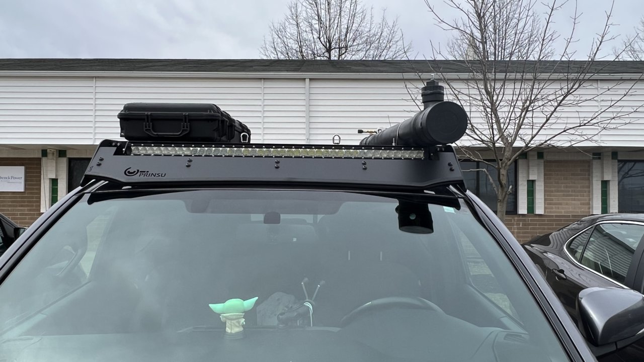

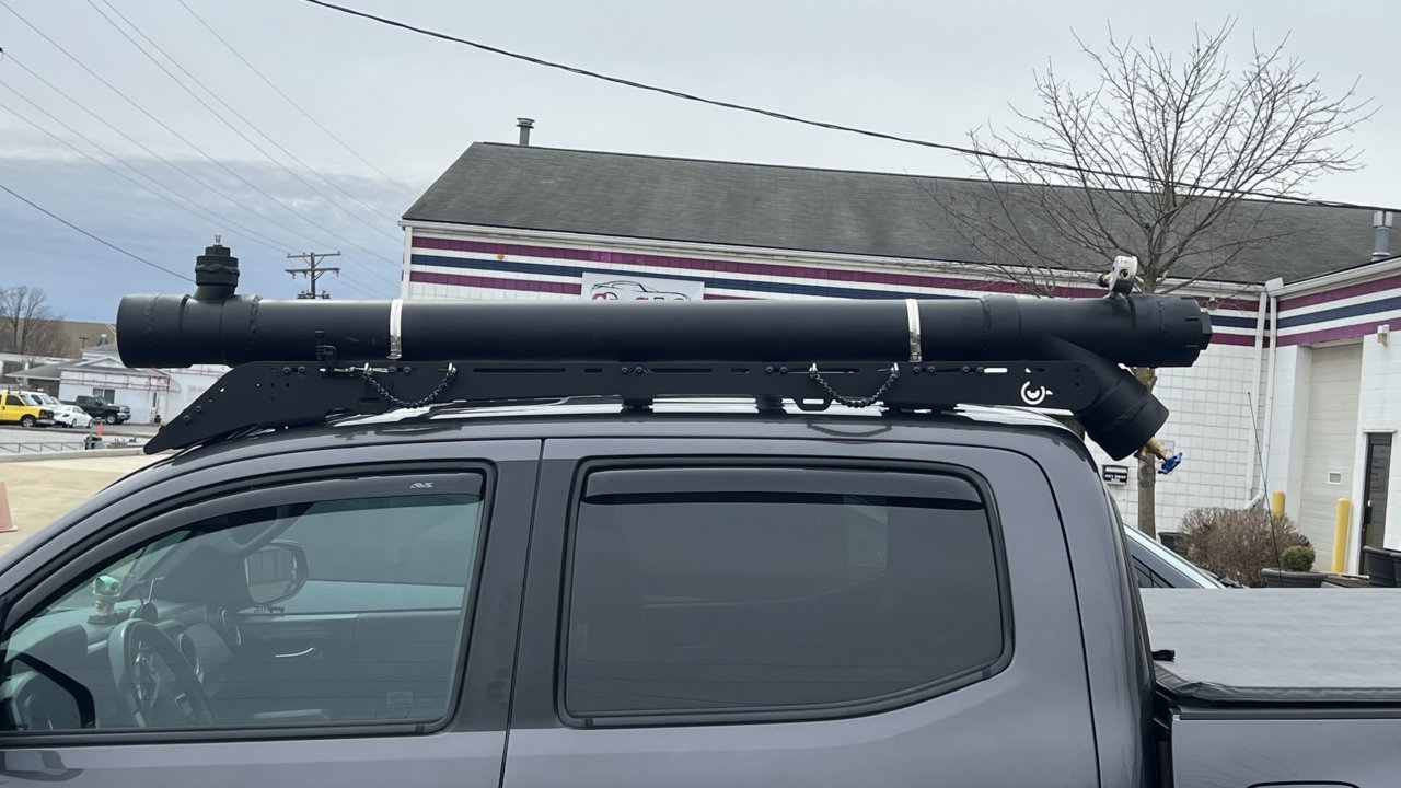

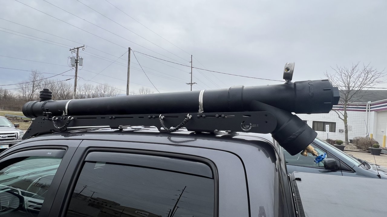

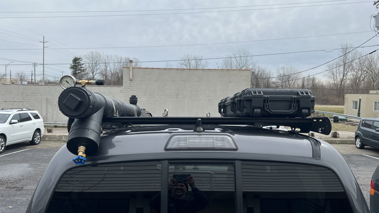

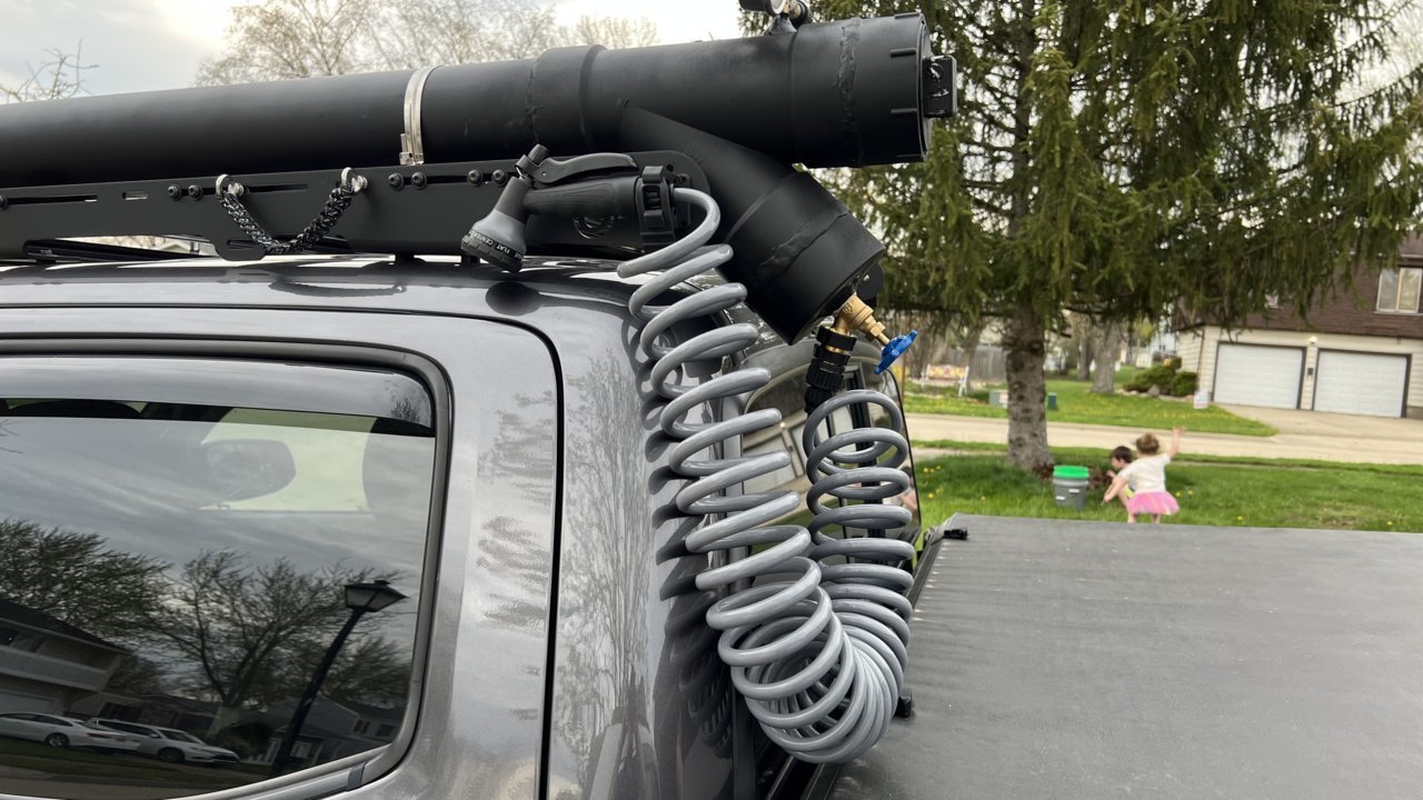

    This looks good! What are you using to pressurize it?

    if that is to carry water, wouldn't it be more appropriate to mount on the passenger side to counteract "taco lean"?

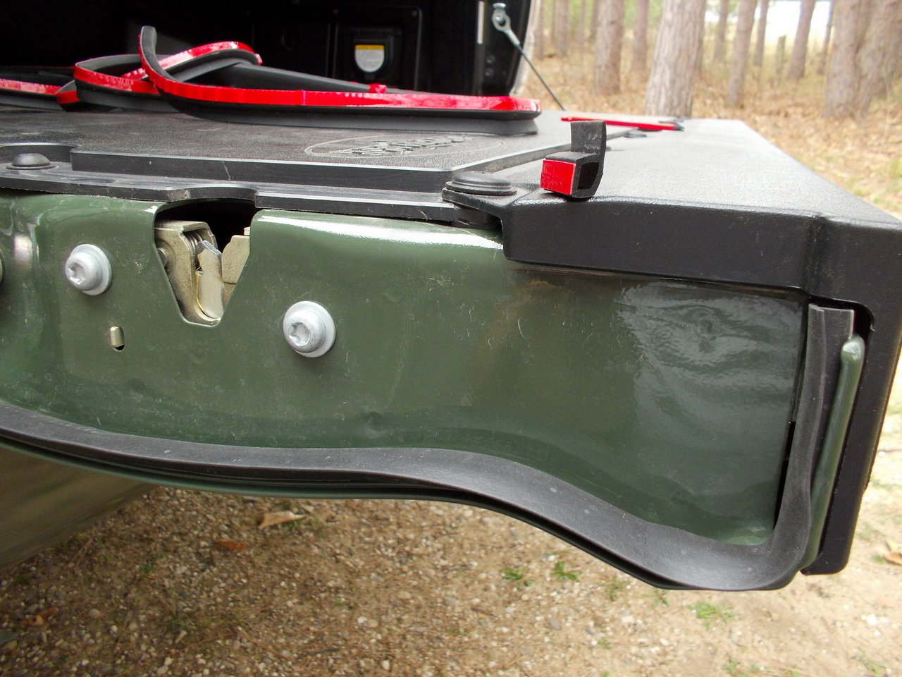

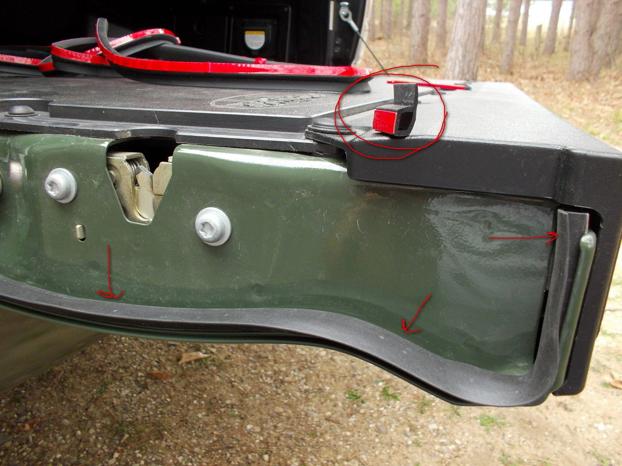

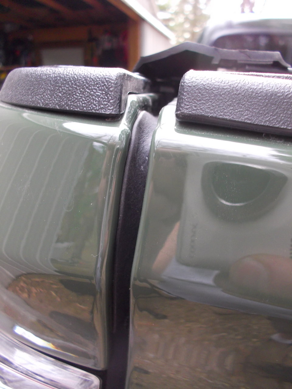

    only problem i see with the tailgate weather strip is the dirt on it will scratch up the paint. keep an eye on it

    Thought about that, I figure if it starts wearing into the paint I'll put a strip of that clear rock guard stuff right over the wear mark. No sense doing it until I see where it needs to go.

    Small usb rechargeable compressor. Does well at about 20psi for what I need it for and holds 4.5 gallons
    Probs just the parking lot I'm in. There is no water when I took these photos
    Def squint, man what a terrible photo now you mentioned it. I project a much nicer smile.

    I did not notice any lean in your picks. I was just commenting on the lean we all have due to gas tank and battery
    and driver (when no passenger) being on the driver side. You have the opportunity to balance things out a bit (rather than make it worse) since
    it will be at least 60 lbs when full. 4.5gal x 8.34lbs/gal + 20lbs (guessing empty tube weight). every little bit helps.
    Btw: beautiful build.
    EDIT: of course effect lessed by weight of carrier already on passenger side. I guess it depends on wether tube is significantly heavier than carrier. difference may be in the noise.

    Hmm interesting. This thought never would have crossed my mind. My pelican is def pretty heavy and that is alway on, always full. I’ll plan to make a few adjustments and give this some more thought.

    if the carrier is heavy (pelican) the only way i can see to improve things would be to move the tube closer to the carrier. to do that you'd
    have to turn it around to put the outlet in the front so the rear light is not obscured. i don't know if that would make
    it too inconveient to operate. might not be worth doing.
    i carry heavy things like stored tire chains, and anything heavy in the bed, on the passenger side to do what i can to balance out the built in lean
    so it came to mind when i saw the tube. worth considering and rejecting if a reason...but if not - maybe a win.

    In the warmer months, I run a bed rack and roof top tent. Weight distribution is probably all whack anyway. The truck is really packed when I weekend camp. My plan is to run a solar panel between the pelican and the water tank.

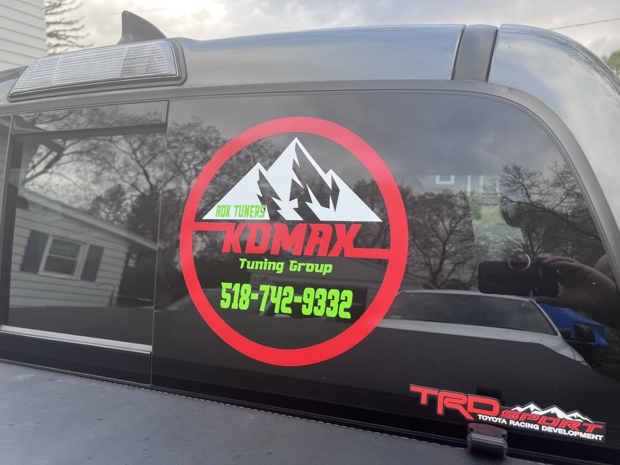

    My wife made me these! That definitely doesn't make them free though..... :spending:IMG_7815.jpg IMG_7879.jpg

    Those are worth a nice dinner out and you get to advertise the tune business more!

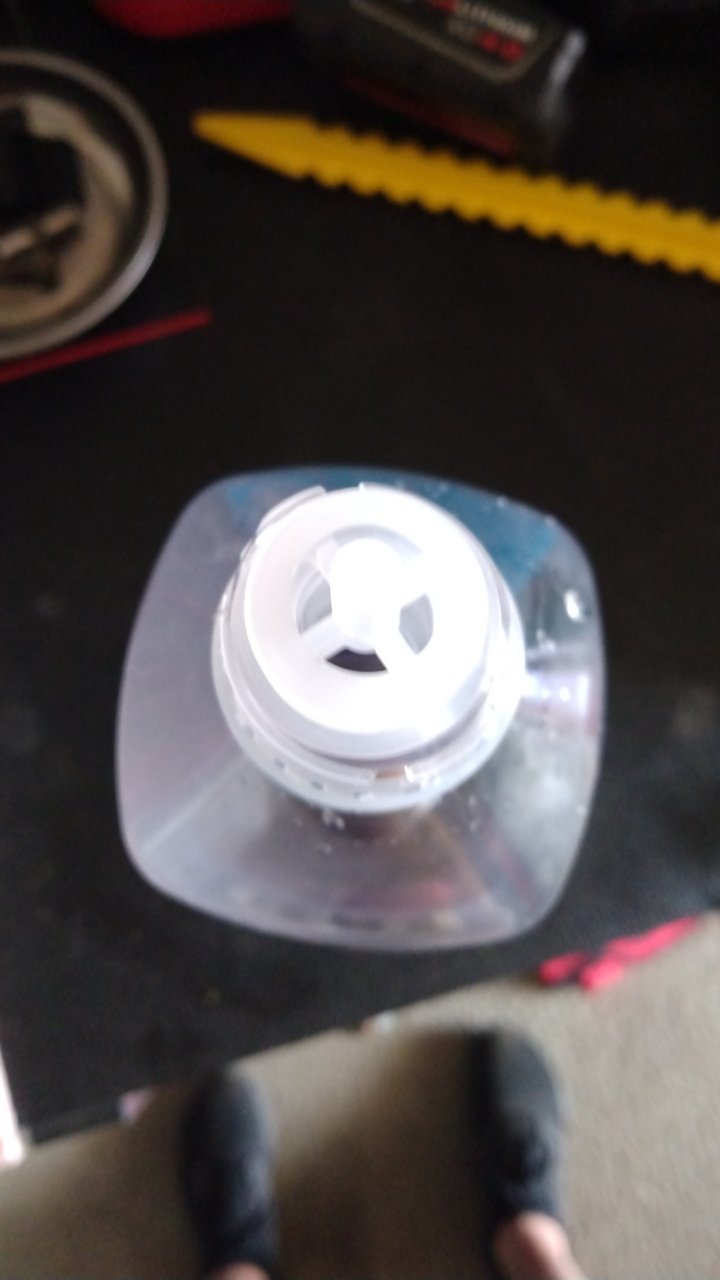

    The plastic plug that gets pressed into the oil filter housing to drain it, well my fram ultra came with one that threads into the housing instead of getting pressed in. That's genius enough but my wife's overpriced bottle of human oil was a perfect fit. The fram plug had to get pressed in just slightly enough to keep it tight so it doesn't spin freely and you can now thread it in with the bottle.
    Custom made mess free oil filter housing drain tool, pre-order now for $19.95!!!
