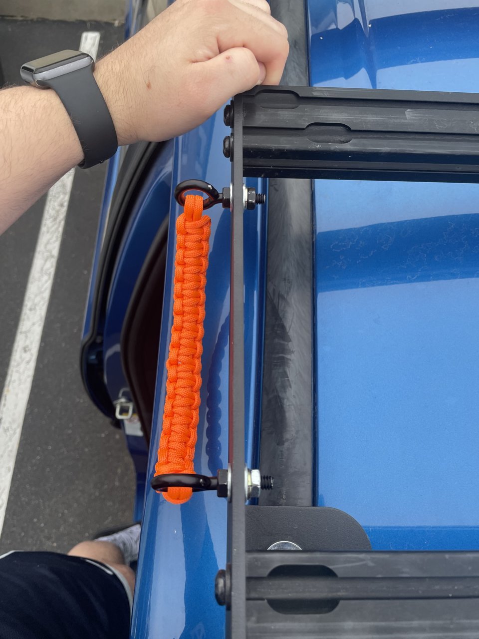

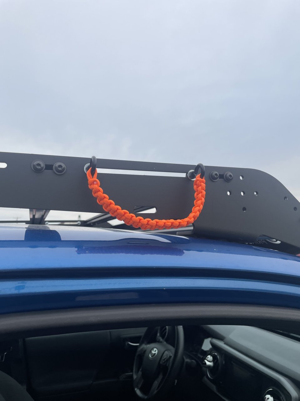

    as promised here’s the paracord grab handles! ~$20 for two to make yourself as compared to $100 for bought metal ones

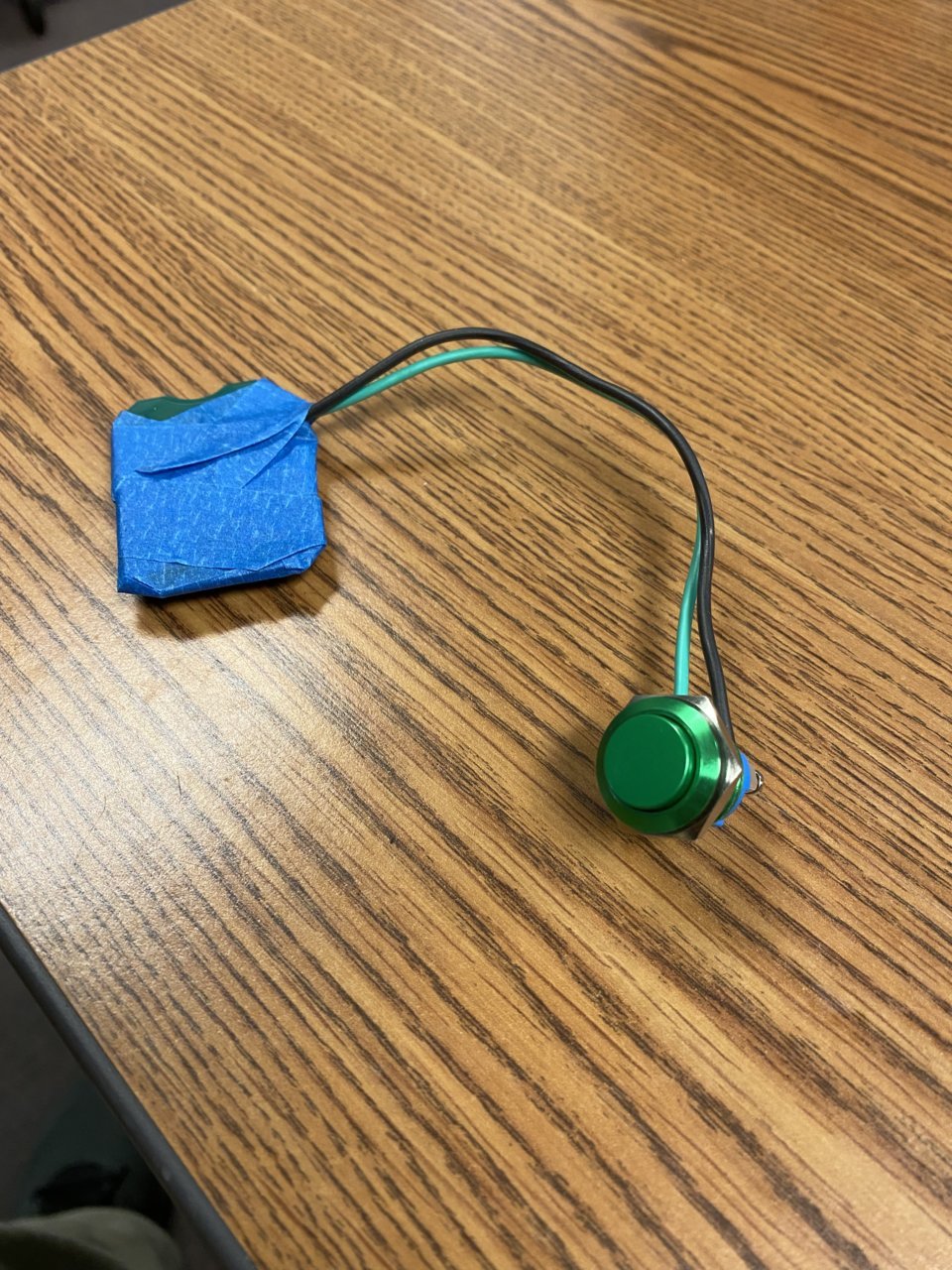

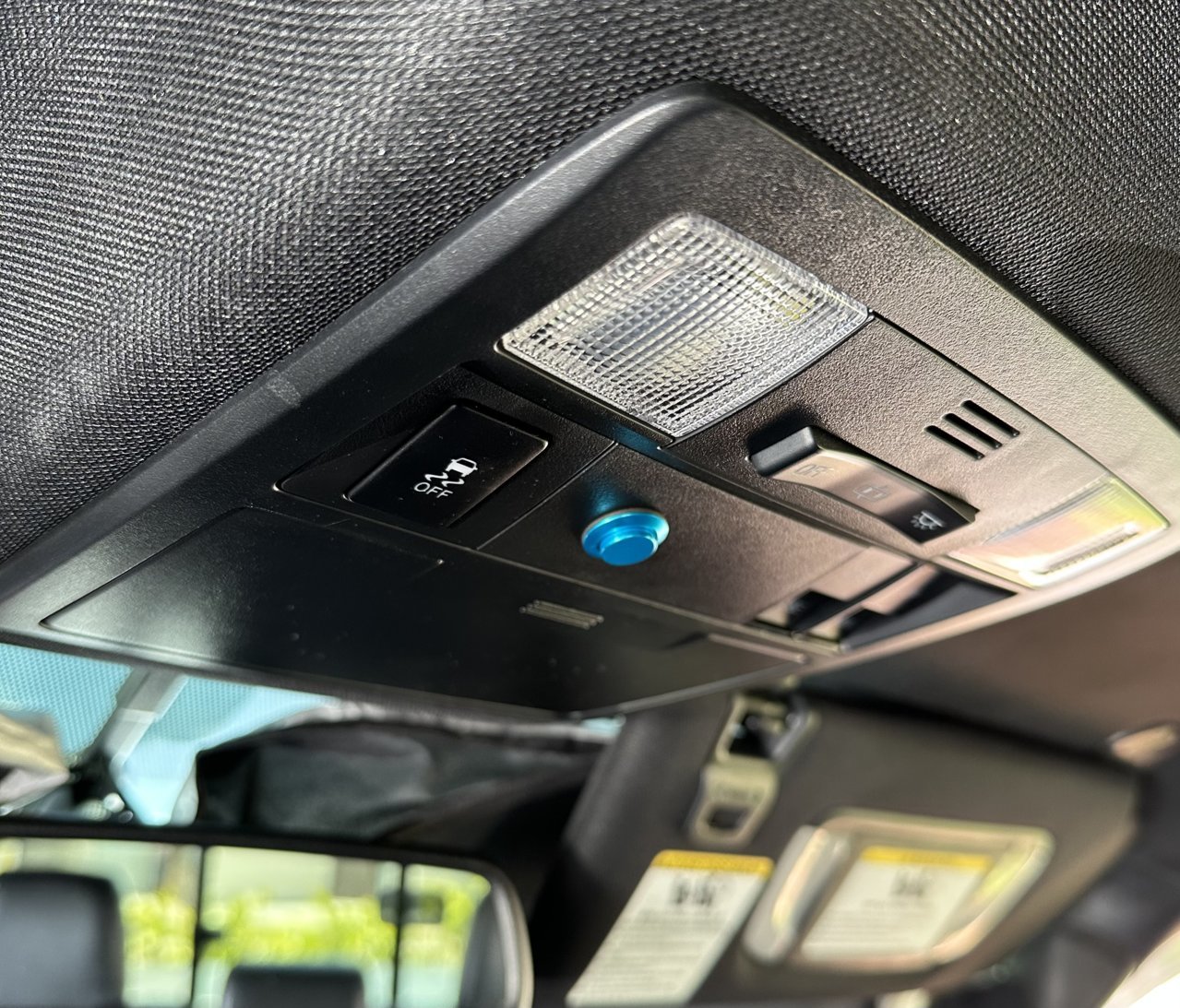

    Garage door opener button

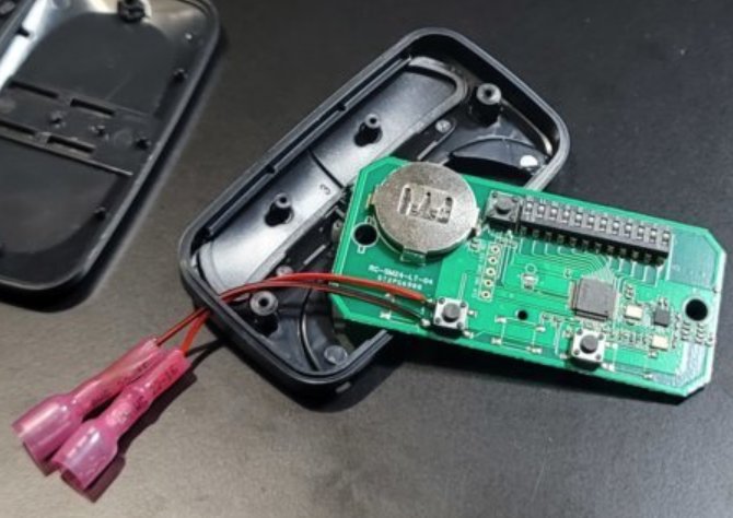

    I'm interested in knowing how you wired up your. I just finished a v2 of mine getting ready to add a 3 switch overhead panel with 2 button garage door remote.
    Soldered some wires so I can use the short style switch as well as still use the buttons on the remote itself if ever needed and used some quick connect/disconnect connectors if I never need to take it out for easy access.

    Very nice work/idea ... :burp:

    I didn’t get a good internal pic. This is another one I did on my Jeep which is why the button is a different color. It’s just a two wire momentary switch. I took the circuit board out of a existing remote and wired to the existing button contacts. I just taped over it for stability and then tucked it inside the console.

    Nice! Yeah not to different from what I did I just kept the original remote housing on mine and drilled a access hole through the side and ran the wires through it.

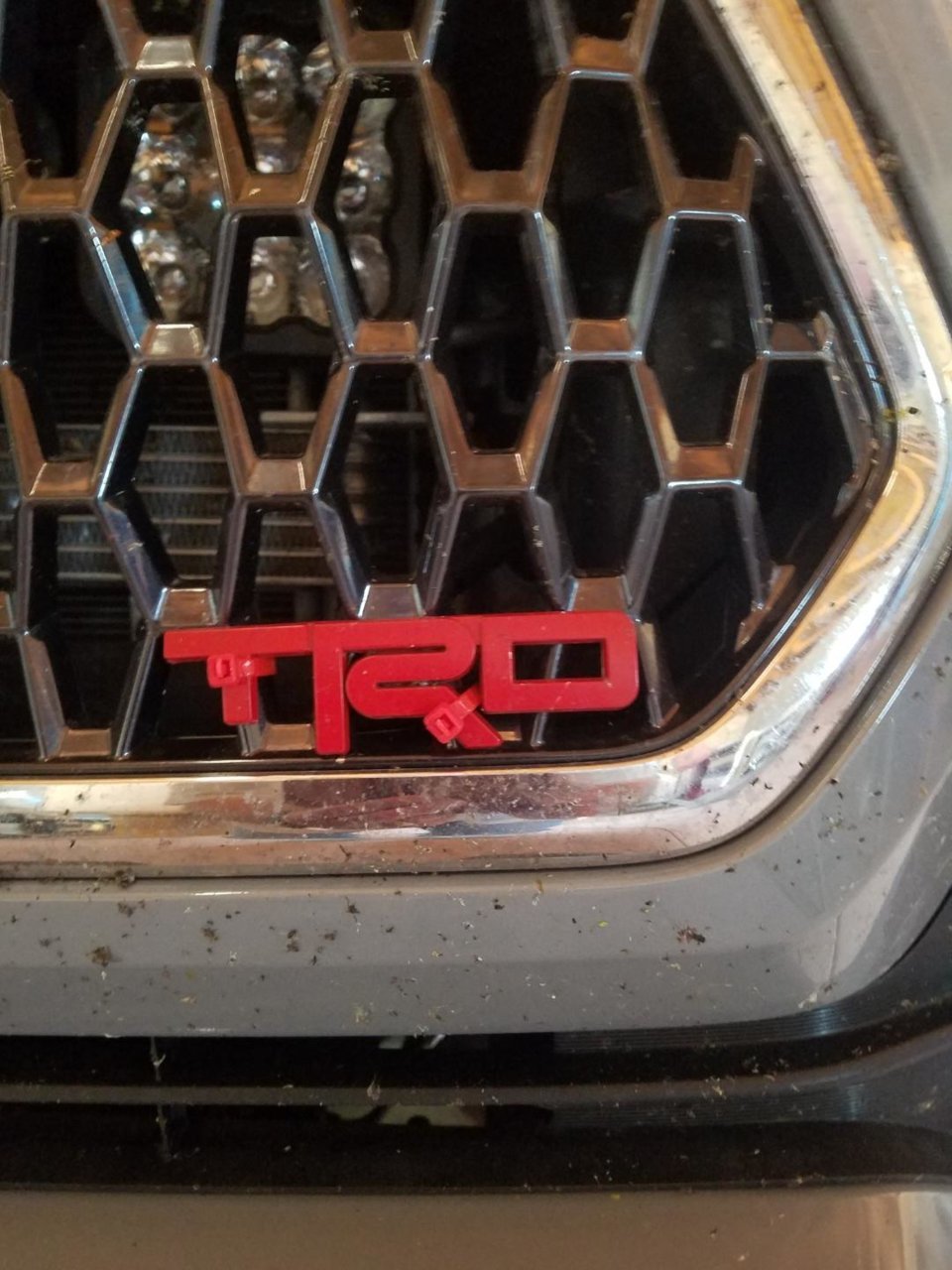

    finally broke down and bought some red zip ties to
    hold on the emblem. Cavalbluetaco told where to find

    Should have fastened them from behind so the buckle portion is hidden behind the emblem. not too hard to correct if you wanted to.

    true but was going to wait until I pulled off the grill to aim the driving lights
    have been unable to find time at night to do that
    but thanks for the info unless someone wants to volunteer LOL

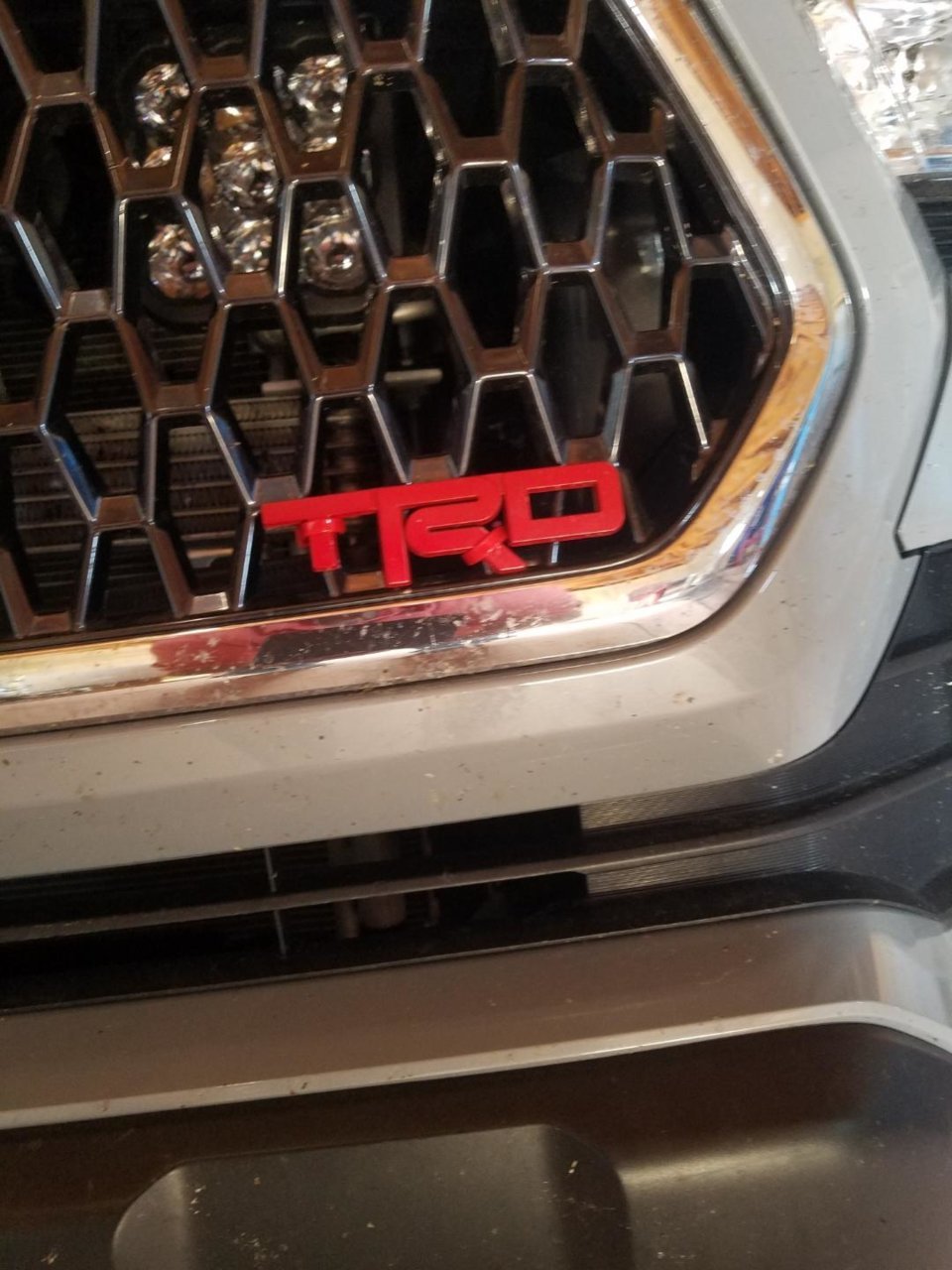

    @ tacotyusday was right and I finally pulled off the grill and corrected the issue LOL
    due to my light bar I have to take the grill off to do it. But it does look better

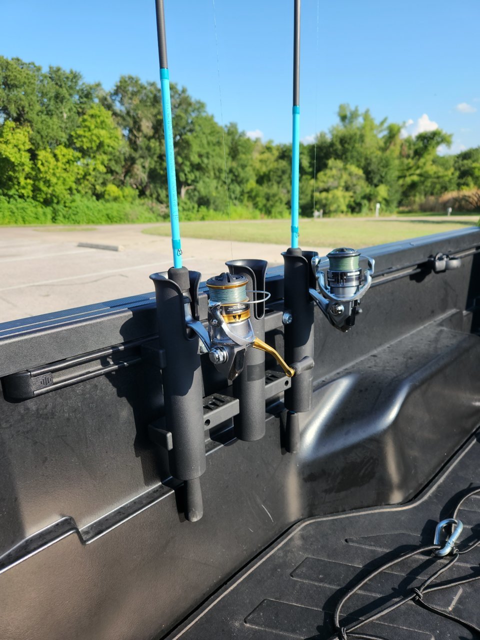

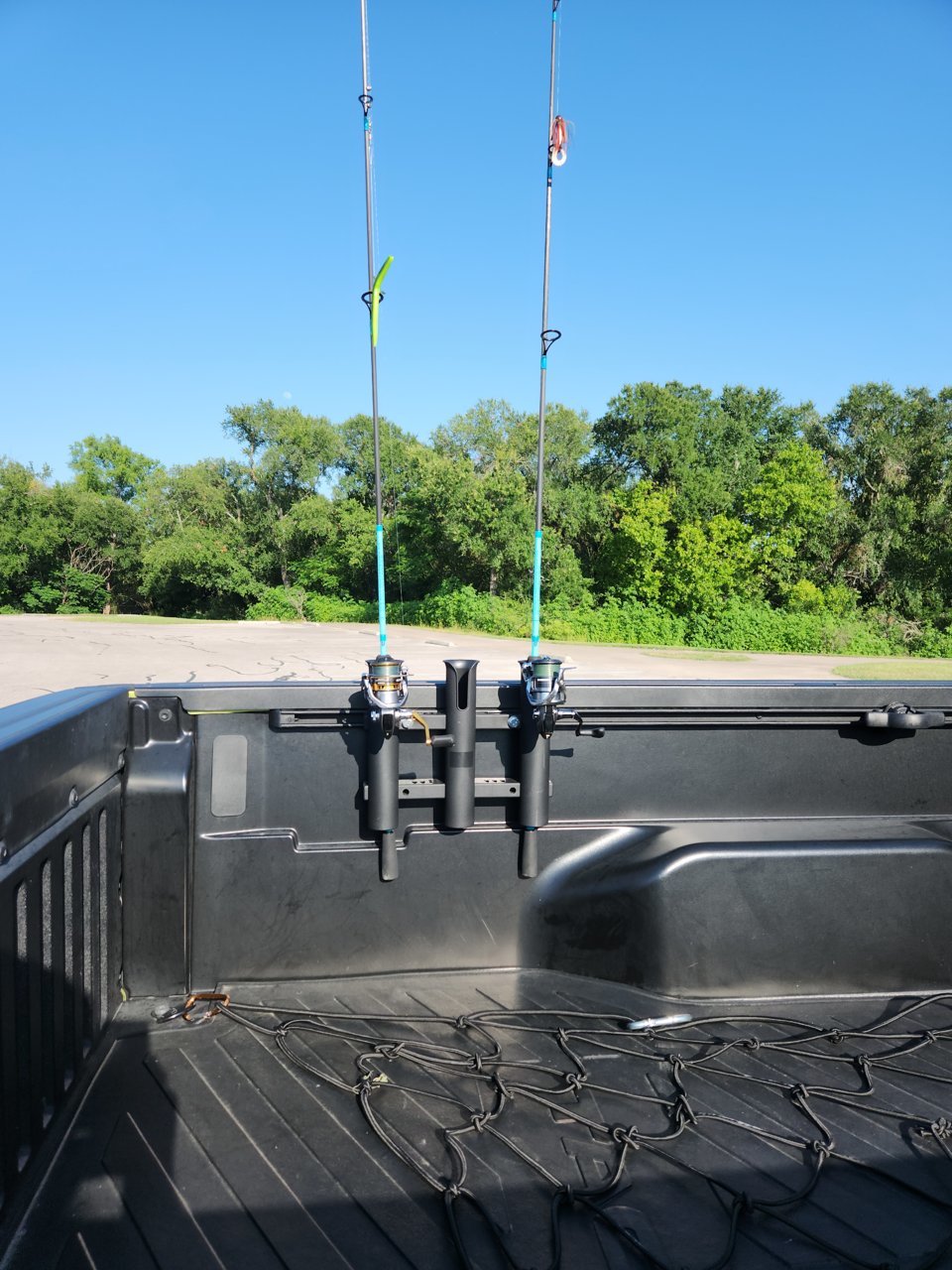

    Rail inserts + wall mount fishing rod holder + a bit of drilling to fit the bolts.

    This is quite clever! I like it!

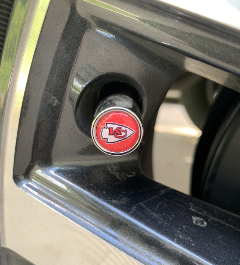

    I always have a list of cheap cool things I don’t need, so my kids have something they can afford to get me on my birthday, Christmas, and Fathers Day. Here’s one of my Father’s Day gifts.
