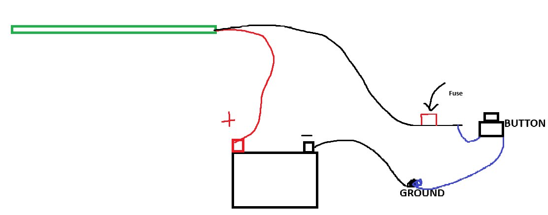

    I-85 Southbound
    2013 TRD Double Cab Sport
    It sure would be better than taking the sway bar off full time.
    BC Hunter likes this.
  2. May 8, 2024 at 3:46 PM
    #842
    bryan83taco
    bryan83taco Well-Known Member
    Jun 14, 2008
    #7321
