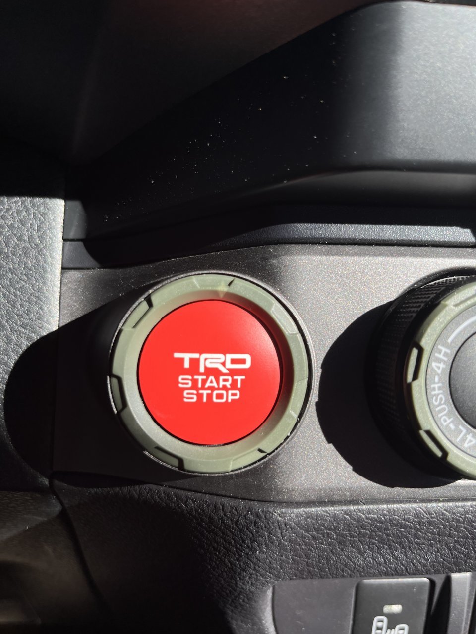

    Installed this start/stop button and outer ring from AJT Designs. Looks good!

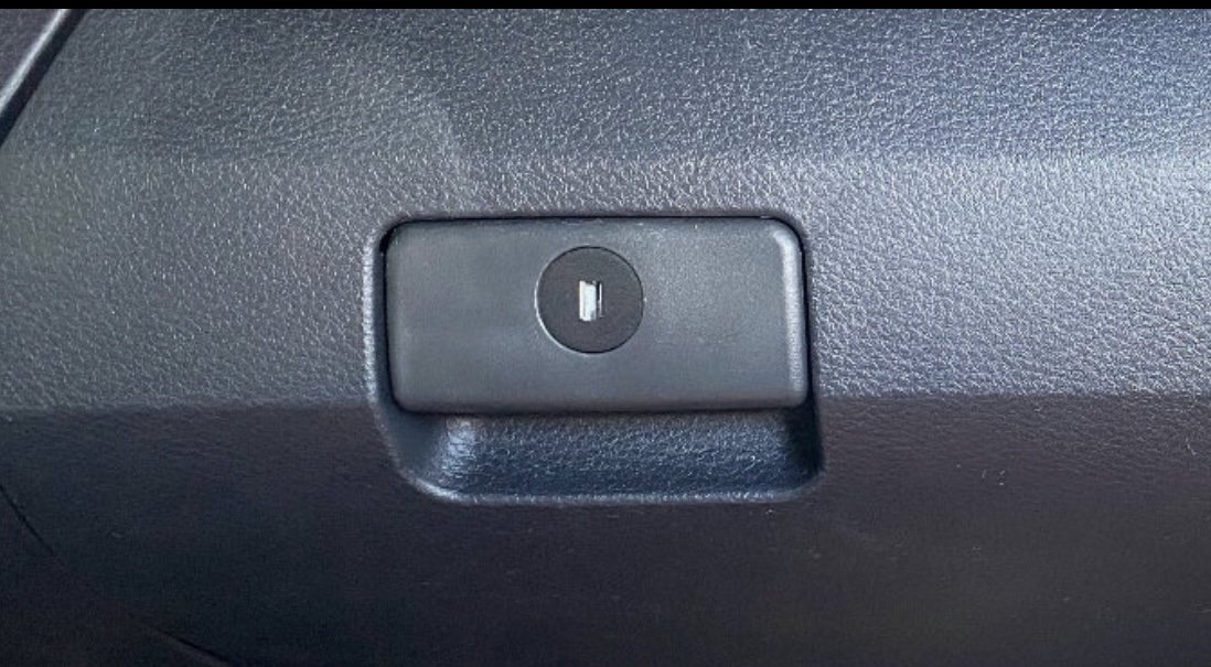

    My cheapest mod I’m most proud of. $4 I think. Hit the "Like" button if you can find it on the truck.

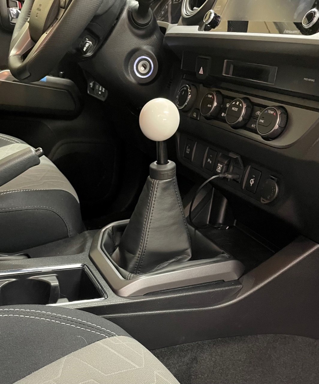

    I had posted this in the aftermarket shift knob thread. My shift knob is a $8 cue ball from an Amazon. I drilled a 15/32 hole about 1.5 inches deep and ‘tapped’ it with a m12 bolt. I then counter bored the hole with a 9/16 bit about 3/4 deep to clear the taper on shifter. The trd collar is from 7r41lbr34k3r.

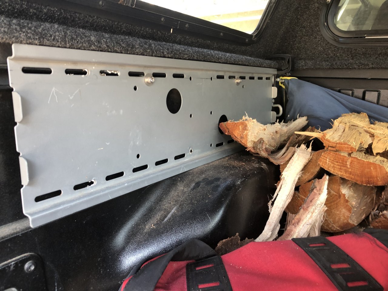

    Old TV bracket + t-nuts = “Molle Adjacent” hard points.
    One of these days I’ll actually get around to bolting something to it. Maybe!
