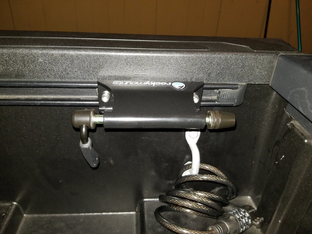

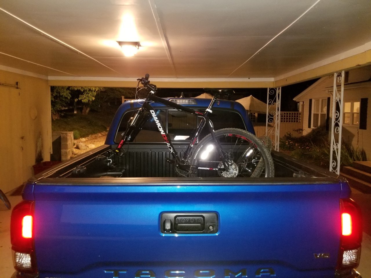

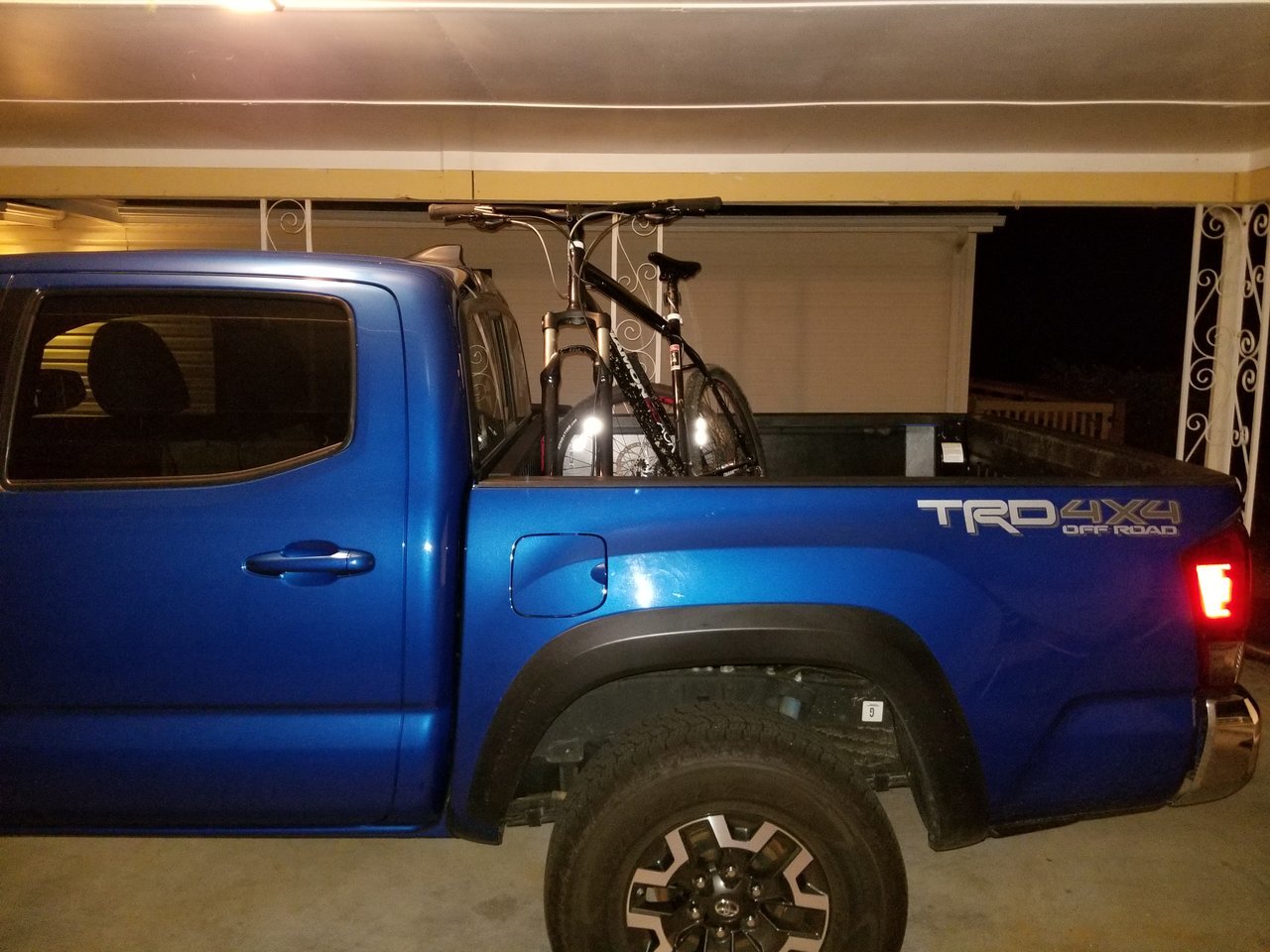

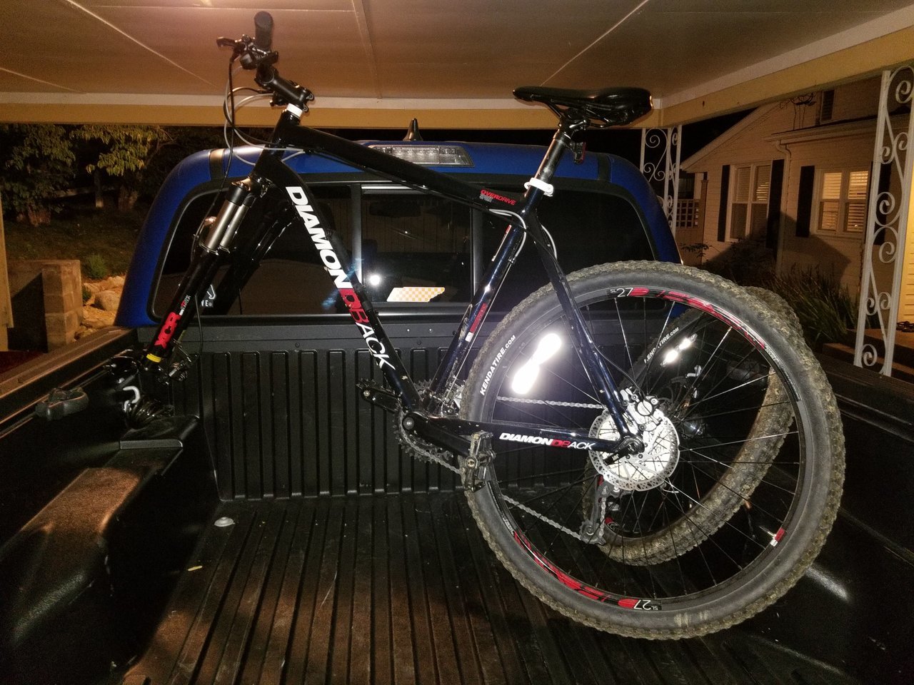

    I wanted a fork mount for my mountain bike. RockyMounts makes a great fork mount for the track system, but at $70 I wanted it to be cheaper. I was having trouble finding the exact pieces, so hopefully this will help someone.
    Here is what I used.
    Amazon:
    RockyMounts LoBall mount - $24.95
    Lowes:

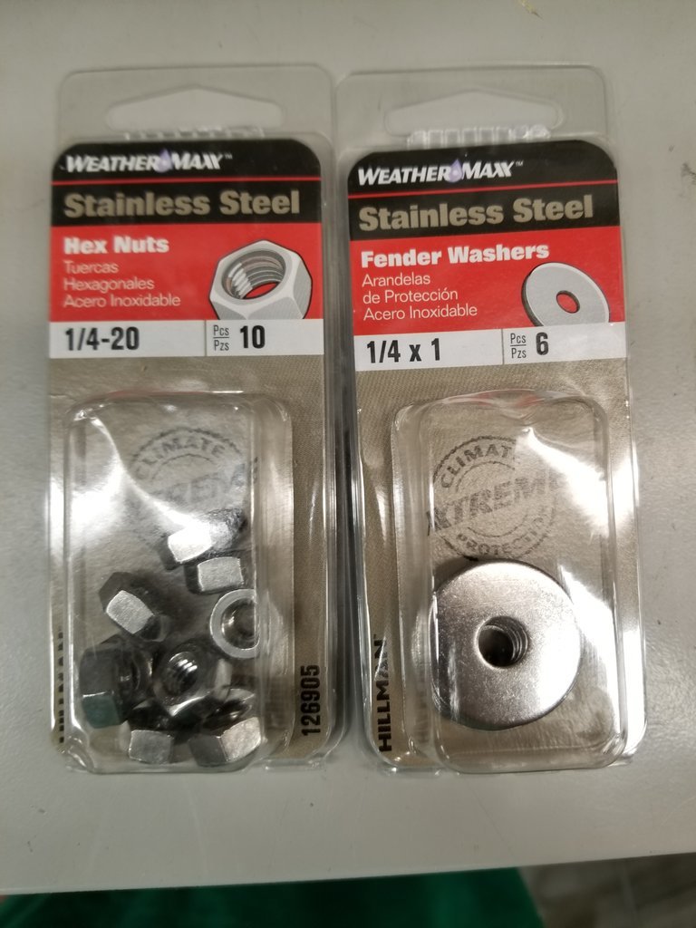

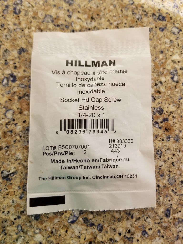

    Stainless socket head cap screws 1/4-20 x1 - $2.15ish (got it out of one of the hardware drawers) Stainless hex nuts 1/4-20 - $1.98
    Stainless fender washers 1/4x1 - $1.98
    I sprayed the washers with a coat of rubberized coating so they wouldn't stand out so much. I plan to buy a head rail track and mount it to the front at some point, but this will do for now. For around $30 I think its pretty hard to beat. Hope this helps someone.

    Yes, that's correct. I didn't need the locking skewer because I put my front wheel in the bed and lock them all down with a cable bike lock. I think they also sell the LoBall with locking skewer and no mounting hardware for around $50.

    How do you tighten that hardware? Is there space to get a wrench into the channel and keep the nut from spinning? Lowes sells the channel nuts in the electrical department that would fix this issue.
