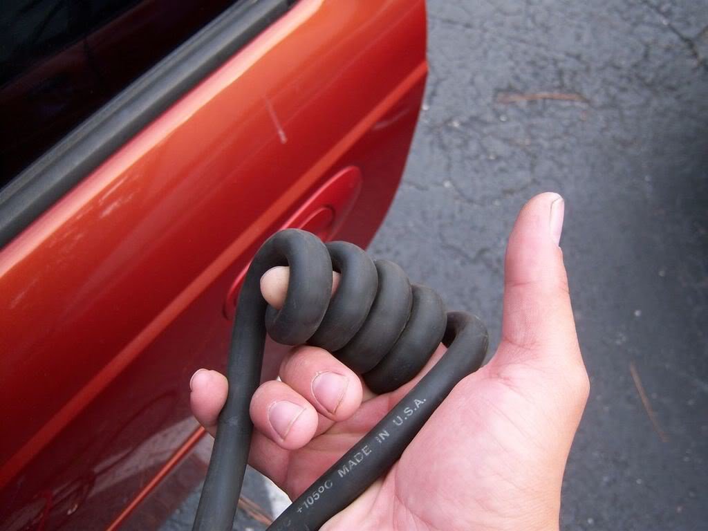

    The welding wire is actually really flexible

    Then never mind. The welding cable that I am used to is not nearly that flexable.

    alright, that's it. I'm using welding wire. Thanks for the help.

    yeah, I went with the ultra flex orange. I'm not exactly pleased with the appearance, but I don't care how a sound system looks. I'm all about function per $.
