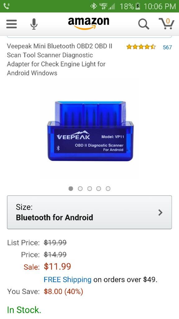

    Doesn't work for iPhone my understanding only for android. The $40 works with both on Bluetooth.

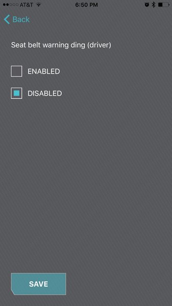

    Thanks, @Herminator. I just got Carista from Amazon and installed the free app on my iPhone. For $40 I was able check my codes. For the one time $20 I was able to customize a bunch of stuff, including seatbelt chime. Well worth it to me.

    Just got my OBDII sensor (cheap one from Amazon) plugged it in, ran the carista app.. disabled Seat Belt warnings, disabled panic button on the remote, turned signals onto 7 flashes, and turned on one button unlock all doors.. took me about 5 minutes and worked like a charm.. very happy with this result :)
