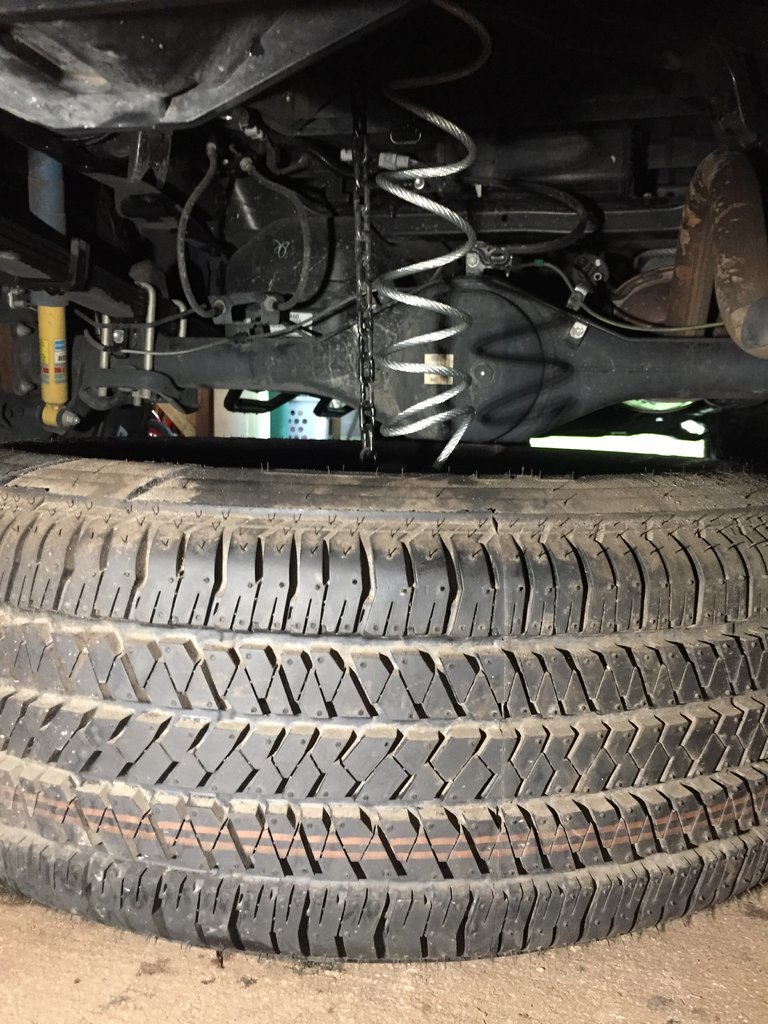

    A standard security exterior grade lock through the hoist chain links work just as well.

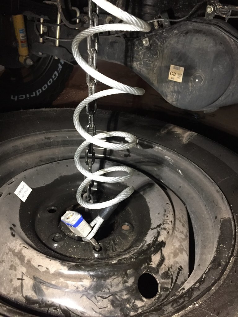

    Easier than trying to find a rim and tire when on the side of the freeway with your toddler & infant & wife. AAA or not, still something that'd take longer than turning a key.
    I turn a key every time I start my truck and enter my house, what's one more to make sure I have an essential piece of emergency equipment when I really need it.
    But to each their own, float along until you're a victim. This post wasn't to call out fear mongering, just to raise awareness to people who don't like major inconveniences that they might not expect while doing something as simple as changing a flat. In my opinion, it's a minor inconvenience.
    To your point, that's a much simpler solution, didn't think of that! Simple and effective, +1 for the KISS method!

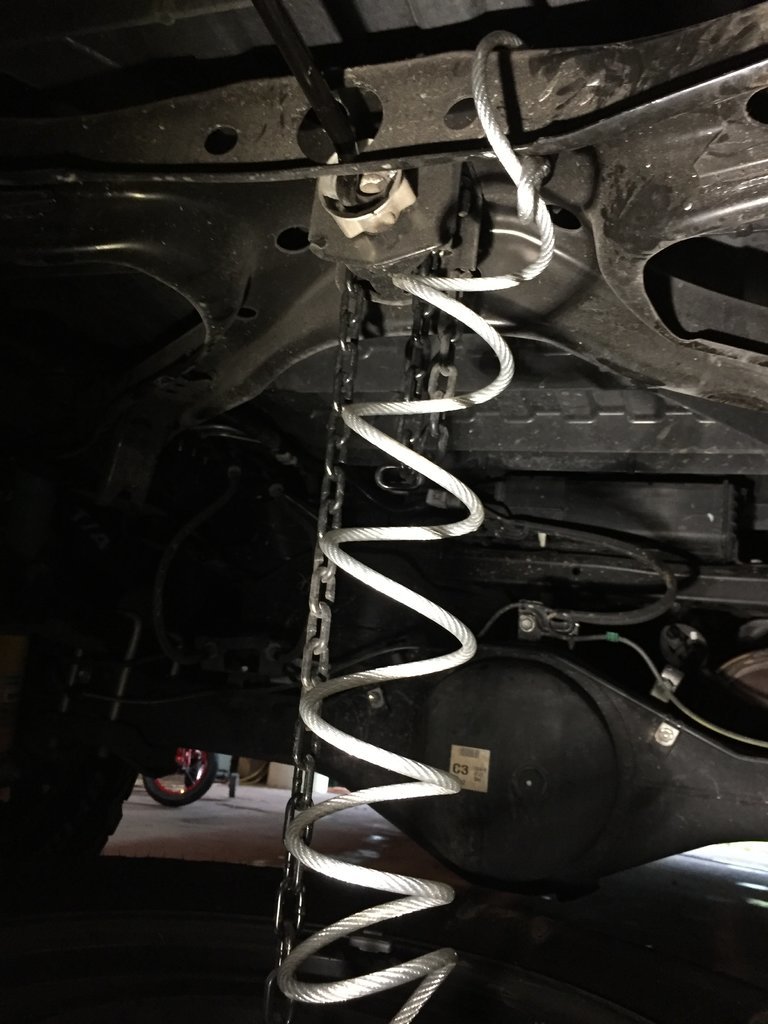

    So, what happens when some crackhead lowers the spare, see's the cable, gives up, and you back up over the spare?

    Cool idea, but I foresee agony on the side of the road when your trying to chew through a braided cable with your teeth after your lock is corroded and unlock-able.

    Then use @Jimmyh 's method, and lock the lowering chain to the lug hole, then even if it's lowered it's not hanging too low to cause an issue. I myself might revise my setup to do it this way.
    Then jamb a shit-ton (or cubic butload) of grease in that lock and deal with a greasy key when the time comes.
