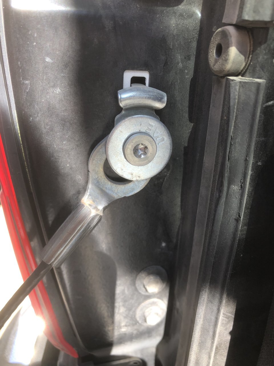

    Sorry to say, a thief with a screwdriver can simply pry a hoseclamp up until it snaps in less than 10 seconds, less time it takes to simply unscrew it. Try it!
    They are not a good theft deterrent and at least one member here lost a tailgate with a hose clamp on it.
    If you want to use a hose clamp, at least put washers over the cable eye bolts so the cables are not easy to slip off. Put a nylon spacer behind the washer to let the cable eye rotate when you tighten the bolt.
    But it’s going to take a hefty lock like a Sabellco to really keep a tailgate safe, especially an unlocked one.

    I'd personally just get like a torx screw and round the outside of it. That way it literally can only be taken off with the right torx bit which not as many people have on them. Make it a little harder to get it off fast

    Seems like a good idea, but a regular screwdriver will easily beat it. See posts #40 and #51.
