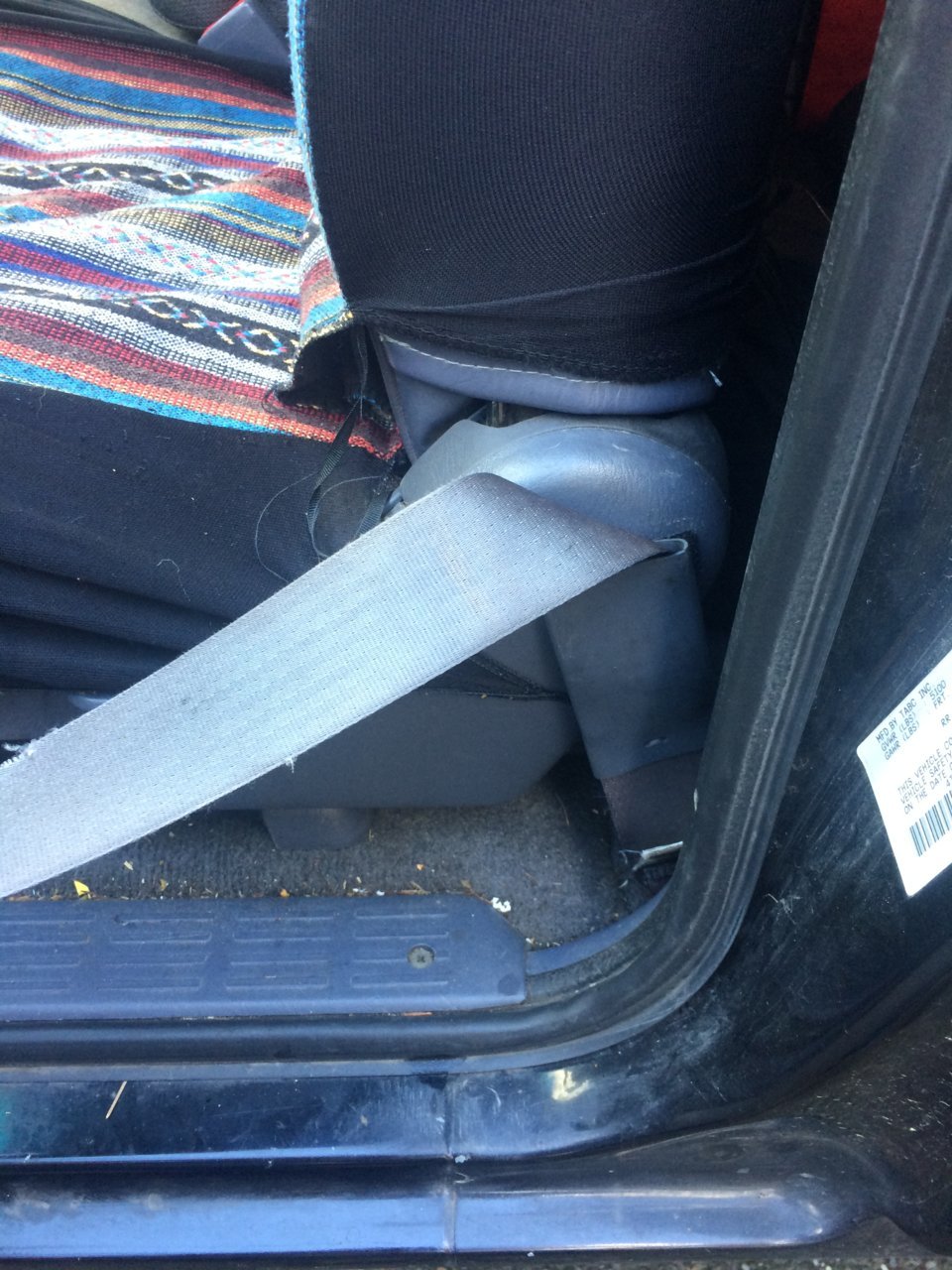

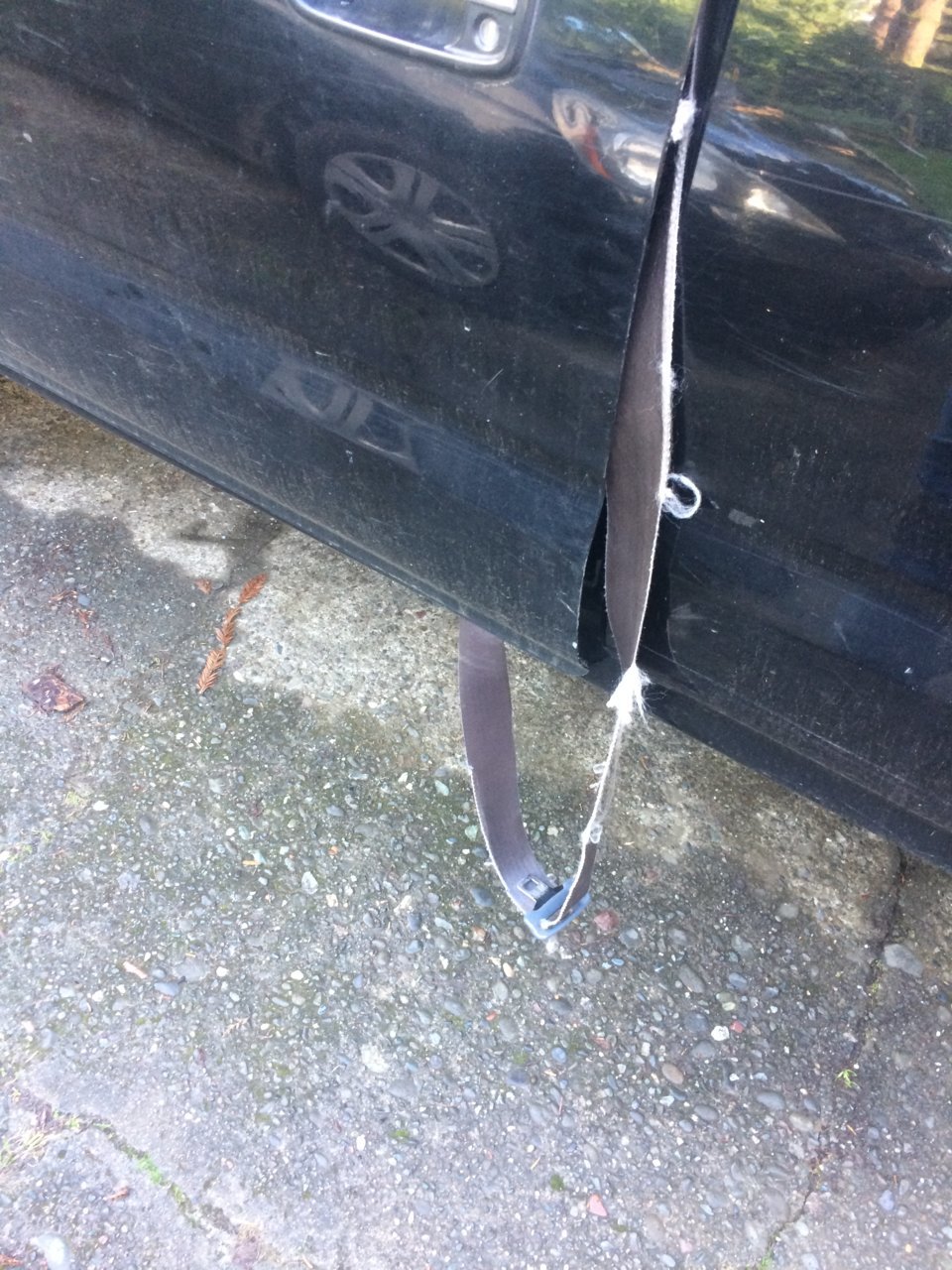

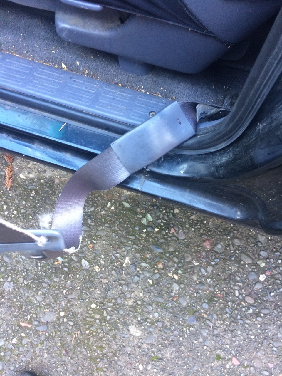

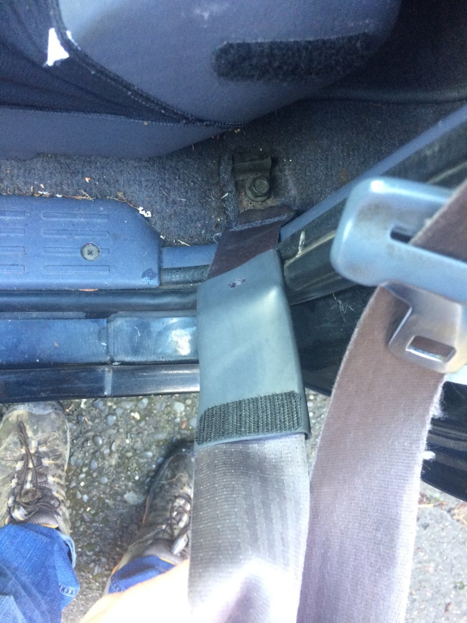

    You basically just throw some adhesive velcro where the plastic at the base of the seat belt touches the plastic on the side of the seat. Make sure to clean any dust or dirt off first then i used rubbing alcohol to get a good clean base for the adhesive velcro to stick on. at the end it took maybe 5 minutes maybe $1 worth of material and it wont 100% fix the seat belt getting caught in the door due to a weak or dirty retractor but id say this has eliminated 80-90% of my seat belt getting caught issues.image1 (5).jpg image2 (3).jpg image3 (3).jpg image1 (6).jpg

    You should think about a new belt,that thing looks worn out.

    yeah definitely on the list but i'm just hesitant to spend $200 dollars on something so boring as a seat belt even though its a safety item maybe with my tax return.

    yeah that would be a good idea to tighten it but this method seems to have fixed most of my seat belt getting stuck in the door issues and im planning on just replacing the belt at some point so I don't want to go through all the hassle of cleaning and tightening the belt just to replace it but that looks like a more legit way to go if the seat belt is still in good shape.
