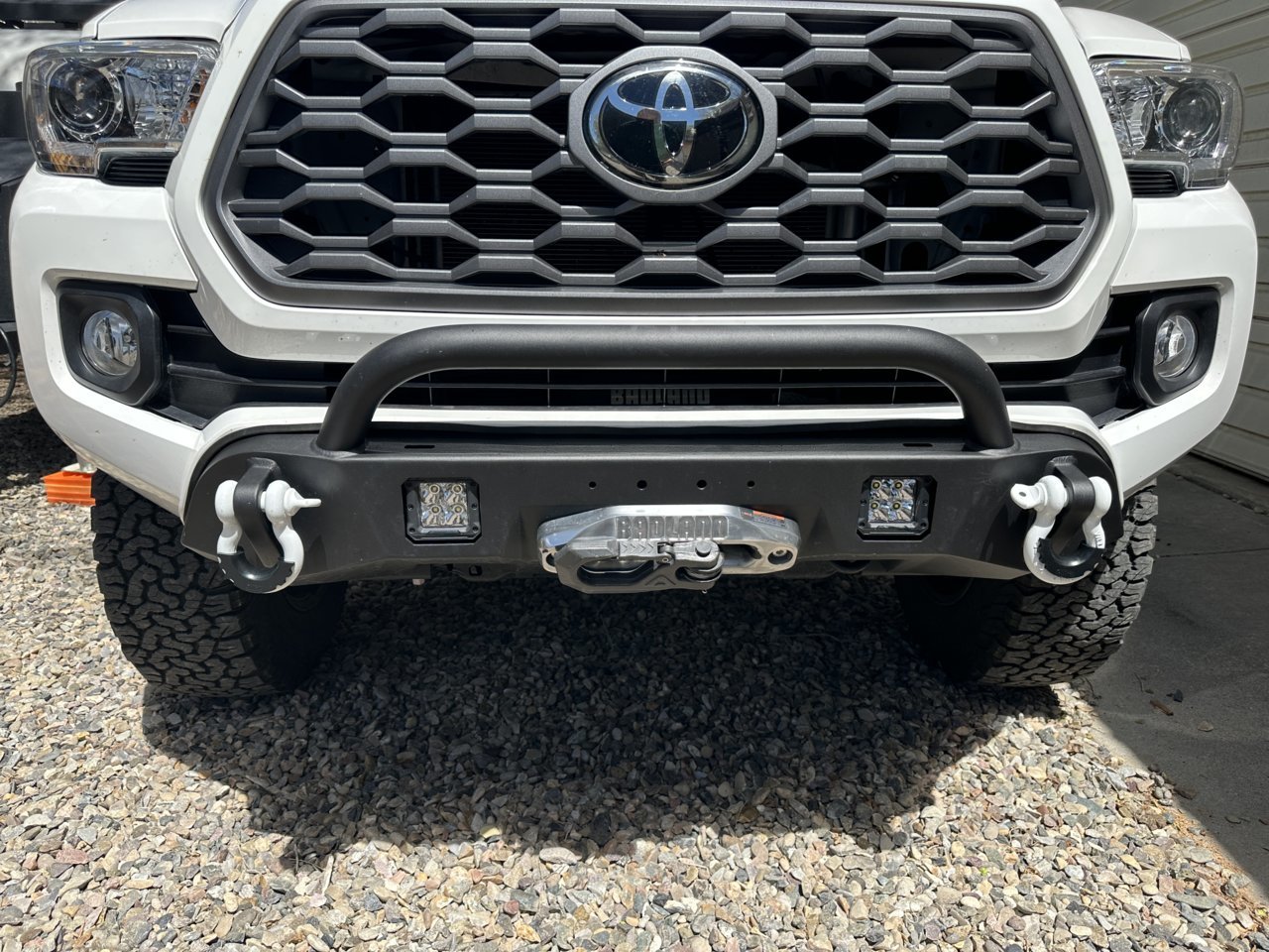

    @PanzerDivisionBlack, as others have stated you have nowhere to attach shackles on a stock Taco. If you like the look of shackles you will need to invest in a bumper with recovery points. Mine is a 4WP bumper with a pair of Napa 2x2 Spot Lights and a Harbor Freight Badlands Apex winch. The bumper alone was $700 if I remember correctly. That is a lot of money/work just for the look of a couple of shackles.
    I bought a pair of Rhino 20 Ton, 3/4 in shackles for $27.90 off Amazon. I went with these so I wouldn't be heartbroken if some dope stole them. They feel every bit as solid as any of my other shackles although I have not used them for recovery. I'm usually the one winching others / dragging cars around my yard and for that I use the winch and some Harbor Freight soft shackles.
    My recommendation: if you are really concerned about recovery, buy two soft shackles and a 4 in x 8 foot Badlands tree protector. Put the soft shackles around your lower control arms a rated recovery point then thread the tree protector through the soft shackles and attach that to the rope your rescue vehicle is using (a kinetic yankum type rope).

    I would not suggest wrapping anything around your LCA.

    Solid call. I was thinking of point loads for most of my use cases - LCAs are fine for what I do: level ground and old cars that need to be repositioned in the yard. Always shackle around a rated recovery point.

    are you saying that as 'all the time', or you're suggesting the LCA isn't a strong enough recovery point at all?

    no. tiedown only.

    Your LCA should not be used as a recovery point.
