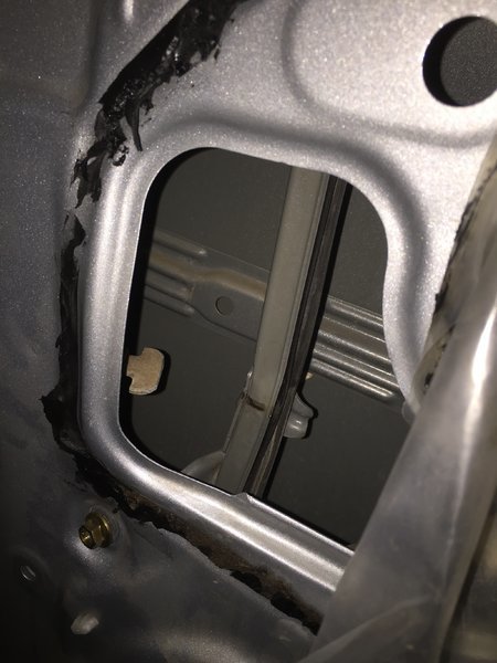

    image.jpg Hi, I have an 05 double cab Tacoma and recently had an incident with my passenger front door where the wind over extended it. For a while the door was making a snapping noise and had trouble closing. The window would only go down halfway. I finally decided to take the panel off and check once and for all what the problem was, I noticed the check arm had bent slightly which caused the window slide guide(I'm not sure what the proper name for that part is) to bend as well which is why the window won't fully descend. Can I buy that specific part or do I have to buy the entire window rotary assembly? I've been trying to look for the part but have had no luck finding it. Thanks in advance!

    You should be able to buy each part separately. Go to the dealer and get the part and or the part number.
    You need to replace that door check also.

    I'll be doing that first thing Monday. Thanks for the hell, appreciate it!
