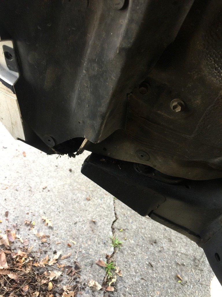

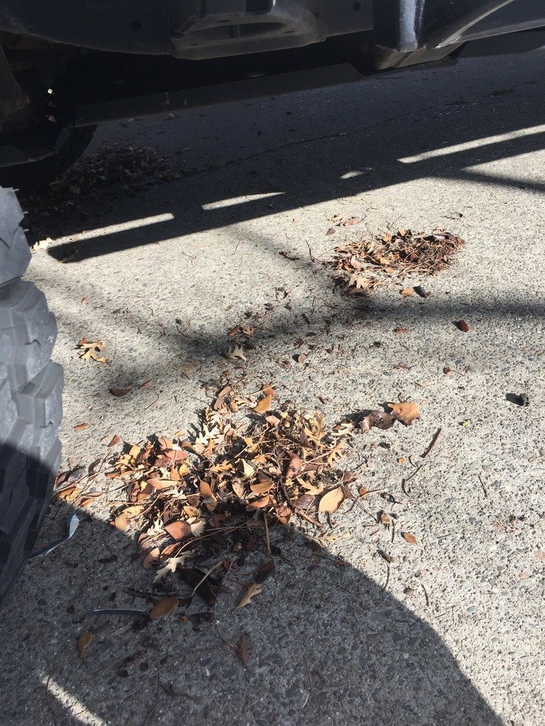

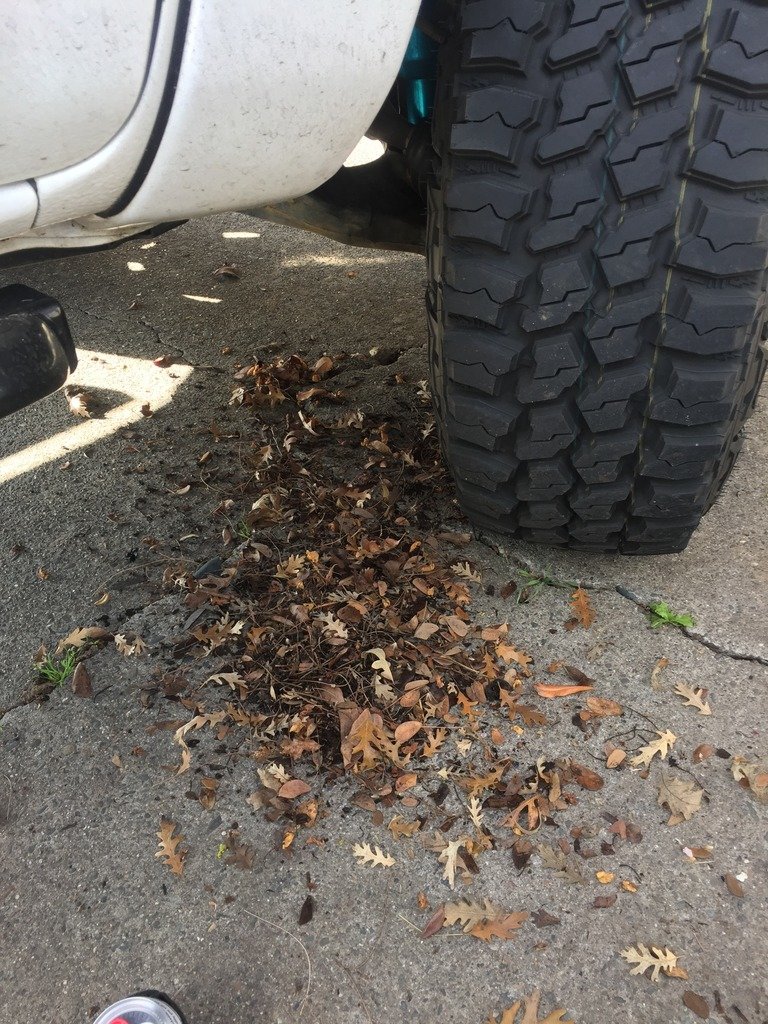

    Just an FYI, to help prevent fender/rocker rust down the road. Just trimmed my fender liners and all this shit starting falling out. Started to poke around with a long screwdriver and ALL this came out each side. Most of it was all soggy wet leaves and crap. I guess abunch of it falls down through the cowl and engine bay as well.

    Yup. You can access this area from inside the door frame at the bottom of the fender. There is a black plastic trim piece you can pull out of the way to gain access to all this crap.
    When ever I vacuum my interior, Ill suck all the dirt out from the inner fender via the trim piece in the door frame.

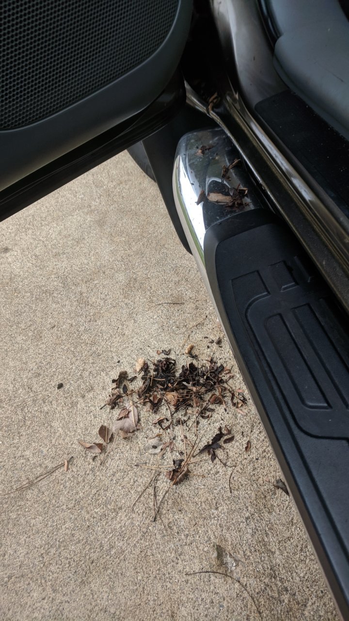

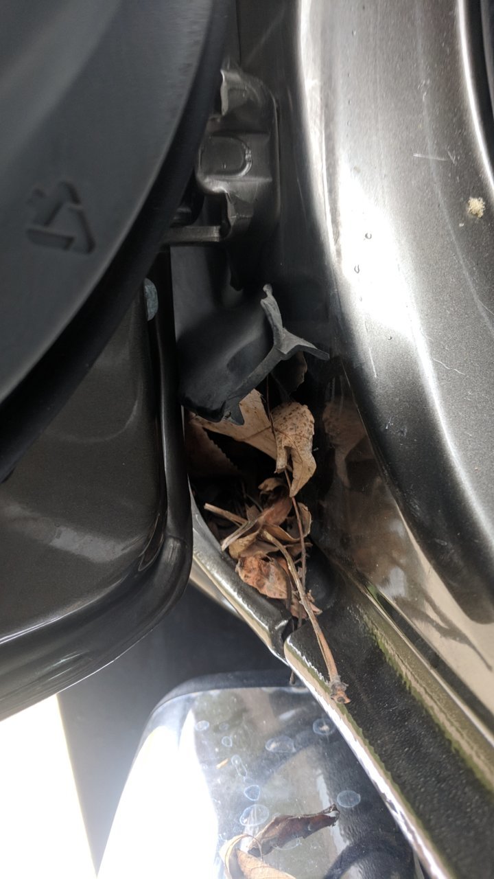

    No joke, just bought a 2013 DC and saw some leaves sticking out bottom of fender when getting out of my truck today....what a mess for someone who never noticed it and cleans it.

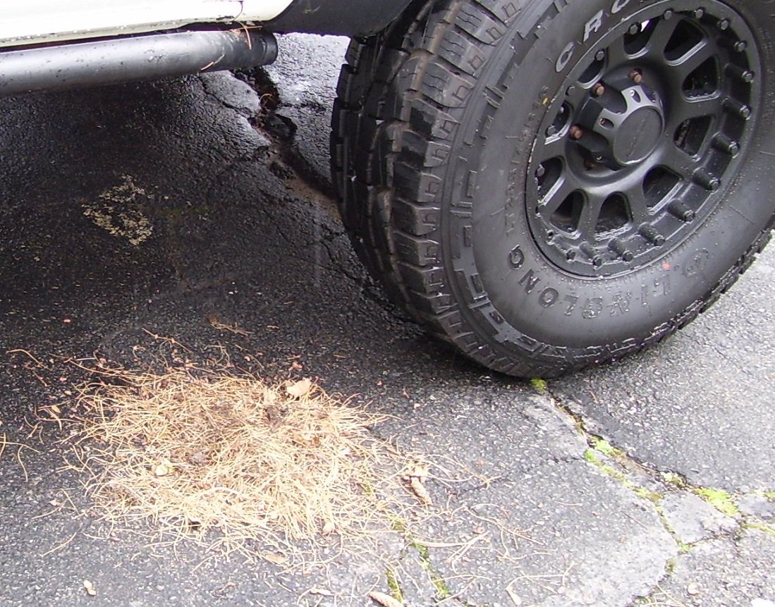

    I found a bunch of dead pine needles and lots of dirt/mud. You also want to check your cowl area, mine was packed with needles there as well.
