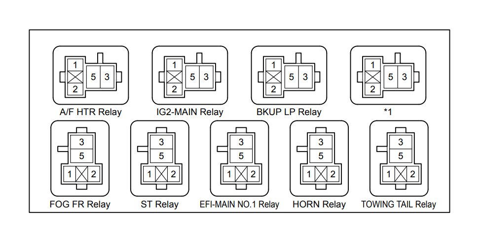

    Under the hood in the fuse box, there will be a relay labeled - ST Relay.
    Pull the relay, and check Pins 1 and 5 for power with the key in the cranking position. (The truck will not crank with the relay out.)

    Thanks. I will check that in the morning. Does ST relay stand for start relay?

    Yes, that is the Starter relay.

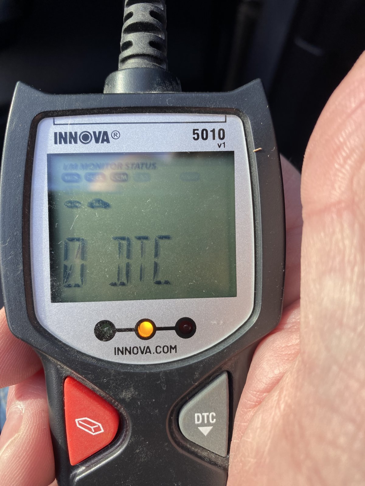

    Getting about 11.6 volts between pin 1 and pin 5. I swapped the FOG FR relay with the ST relay after verifying they are the same p/n. Same symptoms. Swapped relays back. I forgot to post that I tried my OBD code reader. 0 DTC.IMG_2430.jpg

    Each pin should have 12v (battery voltage)
    DO NOT check between each pin.
    Black lead to ground, Red lead to pin 5
    Black lead to ground, Red lead to pin 1
