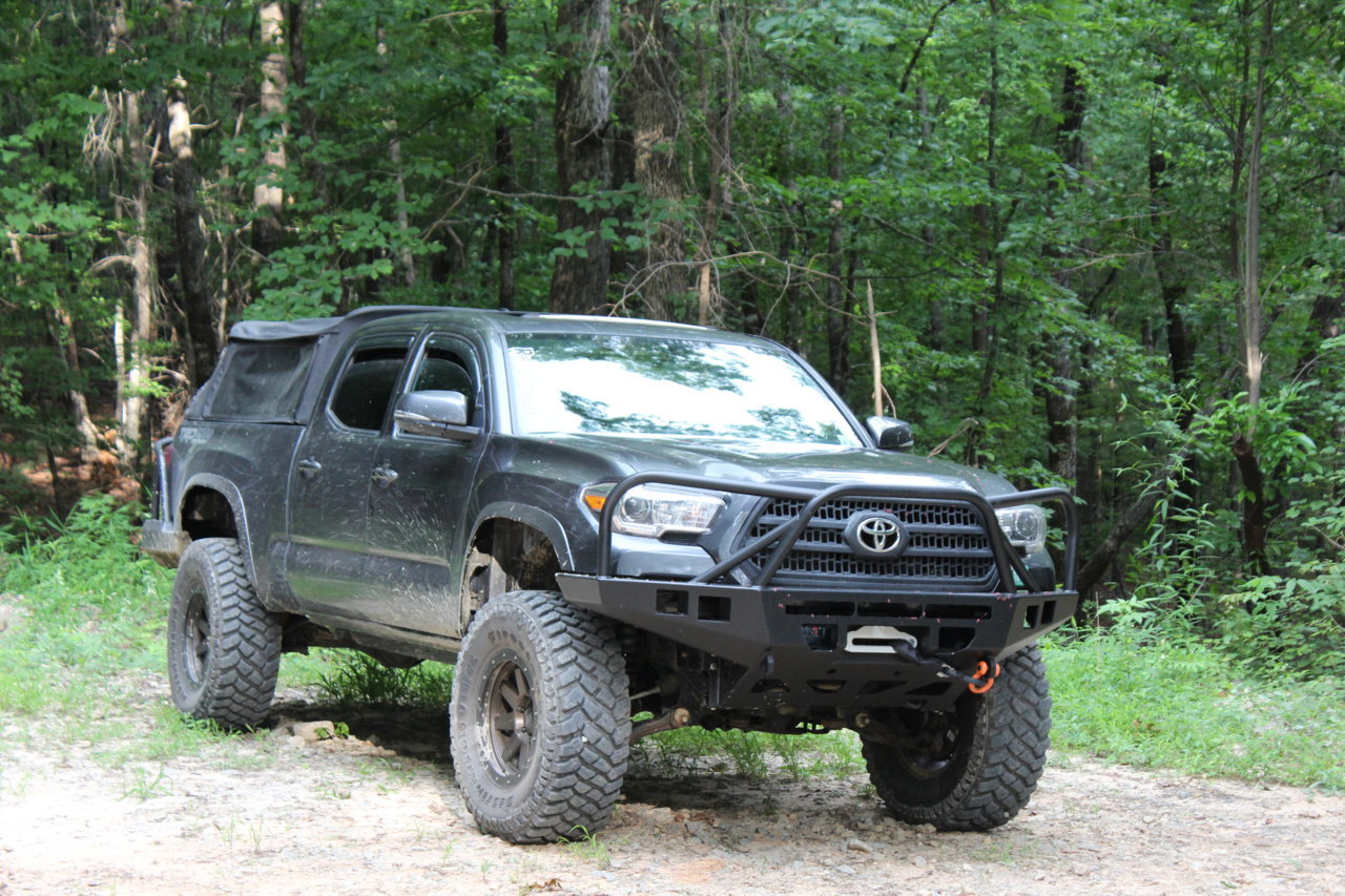

    Your picture shows 2017....why is it void of all warranties?

    Yea just a few mods lol. It's gotten enough water around the engine Toyota just laughs when I take it to them and ask if broken things are covered. Something about improper use and abuse. I always argue that its a Tacoma but no dealer wants to hear it. Definitely need to get to a parts store
