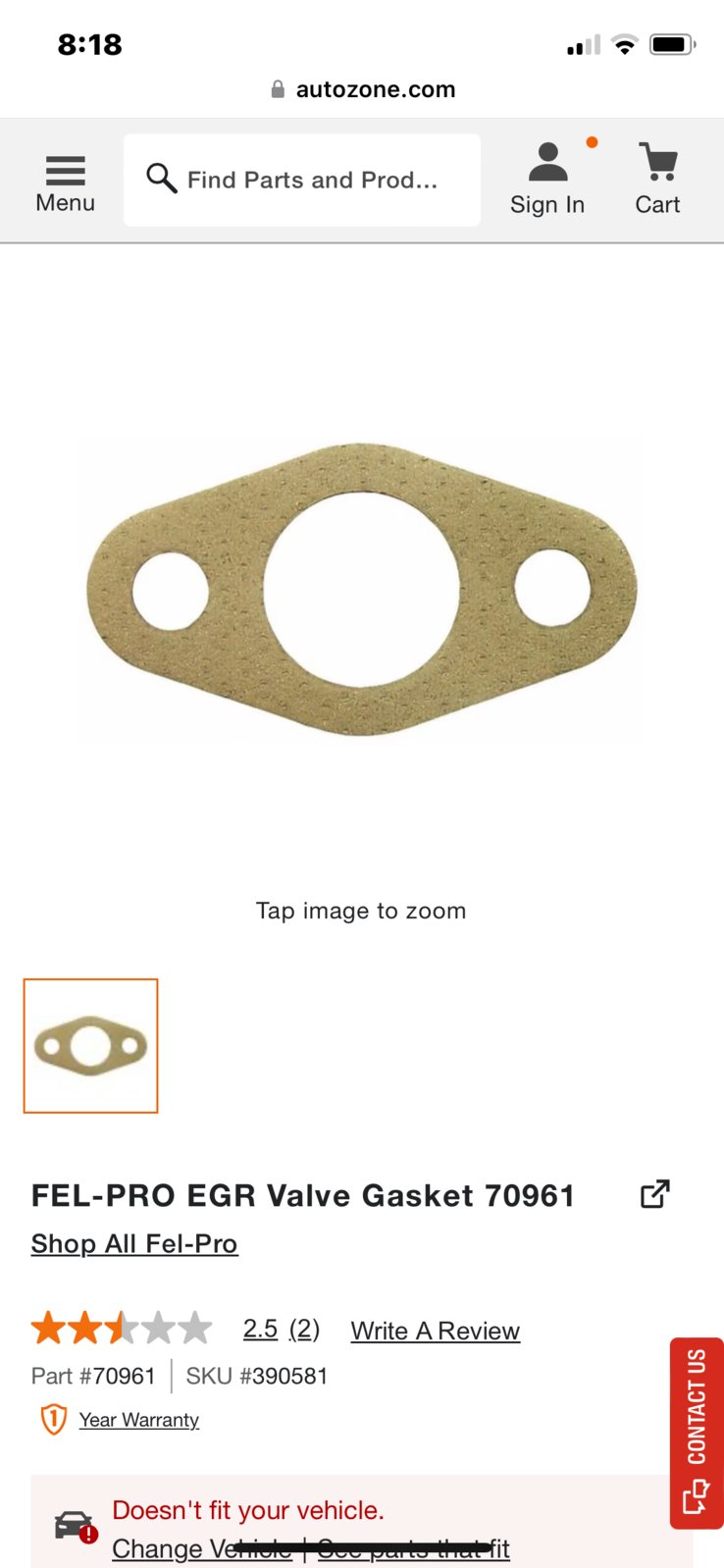

    thanks for the reply. Do you think I could get away with just cleaning the pipe so as to not take off the valve and have to replace the gasket? Or can the valve be cleaned as well? Thanks again.

    Possible bc u have 04
    Mine was 96…..the gasket came apart in 4 separate parts !
    I would replace gasket or have one on hand just in case
    I bought one from autozone $4

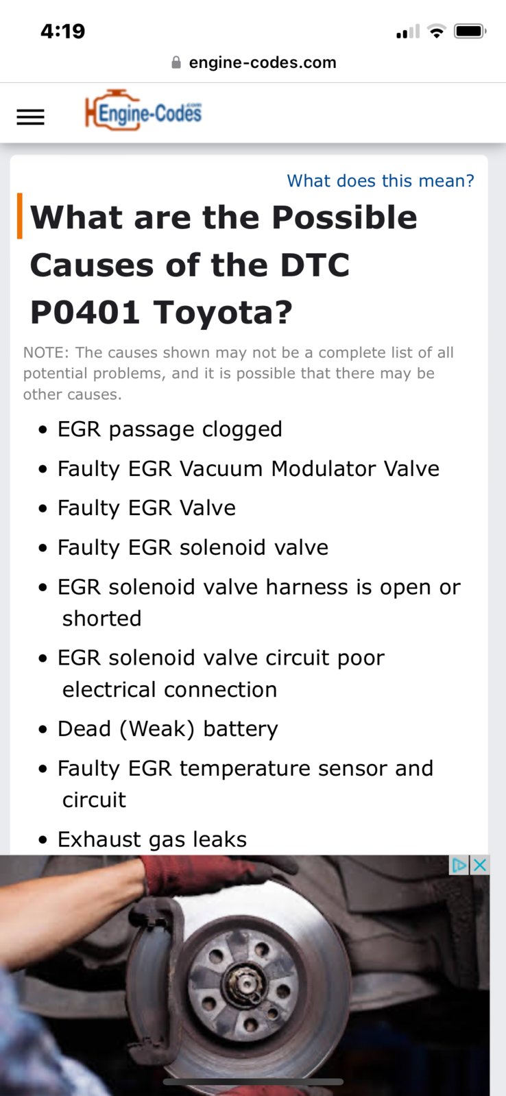

    Here's the troubleshooting procedures

    Clean the passages
    See if the valve diaphragm will hold vacuum and open when vacuum is applied
    Make sure the solenoid valve that opens and gives vacuum to the entire system is working properly

    It’s a three-piece gasket, correct? There’s the one for the valve, and then the two ends of the pipe?
  14. Feb 5, 2024 at 6:19 PM
    ControlCar
    ControlCar My Moto: Help & Learn…period.
    Jul 22, 2023
    #429578
    3,601
    Steven
    Sugar Land TX
    1996 Taco 2.4L 2wd Automatic
    Clock Volt meter/LSPV Delete/Hyundai 16’s/FP gauge/after 9months of wrenching ZERO oil leaks
    2 of these:

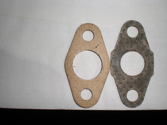

    Yep there is three all together.....
    the ones I got at the parts store were too small.
    I had to order the oem's to get correct fit....
    I even replaced the steel tube with a Dorman one......which was completely unnecessary...
    the pcv port and the temp sensor passage going into the intake manifold was what was gummed up....... about half carboned up.....at 140K.

    u know what, i just remembered having to use a file to modify the felpro gasket to fit(metal in center of gasket material)

    yeah @ O’Silver_Taco above said he went to buy OEM because of that. I’m assuming he went to the dealer. They want $18 for each gasket though here.
    Not sure what to do.
    I got the two felpro gaskets for the pipe from Orielly. I’m gonna pull the pipe off and check to see if there’s any blockage from end to end. if there is, done.
    If not, then I’m going to proceed to takeoff the EGR valve and go from there.
