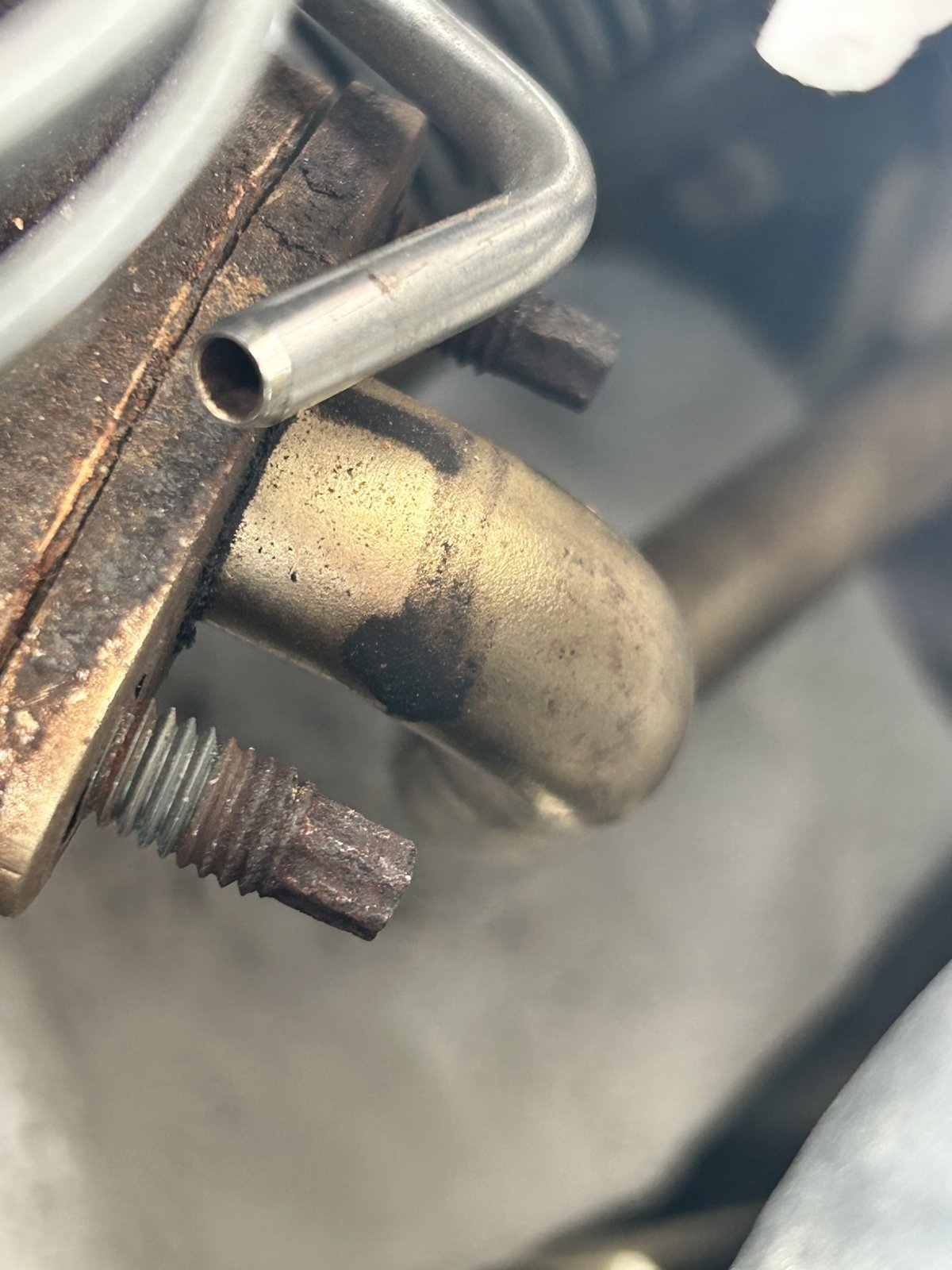

    These are my two studs. a small 7/32nd deep dish socket fits snug on there. Do you think I should use that? Feels solid.

    #429578
    3,601
    Steven
    Sugar Land TX
    1996 Taco 2.4L 2wd Automatic
    Clock Volt meter/LSPV Delete/Hyundai 16’s/FP gauge/after 9months of wrenching ZERO oil leaks
    Yep
    That is the situation
    Moving that pipe back enough (without damaging) and getting 1inch of clearance to replace gasket

    so you opted to remove the bracket on the pipe versus removing the studs like control car dead.
    What type of head is on top of those studs? is the stud threading the same as the nuts?
    thanks boss.

    ^^^IMO the studs have a star pattern(rusty)
    very possible that stud screws into the valve body itself
    (unknown though)
    figure that would be more of a PITA to get out or possibly strip the threads thou
