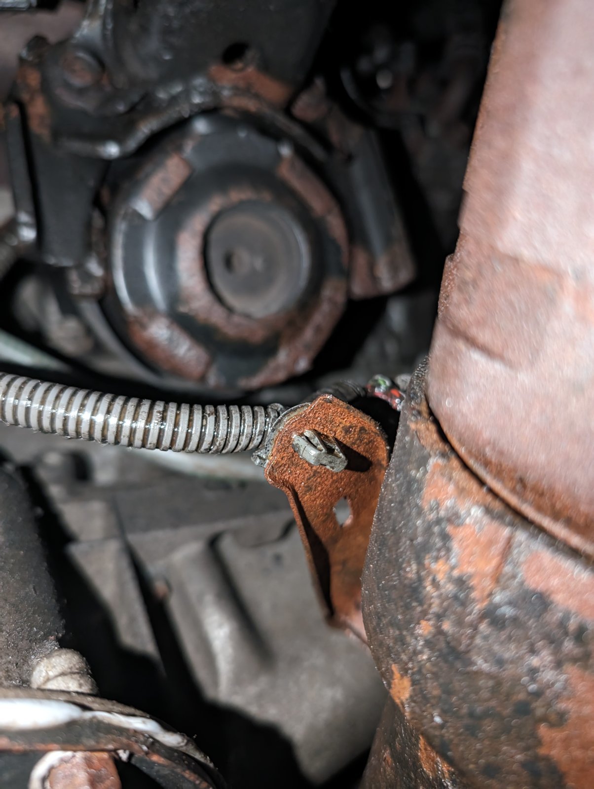

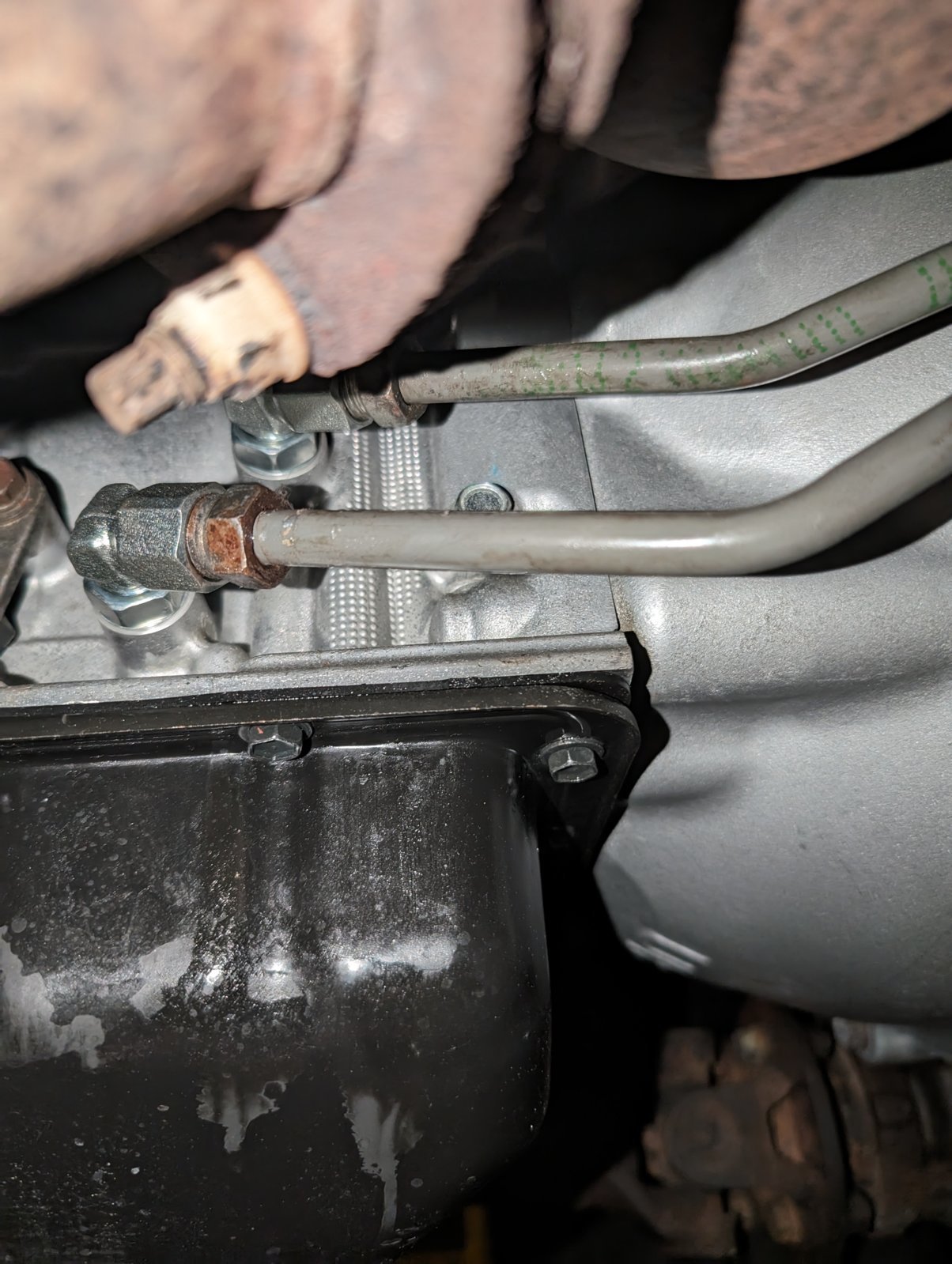

    First time driving the truck after getting it back from the dealer I slid a tiny bit on some ice, nothing serious at all but abs kicked on briefly. After that my check engine light and slip indicator light turned on. Read the codes and I got P0456 and P0430. I replaced my gas cap because it needed replaced. Cleared the codes because it ran good and my catalytic converter didn't seem to be having problems. Today (5 days since I got it back from the dealer) while leaving work I noticed a puddle of fluid under the truck. Looked like oil. I drove home and the check engine light and slip indicator light came back on. I checked my oil after driving 40 miles home and it doesn't appear I lost any oil. I noticed new noises as well ever since I got the truck back, mainly when I make sharper turns like when pulling in to parking lots I hear some sort of soft thud. I checked my cv joints and they appear dry and undamaged. I also hear a weird clicking sound when driving highway speeds. IntermiPXL_20240118_090858391.jpg PXL_20240118_090842845.jpg ttent and quiet. But a new sound. I got under the truck and noticed some slickness on some of the lines that move around the transmission (the new one they just installed).PXL_20240118_090858391.jpg
    It's hard to see in the photos but the pictured lines are covered in what appears to be oil. Ultimately I don't know what this fluid is. I don't think it's transmission fluid. I'm also not so sure it's engine oil however it looks more like fairly clean engine oil, soft brown. The performance of the truck seems unaffected right now.
