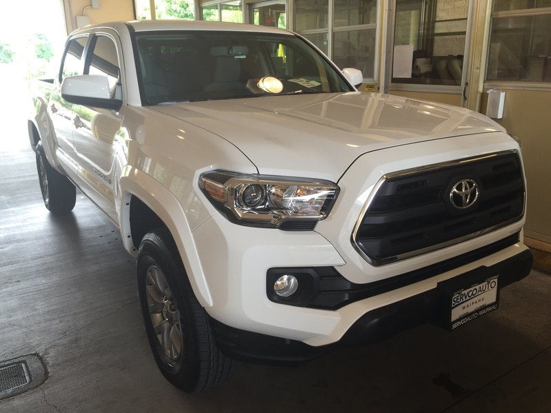

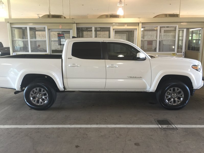

    my replacement truck arrived today. still unsure what the problem was. got to see my original tacoma and had a bunch of engine parts on the rear seats so they must of been doing a lot of work to try and figure out the problem. sales guy said it might be the same problems as the lexus is250 with the carbon build up. unsure how accurate that info was since it came from a sales guy and not the mechanic.
