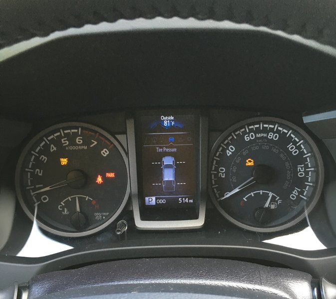

check engine and trac off light

    They said it was a loose wire and tested and it's good now.I'll see when I drive it some more

    that code popped up again. so i took your advice and called Toyota Corp. waiting on a response. I am going to mention that its brand new truck and shouldnt have this problem, hopefully they give me extended warranty.

    I had the Trac Off and Check Engine lights come on today. Trac Off light was intermittently on and the Check Engine light was solidly lit. Took it in to the dealer and they said it was showing error code P0455 "Evaporative Emissions Leak". They found no leaks and cleared the codes. I checked the gas cap before taking it to the dealer, but they said it could take a day for the lights to turn off once the gas cap is properly screwed on.

    Was driving mine today Trac off light came on and CEL took it into the dealer apparently mine needs a new 02 sensor so it goes back in, in 2 days

    Called Stevenson Toyota West at Lakewood, CO. Service Advisor (JoAllen) told me to bring a truck for service. They run the test(Gary)and result was 2 Evap Code P0455 and 430 for gross leaks. They use scan tool. System passed! They think cap was loose previous. Warning light's are gone! This is full tank from time i purchased the truck...Thank You Julie Sand for taking care of my truck, Stevenson Service rock's!!!

    Dam, just got this problem today along with loud clanking noises and hard engagement when shifting into Park, Reverse & Drive. Brought it to the dealer. I'll update as soon as I find out wtf is going on.

    Uluahunta - Any update on your truck? Mine is experiencing the same problems with the Trac and CEL. Popping noise backing out of the driveway. Getting ready to have mine towed to the dealer tomorrow. Thanks...

    4XO - At first they thought it was due to low trans fluid but after topping it off the problem still remained. Now they're telling me it's a problem with a shift solenoid which is controled by the computer so they have one on order which was suppose to arrive on Weds but after calling them yesterday it still hasn't arrived. The trucks been in the shop since last week Monday(Feb 22) and still nobody can give me a straight answer. I was trying to push for a replacement truck but all I get is the run around. I hope you have better luck! Aloha!

    Just got my truck back today. They said they pulled code P079513 (open SL3 circuit) in addition to several other misc codes. Inspected at ECM, pin fit and checked for open in circuit, possible loose connection at ECM. They test drove and the primary code and others did not return. We'll see if this takes care of the issue. Hope so. They opened a case with Toyota. I will report any further issues or updates to this thread.

    Got my truck back yesterday. They pulled code P079513 (Pressure Control Solonoid C Circuit Open) & P271313 (Pressure Control Solonoid D Circuit Open). They replaced the ECM and now everything runs as it should. Hopefully there aren't any more problems:fingerscrossed:
