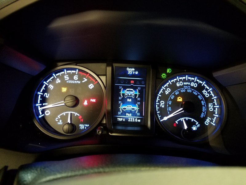

    Same issue just happened to me this morning. CEL and Trac Off. My Bluetooth wouldn't connect either, and an "Check Charging System" (the battery icon) popped up.

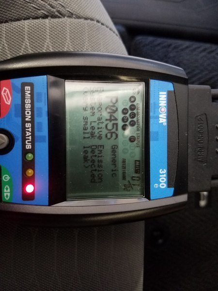

    The dealer said it was the charcoal filter. The fuel system needs to stay vacuum sealed so the fuel vapors are not released while the car is off. Apparently, the charcoal filter was the reason for a leak in the system. So they replaced the charcoal filter. It was a quick fix (took a little less than two days).
    I asked if this was common, the service manager stated it was a problem with all new Toyota models not just the Tacoma's. I am assuming the failure rate in these filters Toyota uses are not high enough to completely trash the stock they have, but sill a common problem.

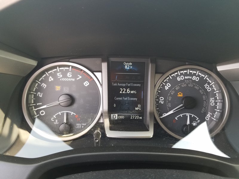

    2016 TRD Sport DCSB M/T. Just over 7000 miles. Same lights came on for me last night and I'm sitting at the service department right now waiting to hear the diagnosis. Didn't check what error codes were in. CEL is locked in and TRAC Off light comes on at a stop but goes out when I accelerate above ~15-20 mph. I did notice that if I turned the VSC off, the TRAC off light went out but the CEL stayed locked in.

    Well shit!
    Got home, pulled this code. Kind of jives with the other account of having the charcoal canister replaced.

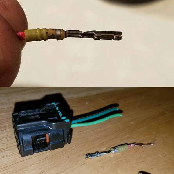

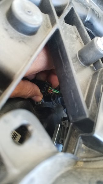

    Turns out a mouse had nibbled trough a wire under my intake plenum/manifold. Just one little red wire to cause all that nonsense. Toyota part numbers for the really small connectors/pins (1.5mm) are as follows: Connector 90980-12353 and the individual pins are 82998-25250.

    What are you showing us..??? :confused:

    I'm showing you what caused my check engine light/trac light to come on. I then gave you a solution to fix it, if the same situation were to happen to you, with part #'s even.

    That's all real nice, and thanx...Great advice man... but where is this connector.. that was what I was referring to..? It is not very clear in the pic. You said under the intake plenum...I assume that would be on the right side of the motor..? Sorry, did not mean to upset you, but I clearly do not know where this connector is located...
    Hopefully it won't matter to me anyway..! Just trying to understand..
    Peace Bro..! :thumbsup:
