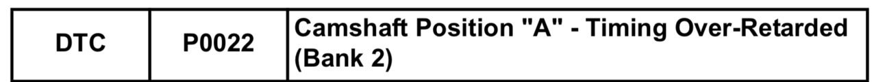

    2015 Tacoma V6 - Starts right up - runs smooth - I have a check engine light and a TRAC OFF light - no other lights. OBD says P0022 - Checked Oil - full and clean - Do I trust the OBD or is the addition of TRAC OFF light indicating a different problem?

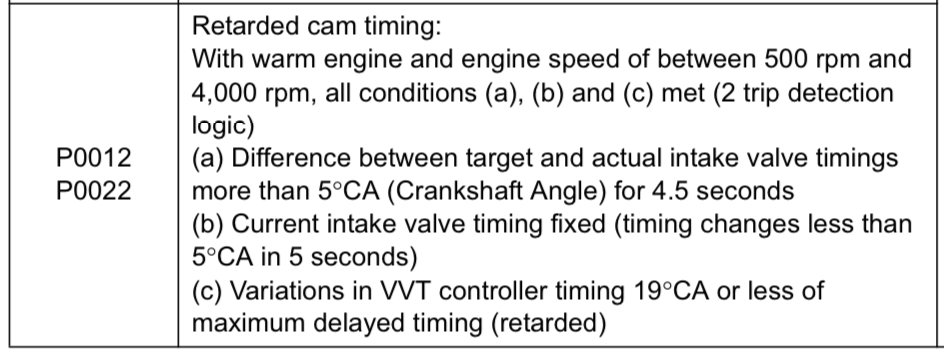

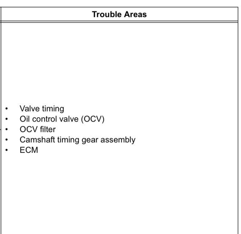

    P0022 is intake cam timing retarded. My first guess is that it relates to a VVT issue. Unfortunately, I don't have access to service info right now, nor the experience with the Trac system to say if they're related. I could see where the ECM might disable things like that if certain parameters were out of spec, but don't know for sure. Hopefully someone a little more knowledgeable will chime in.

    I'm pretty sure p0022 has to do with the VVT system but I can't look it up right now maybe @Jimmyh or @TnShooter can post the relevant information for you in the meantime.

    273B3022-E644-4284-8EE4-8E499E3DD967.jpg 84077AC0-5715-46BF-9D40-1891F4FD3788.jpg A5101CF1-5EBB-499E-A23A-5E79293FBCBB.jpg
