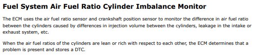

    this is how ECU monitors and reports the imbalance.
    Start with obvious items: intake for vacuum leaks, spark plugs, port injector&direct injector for that cylinder. AFR sensor is the last on the list. Do you have any other codes?
