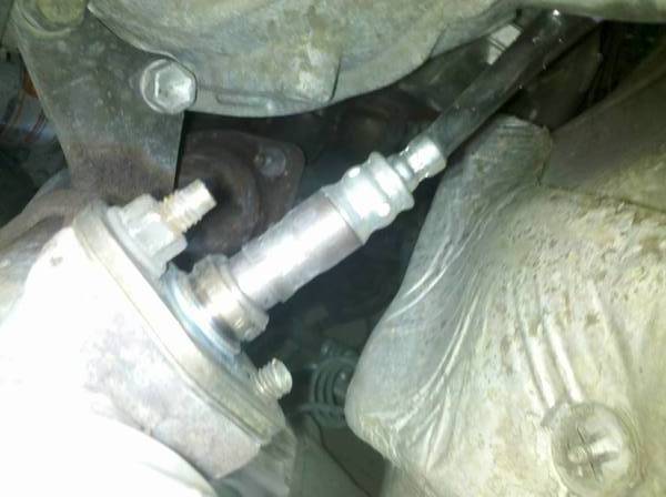

    Replace the sensor last night. Quick and easy. Got it for $169 w tax from the Toyota dealership. I didn't take any pics though, sorry. The sensor was located in front of the cat headed toward the engine side of the exhaust. All you do is take off the 2 bolts holding it in place and disconnect the plug side. Then reverse to install the new one. Very, very easy. I drove my truck up on some ramps and did it in the drive way. :D Just be careful not to torque the bolts, my Dad felt the need to man handle one of the nuts and it snapped the bolt in half. Now I'm riding like this.:eek:
    Remeber to have some spare bolts & nuts!
